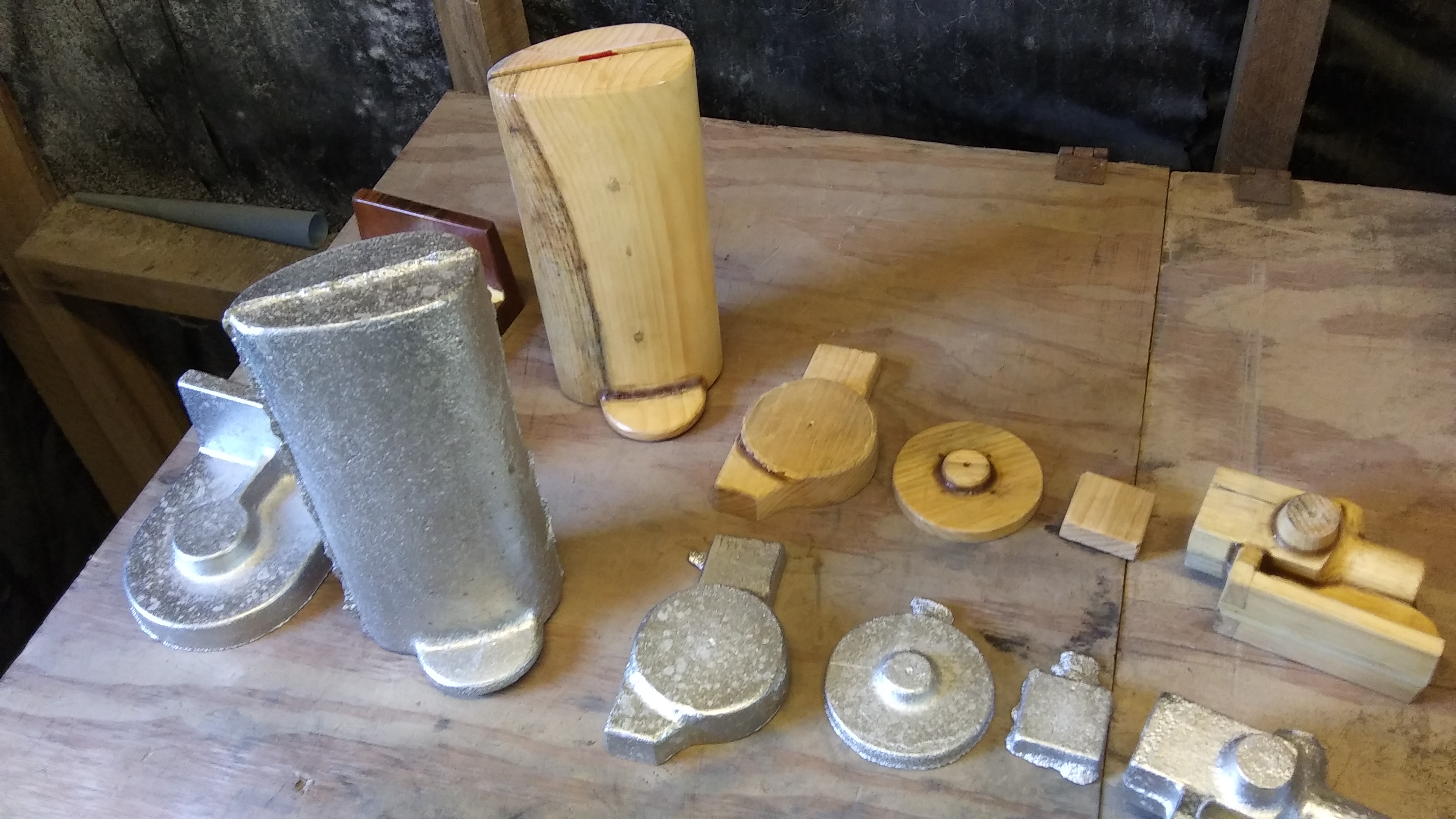

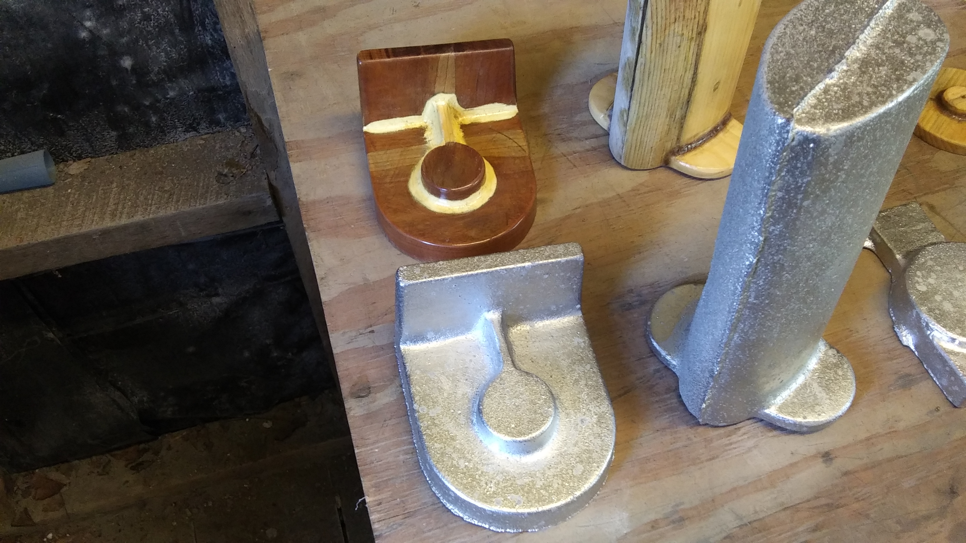

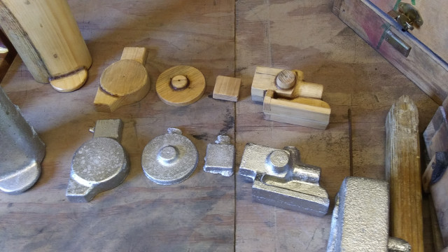

A few weeks ago, I actually managed to get out and do some castings, which I made up the patterns for a bending iron, for bending wood sides on acoustic guitars and just bending wood in general without needing to steam it, a matchplate vibrator and knee valve from steve chastain's books, oil filter adapter, and a few blocks that will be machined up and turned into air manifold blocks for plumbing compressed air around the new casting shed. I also made up a pneumatic sand rammer too, so need to upgrade all of the compressed air stuff in the shed too, so I can use all of it.

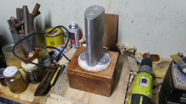

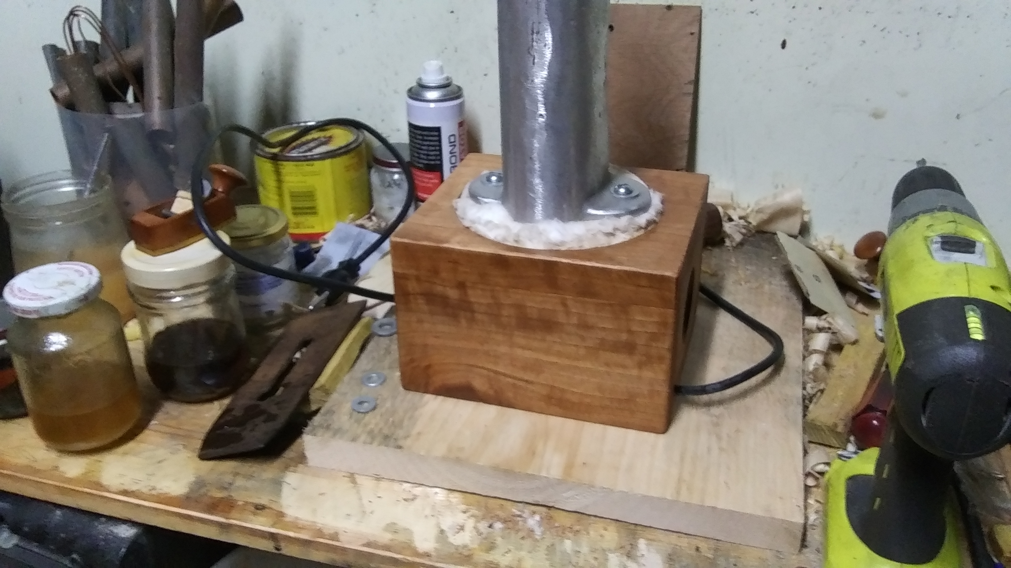

I already machined up the bending iron, which really wasnt much of machining really, just drilling a few holes on the drill press and cleaning it up with a flap wheel on the angle grinder, then pressing the two 200w cartridge heaters in it and make the base for it. The base is made of curly cherry, and the white part is a 3/4" disk of ceramic wool that I recessed into a pocket in the top, and then stabilized it with some watered down sodium silicate to act as a thermal barrier between the bending iron and wood. It's just propped off of the base by some bolts, washers, and nuts to act as standoffs.
