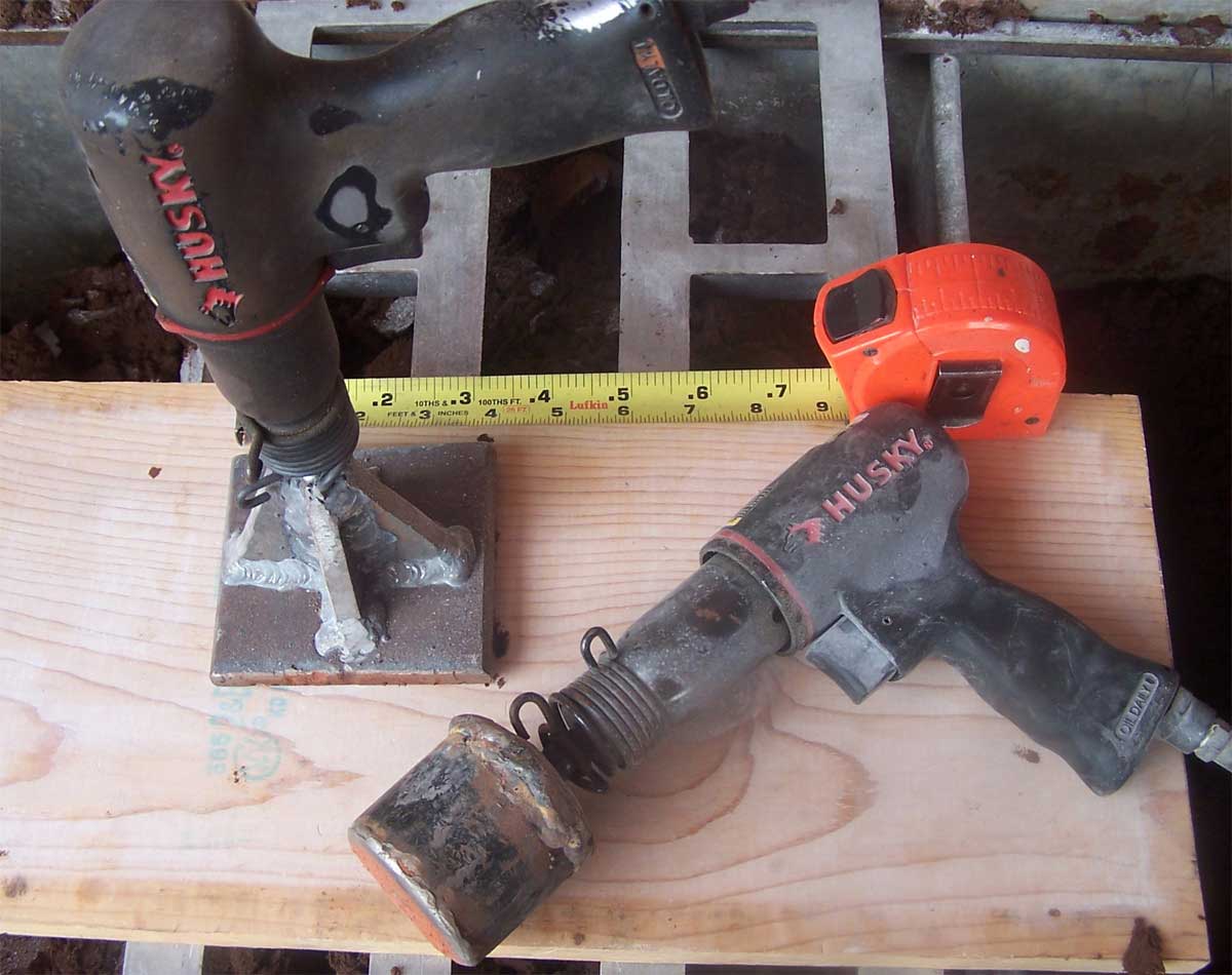

Air Rammer
Using as air chisel from Home Depot I welded up a butt onto one of the chisels. I have since made a larger butt using a square piece of heavy plate that I prefer over this one.
Re: Air Rammer
Here is another shot with the other rammer too. The square one is what I usually use as the round one wants to pack more than I need and of course being smaller takes a lot more time to go over a mold.
