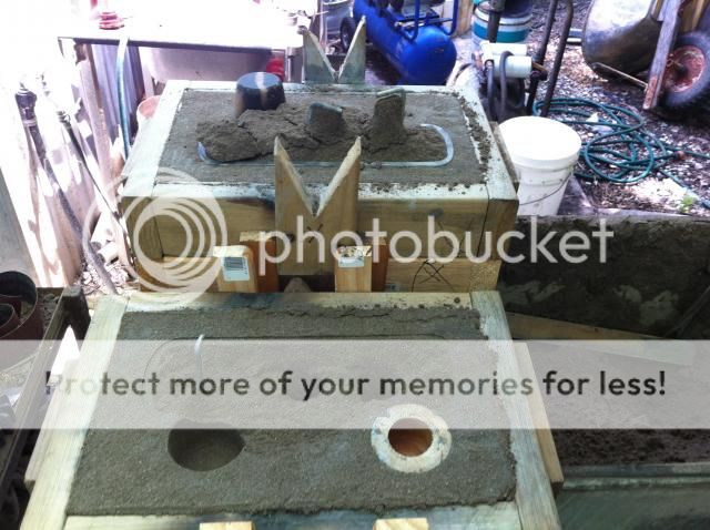

I also brought this cover from a mini to have a try on some thing a bit smaller, , the mini cover fits one of my existing flasks so I'll try this first before I make larger flasks. When the cover arrived it looks like it was die cast so I may have a few issiues getting it out of the sand as the sides are damn near parallel
below is the result, this happened five times, I put the metal hooks in for my last try,I also rubbed the inside with graphite, I'll have another play today
Re: Alloy rocker cover
Had another three goes today and no success, when I give the cover a slight tap the sand does fall out. I do have some sodium silicate so next week when I come off shift may give a SS core a try, at the moment this is problem solving exercise before trying to make the six cylinder one that I have.... I'll be on Christmas break from Monday next week so hopefully over Christmas I may get a bit more done
are the holes plugged in the cover, if so you may try drilling vent holes in them and using low pressure air to lift the cover off the sand. my big pulley pattern with the deep pockets I had hell with till I put in three very small vent holes which allowed the cover to break the suction between the pattern and the sand.
I would also plug the oil filler hole and use a core up to the top of the filler neck then with a big open vent to the open air.
You've probably already done this but one or two coats of some paint that will leave a really slick finish will also help.
Your sand structure looks excessively grainy. I see massive amounts of light colored bits in it. What is that? What is your sand mix composed of? Further, those three hooks won't serve to keep that sand mass intact with the upper half of that mold. The hooks are too thick, and, what you do utilize for rebar reinforcement needs to be thin and attached to a structural support within the upper half of that mold frame. I'll see about finding you an example pic, if not, I'll sketch you what I'm talking about.
