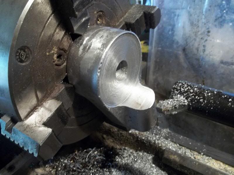

here's a shot of the part that I casted yesterday in the lathe getting some work done to it.

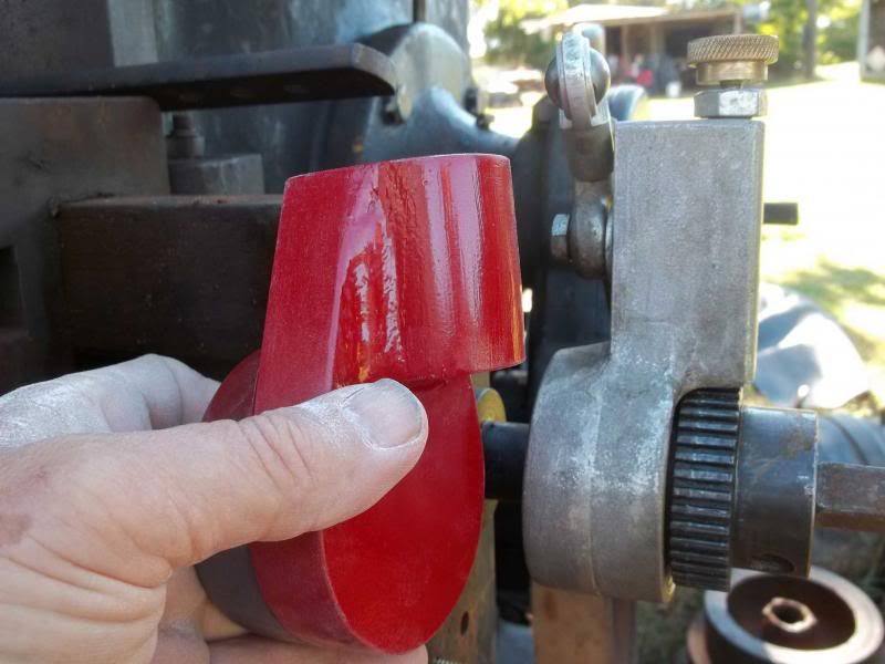

the new pattern
the part
this design/version will allow me to put in a larger pawl pin and also fix it so that everything can be taken out without having to take it off the shaft to clean and lube it.
its also shorter which will allow smaller steps on the table movement
For not liking to make patterns, you are sure making a lot of patterns. :)

Jammer I really don't like working with wood, that outlook would probably change if I had wood working tools, which I have very few of. But the problem with this shaper is that I don't have broken parts that I can cope down around so I have to make the patterns, I should say that of all the parts that I have made there were only two that I could of used the original part to make replacements with, and they would of been hard to work with. Plus if I ever get to the point of actually making a steam engine in the size I want to make one, I'll have to make the patterns, and besides I would whole lot rather mess up some wood then to mess up a pot of cast iron which I have messed up a lot of that lately it seems.
I also like the looks of the new ratchet casting a lot better then the second one I made. as far as I can tell it resembles the original closer, still wish I could find a photo or pattern drawing of it.
and most of the patterns that I make are really pretty simple.

the part
in the lathe being cleaned up some
all cleaned up and no place to call home,

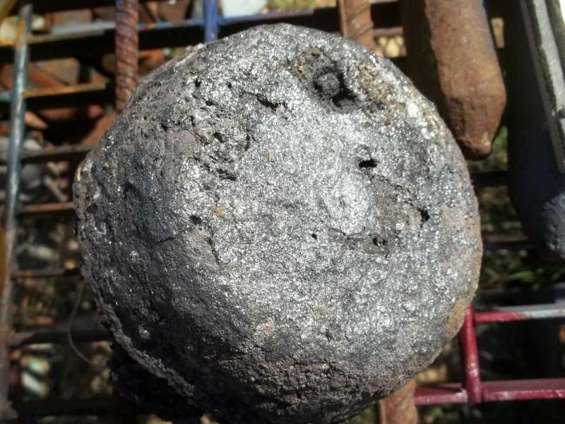

The hunk of crap that I dumped out of it had what I though was a layer of the crucible on it, but after reexamining it I think its a heavy layer of graphite which the only place it could of come from is the metal that was in the crucible as I didn't add anything to that melt. Will post a photo later of the crap. thinking about remelting it.

Jammer whats your thoughts on adding graphite to the melt just before pouring, I've been reading the principles of metal casting but it deals with melts in the thousands of pounds not in one or two pounds.

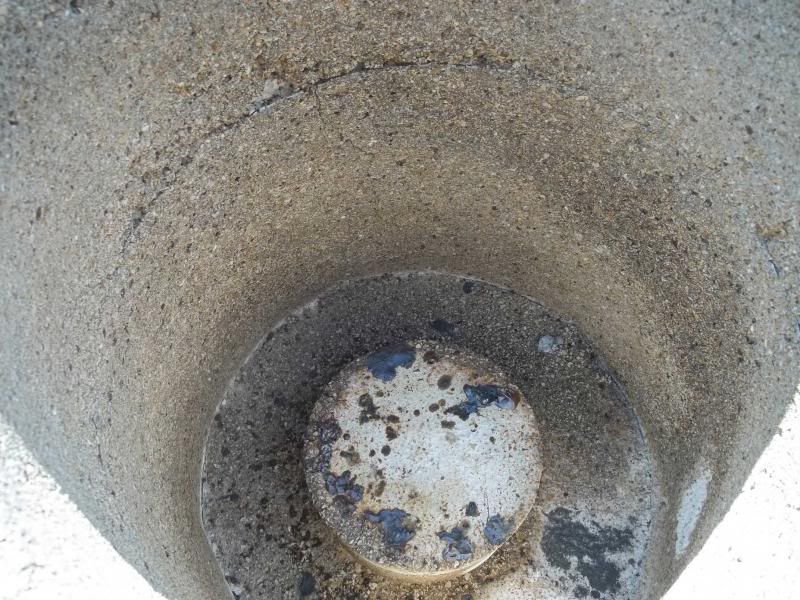

The new lining helped tons with the melt yesterday after I got the burner straightened out again. the refractory that I put in is holding up pretty good so far (will take a photo and post it later), I had a fuel strainer for a lawn mower in the line and it just wasn't letting enough fuel thru. I don't know what fuel consumption is as I keep forgetting to take a scale out there with me to weigh the tank with.

here's some photos for you guys to look at, comment on and just plain make fun of.
first up is the inside of the furnace after it fired it yesterday, it has some stress cracks but otherwise in fine shape

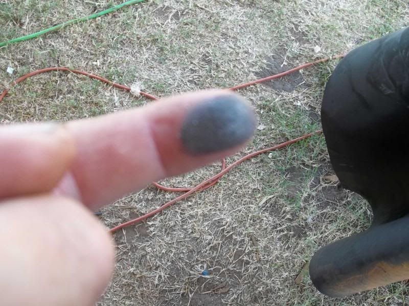

second is the clump of crap that i dumped out of the crucible yesterday before starting, black shiny stuff rubs off in next photo
sorry bad out of focus photo, stuff has an oily feel to it like gaphite.

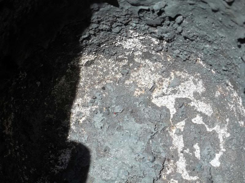

inside of the crucible I have no idea what the white stuff is, I've seen it a couple of times after having problems with a melt
