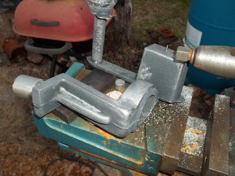

Added about 3 oz of copper and 1 oz of silicon to the melt which was in and A10 about half full, throwed in a nicast welding rod but it didn't melt so next time it gets put in the bottom of the pot first off.
Tried one of the chunks from the ingot tray with a file it cut nice so stuck it in the mill and took a couple of passes it had some hard edges but they were really thin.

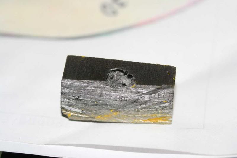

Here's the photos of the part
did some work on the part in the above post, found what looks to be a slag inclusion hiding in the part of the ring where the gate was at, was able to cut the part out with a hacksaw for a photographic session here's the results
Is that slag or sand or what, it looks a little strange?
I don't know what to think about the Nickel not melting, may need to have a nickel/Iron alloy. :?:
