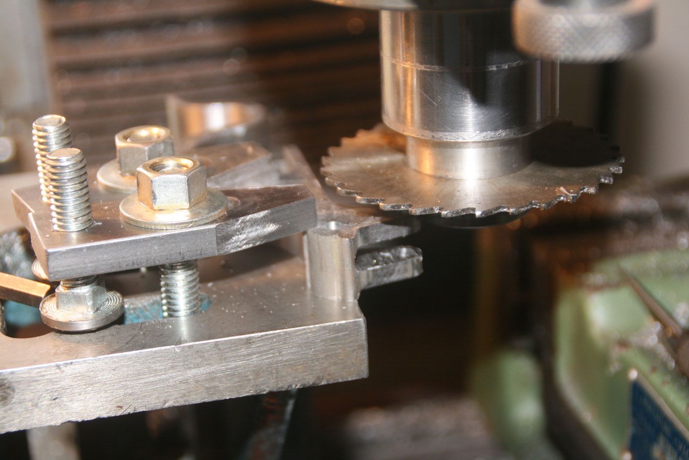

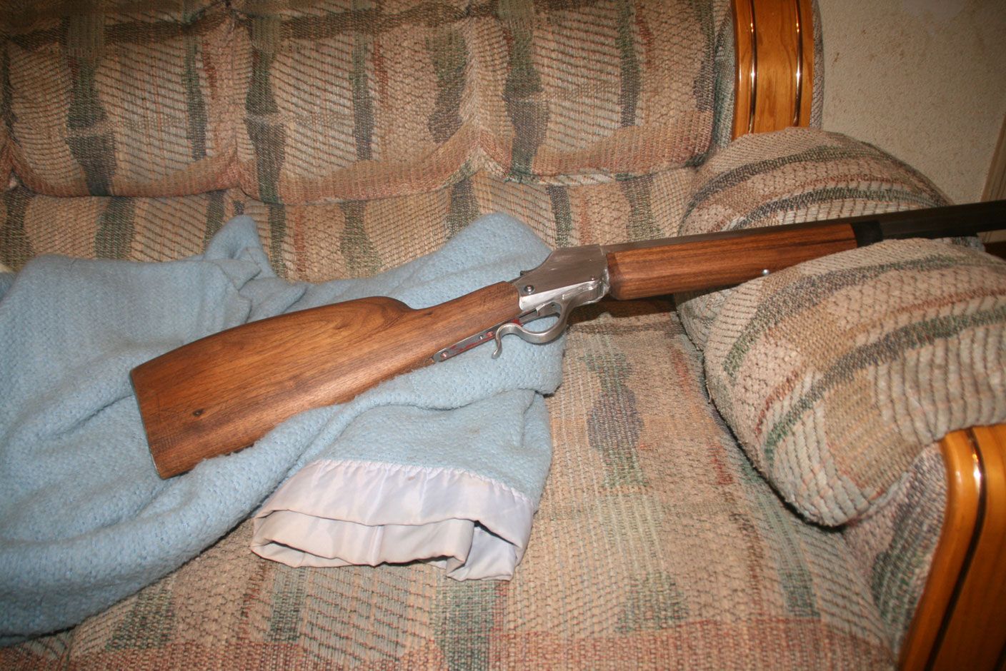

remade a part today, I wasn't real happy with the first one I made. Also been working on the wood have the forearm slimmed down considerable now. plus I cut the butt stock off and inch yesterday and reset it in the tangs of the receiver so now I can drill the stock for the tang screws.
added a little finish to the wood

Speaking from an aesthetic view, that hump in the top of the stock bothers my eye. The rest of the gun is absolutely gorgeous. Here is what my Marlin 1888 looked like:
I always thought those old Marlins had the most beautiful stocks anywhere.
Rasper wrote:Dave,
that was put there for a reason and will slowly as time goes by be cut off, but if I had of made the stock straight on top then had (and may still have ) of moved the butt plate forward from where its at the stock would of been too narrow to fit the plate, As it is now I can cut up to about 3 inches off the stock from the shoulder end and the butt plate will still fit.

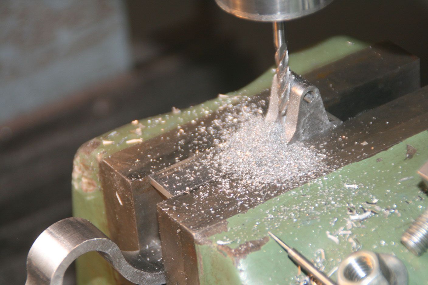

ok, I', still working on the gopher special just laid the sandpaper down for a little bit to work on some other things like the rear sight.
I got the leadscrew made which will run the sight apeature up and down the leaf. so here's a couple of photos of it.
the end of it had to be cross drilled. The hole is .045 in diameter, the rod is .093 so not a lot of room to make a mess with it.
and I worked on the hammer and mainspring some today heres a shot of the internals
had to take the hammer out and have the end of it build up which I had to file most of what had been added back off, amazing what you have to do to get one of these to run.
