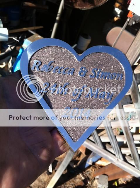

Tried Jammers Pattern in aluminum today just to see how it molds up and pours. I used a bit too much mold wash
the wash has changed the lettering, so tomorrow when I try bronze,only one spray of wash

Today I did a bronze casting using Jerry's pattern and the casting has what I call shadowing,( were the pattern moves when your ramming it up) but it is a better casting then before. I've glued the pattern to a board, then I'll screw it to the drag once the glue has set and that should takeaway any movement

Looks good Mike. Is the shadow caused by the pattern moving or the sand being pushed out from the center? If the pattern moved, wouldn't the shadow be on the same side of all the letters?

Not to sure what you mean by the sand being pushed out from the center Jerry. I was putting it all down to my ramming, but I sure could be wrong.Jammer wrote:Looks good Mike. Is the shadow caused by the pattern moving or the sand being pushed out from the center? If the pattern moved, wouldn't the shadow be on the same side of all the letters?

Mike, I was just noticing that the shadows were above the letters on the top row and below the letters on the bottom row. The center isn't showing much of a shadow in the picture. I just thought if you rammed in the center it may cause the voids on the outside edges. If that makes any sense.

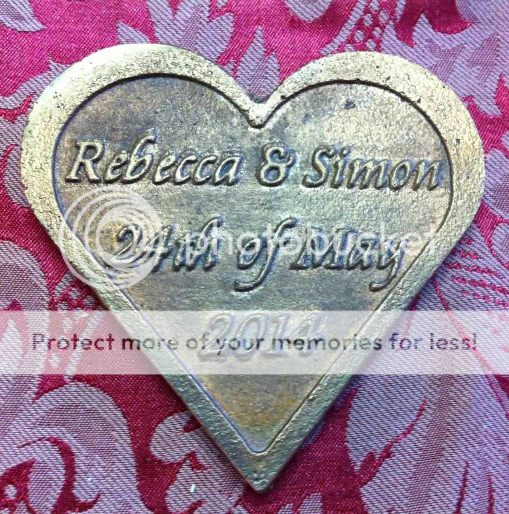

Tried another casting, definitely getting better, will be doing another one next week.I used this one to to try polishing the raised areas, I placed wet and dry sand paper on a piece of 12mm aluminum plate. I first used the linisher I won't next time, I then started with 600 grit wet and dry and then with 800 grit, then to the polishing wheel, first with a stitched wheel and finish with a fine buffing wheel
Re: Coaster Project
That's gorgeous.
