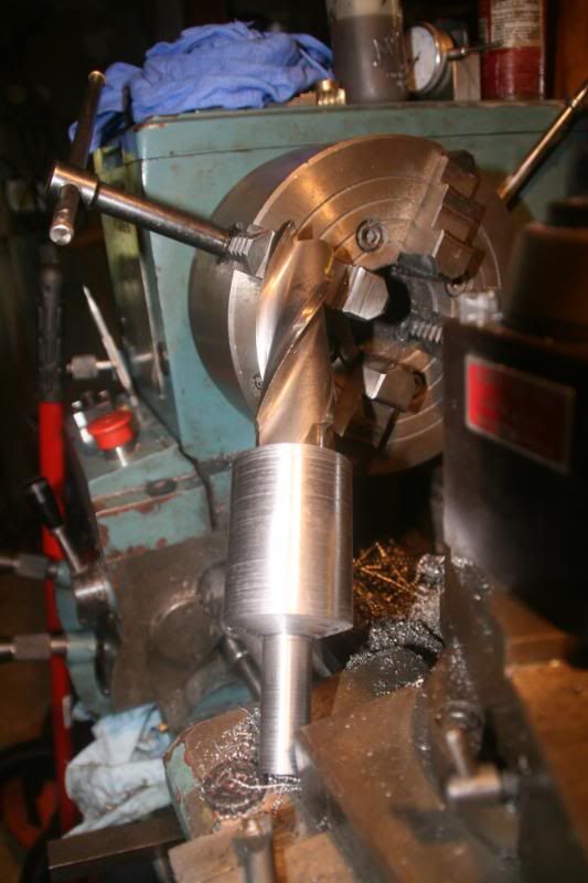

Ok as promised here is some photos of one the Adapter I made for a 1.5 inch end mill cutter, nothing fancy a hunk of 4140 turned down and bored out.

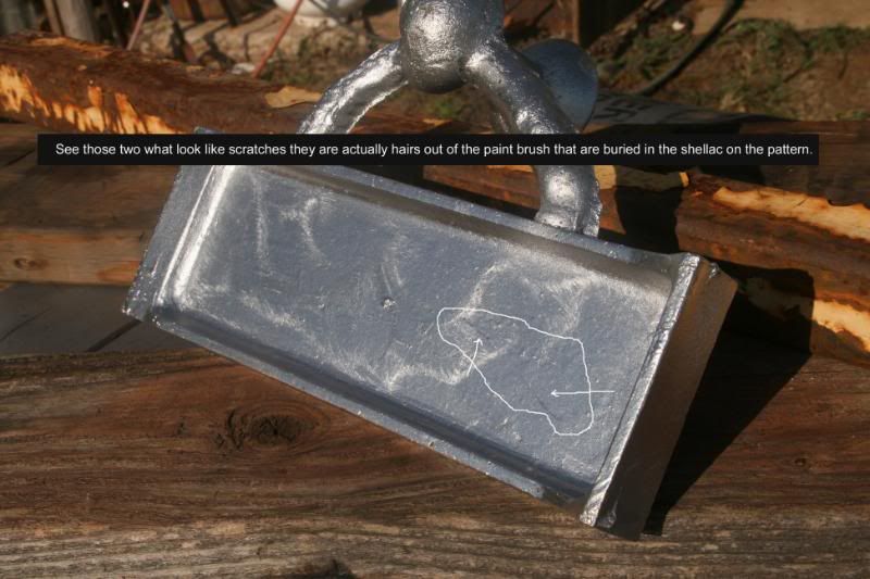

And the latest flask side.
I picked a photo of the flask side that has some defects in it, namely pain brush hairs on the varnish from when I shellaced the the pattern. I chose this photo to show the surface texture that I am getting with the sand that I have been using which was mixed up from some Cheap Play Sand, this sand has gravel in it up to the size of a 1/4 inch, not a lot of it but its there, I added about half a bag of fine silica sand to the mix, this was added not as a filler but more to use up some sand that was in a bucket from a bag that had gotten wet back in June and would not it seem dry out. so in the muller it went a little at a time.

That flask side came out real good
I would have thought that that hair would have burned out, must have been a good brush.
The only thing that I can see wrong is the chuck key that you left in the chuck
I was told that if a chuck key was left is a chuck I would be banned from using the lathe ( this was way back when I was at school ) I told a friend the same thing the other day so you are not the only one.

I can make all kinds of Excuses for it, but I was in a hurry to take the picture of the adapter, I lucked out on that little project in that I only had to make one of them, I got two 1.5 inch end mills off of Evil Bay, but then didn't have a way too use them. I got the fit on that adapter and the cutter so that you can hear it sucking air when pulling it apart. I still have to put in a couple of set screws to hold the cutter in place.
I was pointing out that hairs, or what look like hairs in the casting. They are hairs, but they are in the shellac on the pattern. what is amazing about it is that the sand that I am using is a bag of play box sand that I got at the lumberyard and it has gravel in it that is up to a quarter of an inch in diameter, not much but its there. The stuff rams up nice and tight without leaving a sand textured finish on the surfaces of the part. I've got one or two more parts to make off of the flask patten then I am going to cut an inch wide strip out of the middle so it will only be two inches wide then make a flask that is 4 inches tall with stacked together. But I want to make them so that they will mate with the the ones I already have.
