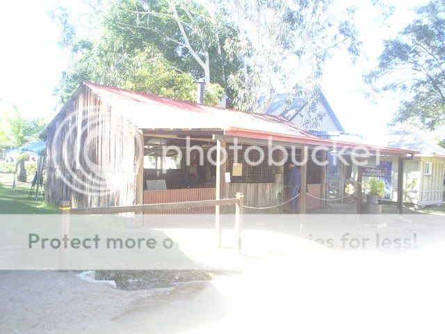

yea mate I know but that is easer said then done, what would be good would be my daughter and her husband let me build a shed on their 68 acre property, every time I suggest a shed such as the one in the photo they both laugh at me
The photo is of the local historical village blacksmiths shop where I sometimes go for a bit of relaxing hammer work

Sounds like a case of elder abuse.

Maybe you just need to start leveling a spot to let them know your are serious

Yea, just do it
After all they will be getting a building once you have finished with it. It may be in 30 or 40 years or so but you don't need to tell them that
