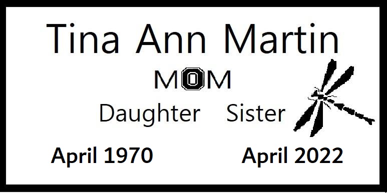

I'm going to make a small plaque for her grave marker. Not really a commission work since I won't take any payment for it. I made up a pattern on the computer and have put it on the F-engrave program to make a g-code for the CNC. It's too big for the 3D printer and I have gotten pretty good at cutting plaques on the CNC. I'm going to try some hard wax and I think I can ram it up in petro bond. We'll see how it goes.
The O in Mom is the block O for Ohio State. She was a big fan. I would have done it differently but it's what they wanted. I may do up another option and see if they like it better.

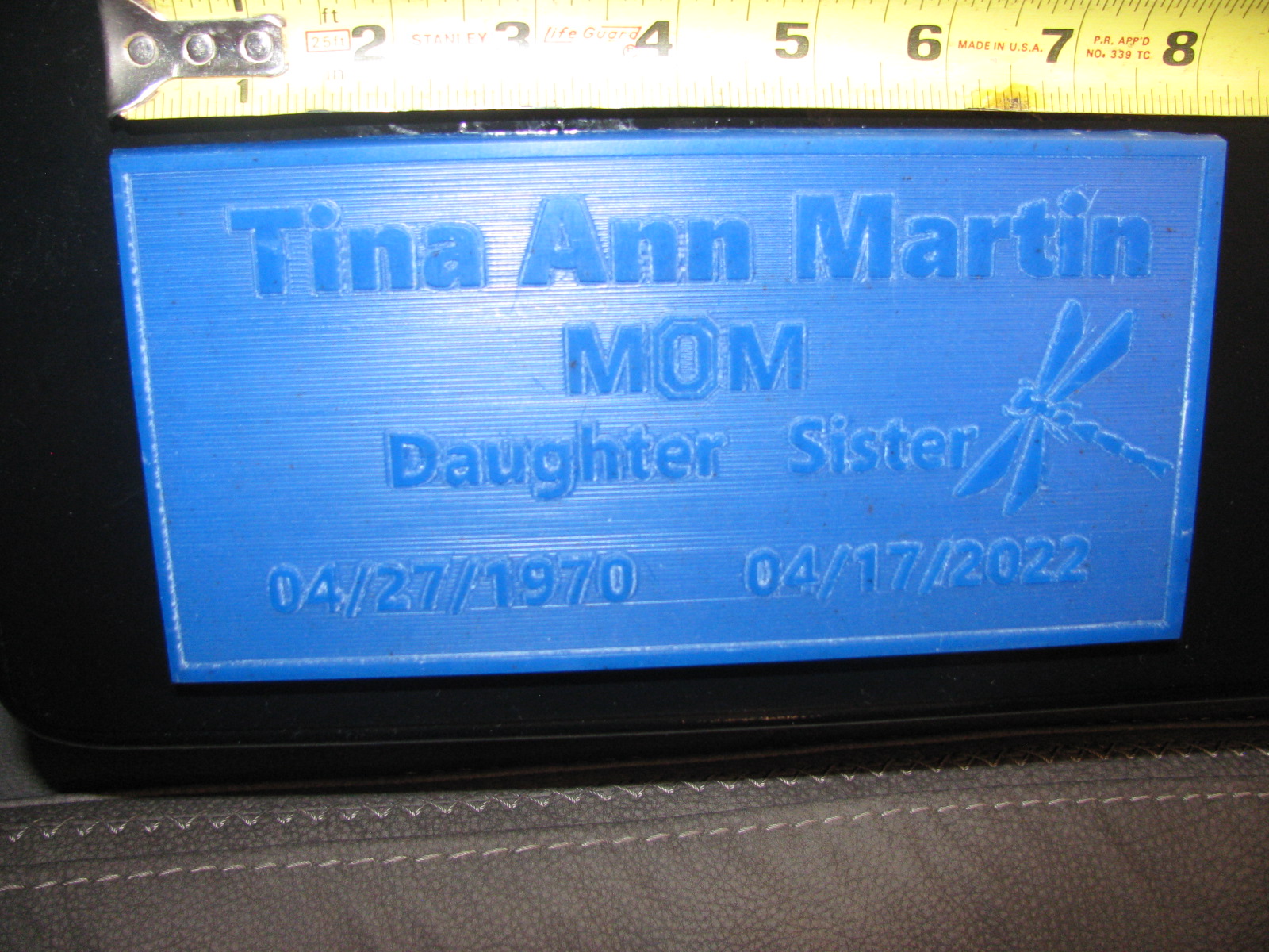

It's the blue machine wax. it cuts great and is pretty hard stuff.

Here's what I got today. It's the blue wax. Next is the Bronze. Have to pick a day with no rain.
