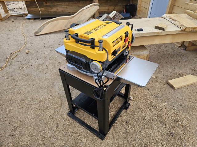

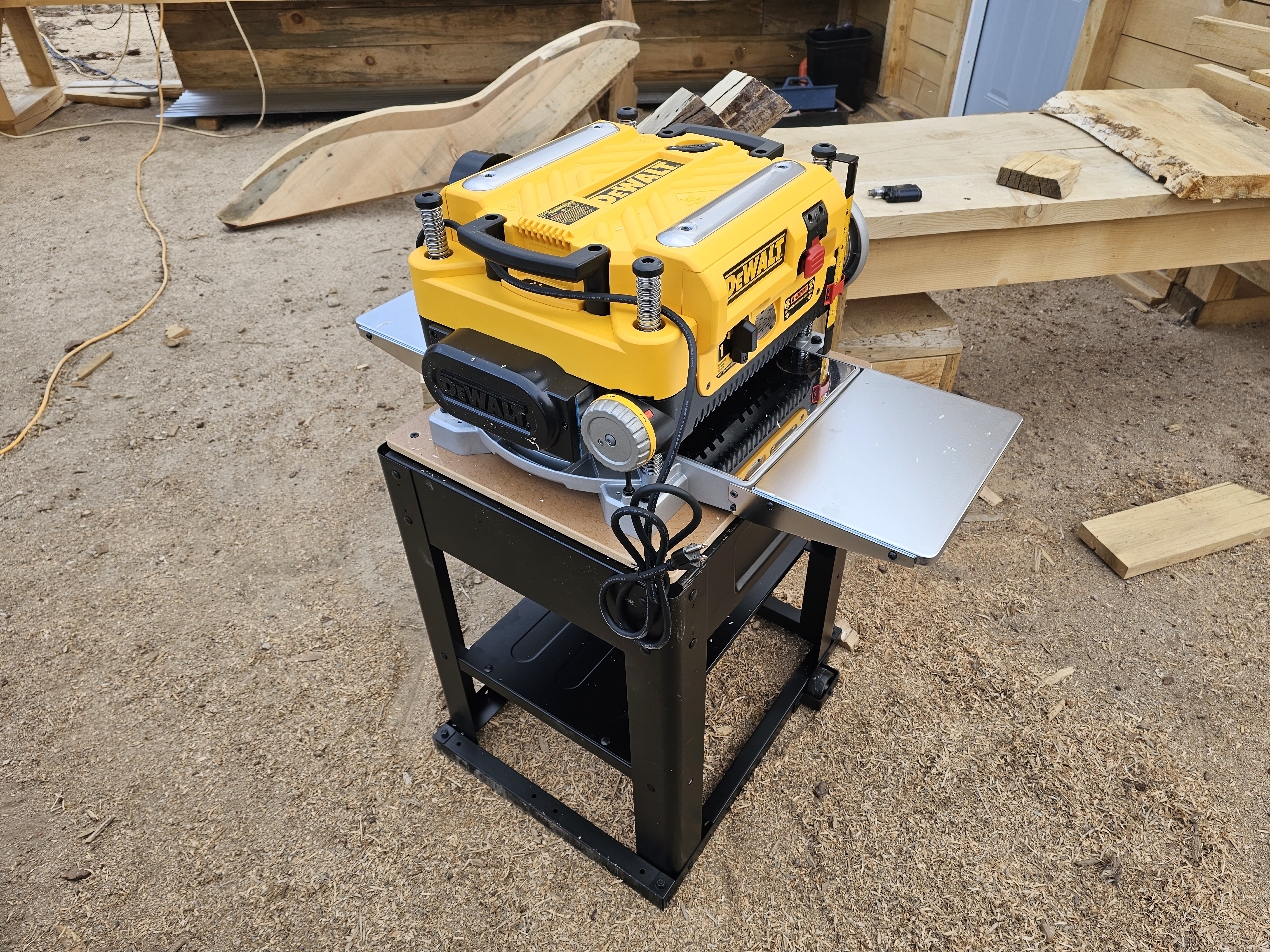

Got this put together today. Its just a 13". Eventually I would like to get a much larger but this is going to step up quality and speed on the things I am making now.
Re: New toy in the woodlot
In the background is the profile of a leg for a lounge I am working on.
Also got a 3 1/2" battery handheld planer.
Next big tool on the wish list is a large bandsaw for cutting those profiles for benches and lounges. The way I am doing it now just takes so long so I keep investing in upping the quality and increasing the output.
There is a 3rd party that makes a replacement drum for these surface planers that use 60 indexable cutters mounted in a helical pattern. They are about $400 but there is a lot of upsides like carbide inserts, 4 cutting sides, less contact on the surface at any given instant and if you get a chip in a blade its just in the line of that one spot so no need to replace the entire 13" long blades.

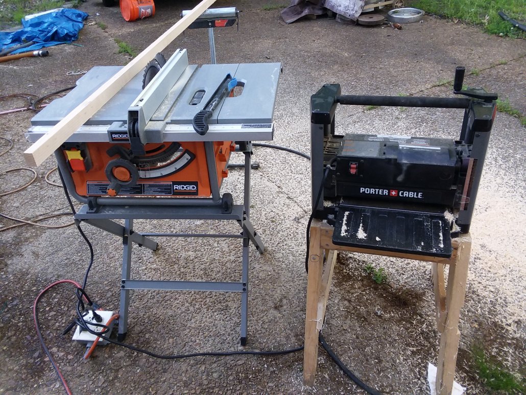

I have a brother who is heavily invested in commercial woodworking equipment (he use to work at a woodworking machinery supply house, and so could get equipment at near wholesale costs).
He had a larger heavier planer that I used for a while, but it was really a monster.
I asked him about small planers, and he said they will do a good job, and will do a better job with very thin cuts than many of the larger and older planers.
I bought a Porter-Cable, and I like it a lot.
It is very accurate.
I did nick a blade, I think on a staple that was in a piece of wood.
The blade sets as I recall were very reasonable.
Those blades are razor sharp, and are just like handling new razor blades.
The can cut you if you just look at them.

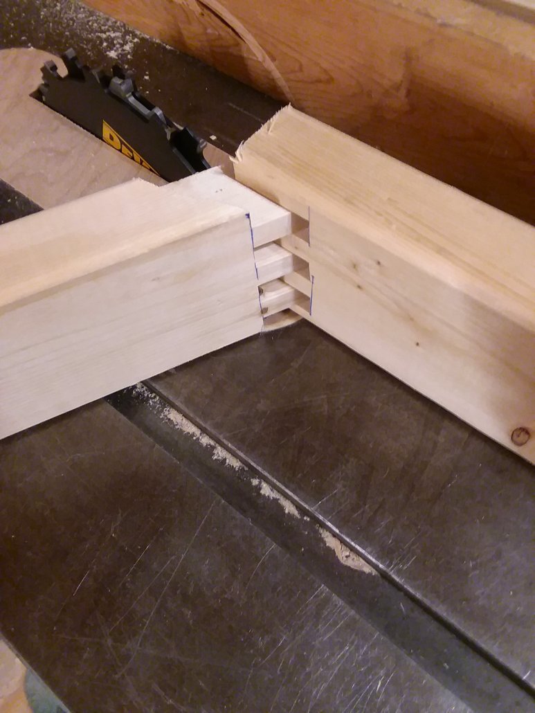

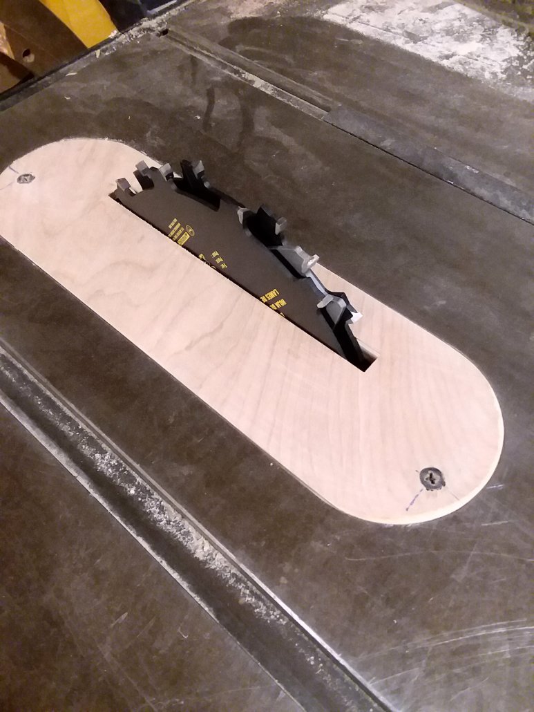

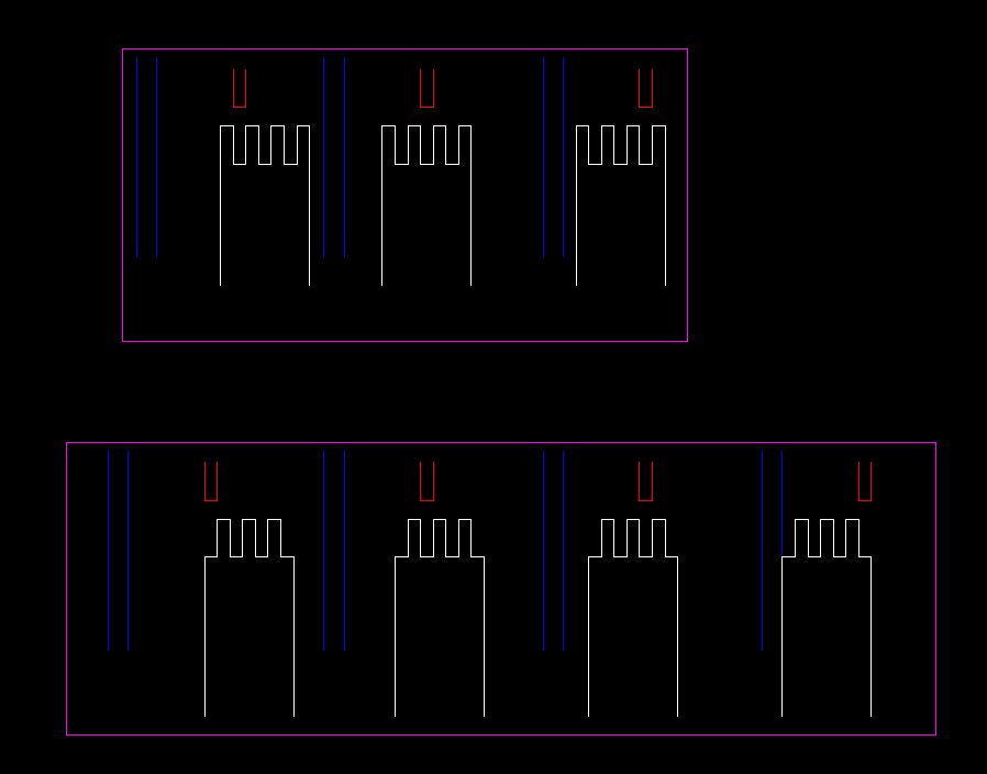

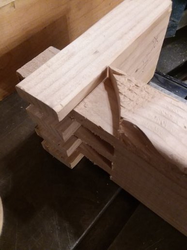

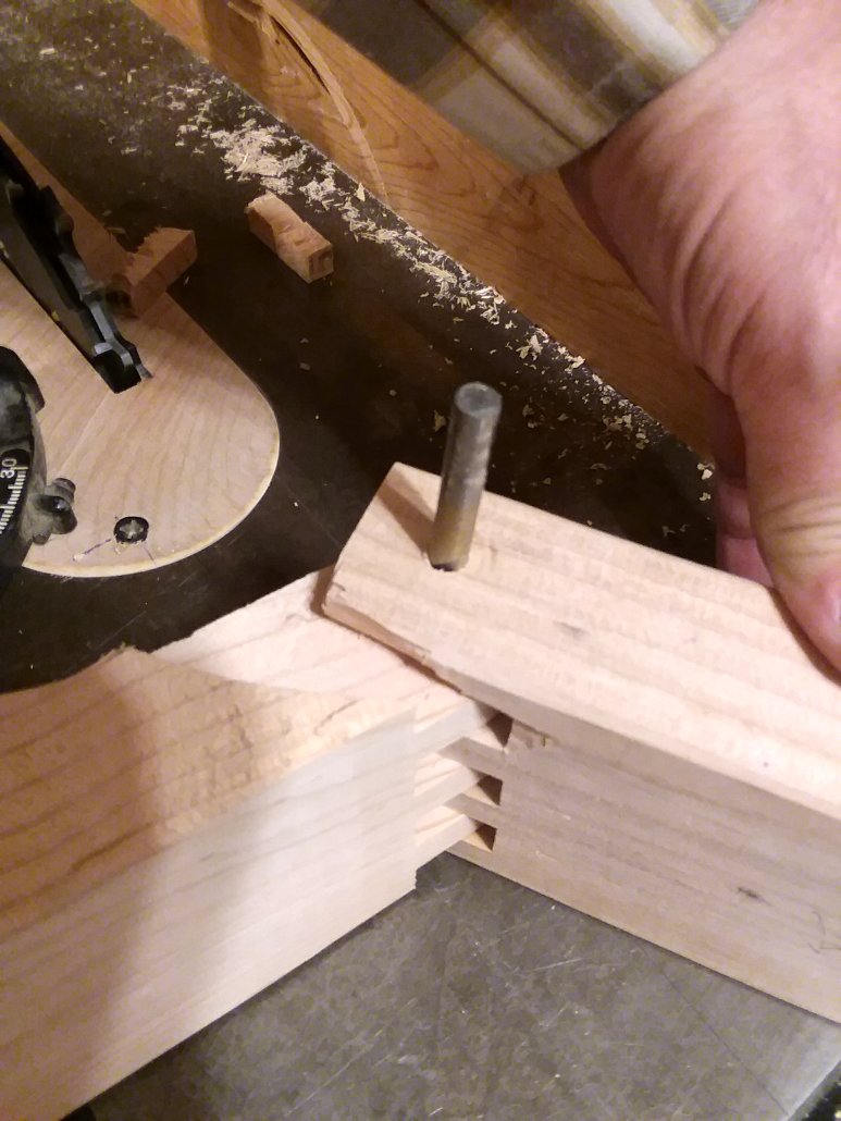

I bought a Rigid table saw also, and it works well for making wood snap flask sides.
Posts: 57

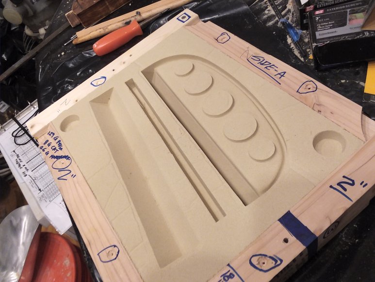

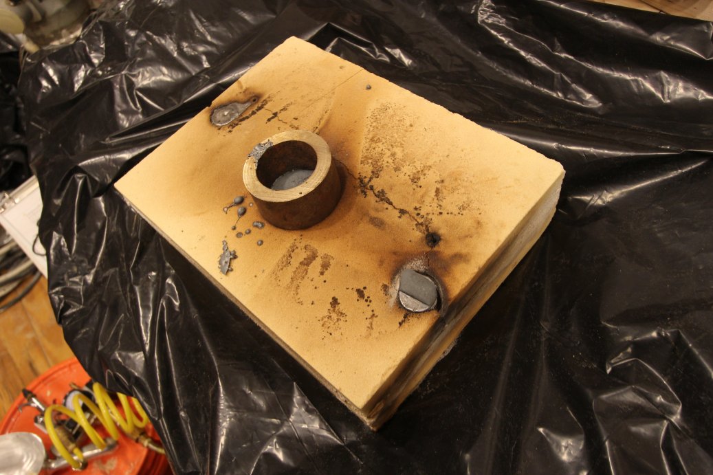

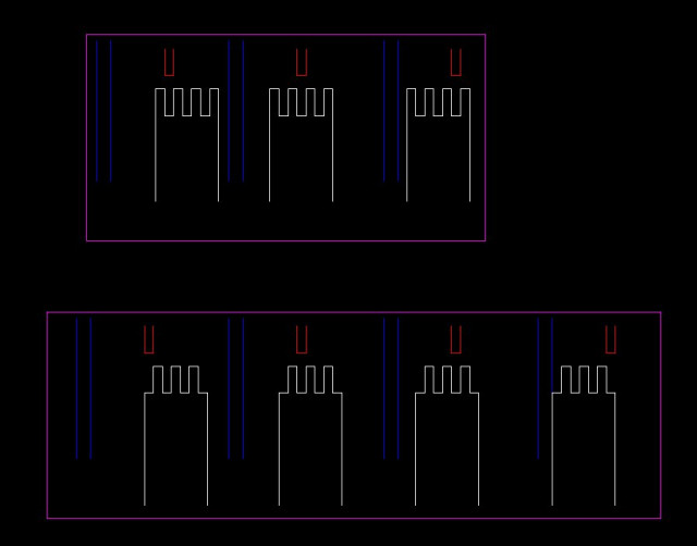

I use resin-bound sand, and so my flasks are often very thin custom units.
The cope and drag are only as thick as is necessary to prevent burn-through, and often the cope and drag are different thicknesses.
The resin bound sand is removed from the flask prior to pouring, with the cope and drag glued together with foundry adhesive, and then weighted on top.
I can reuse the wood flasks indefinitely, since they don't get burned during the pour.
Posts: 57

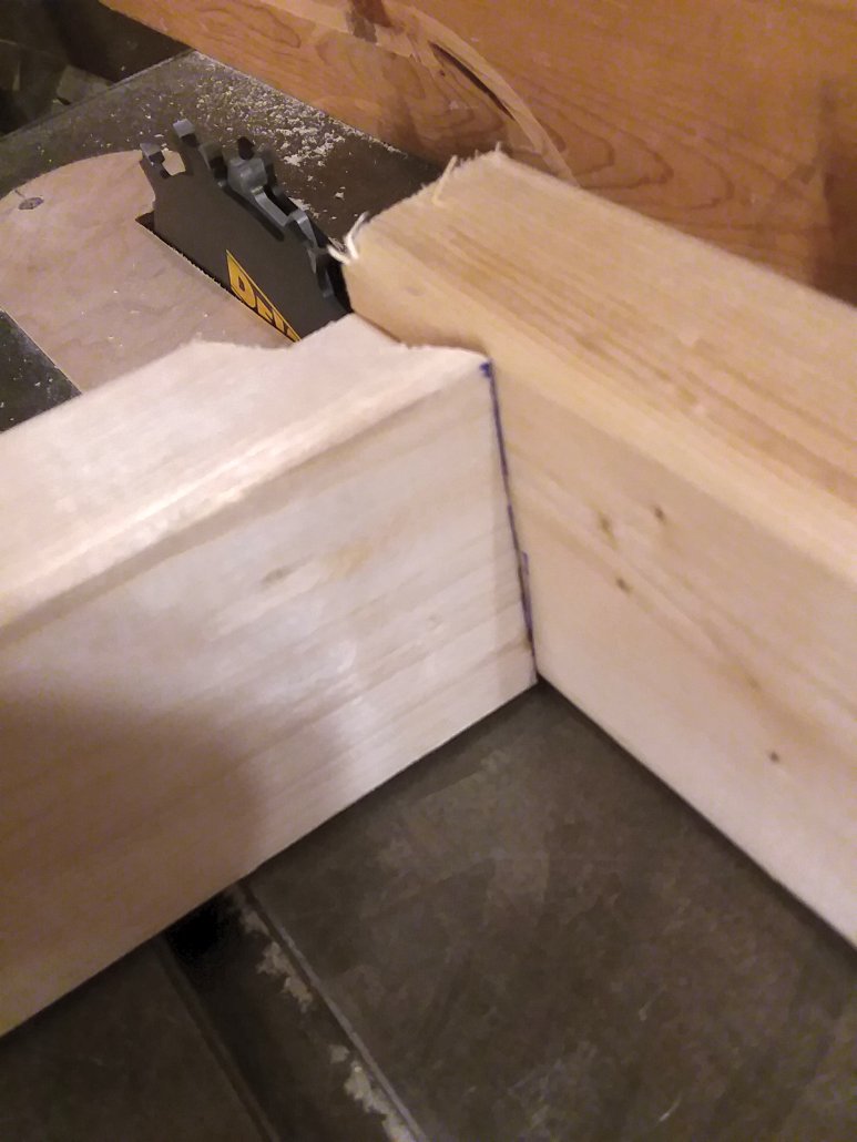

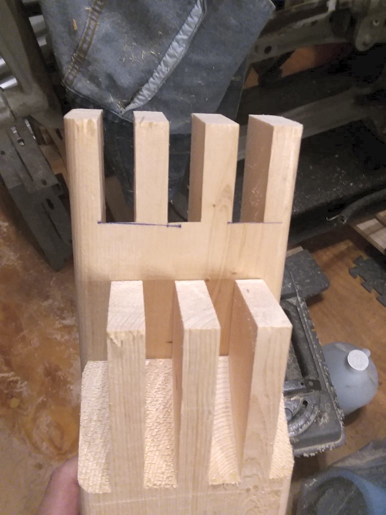

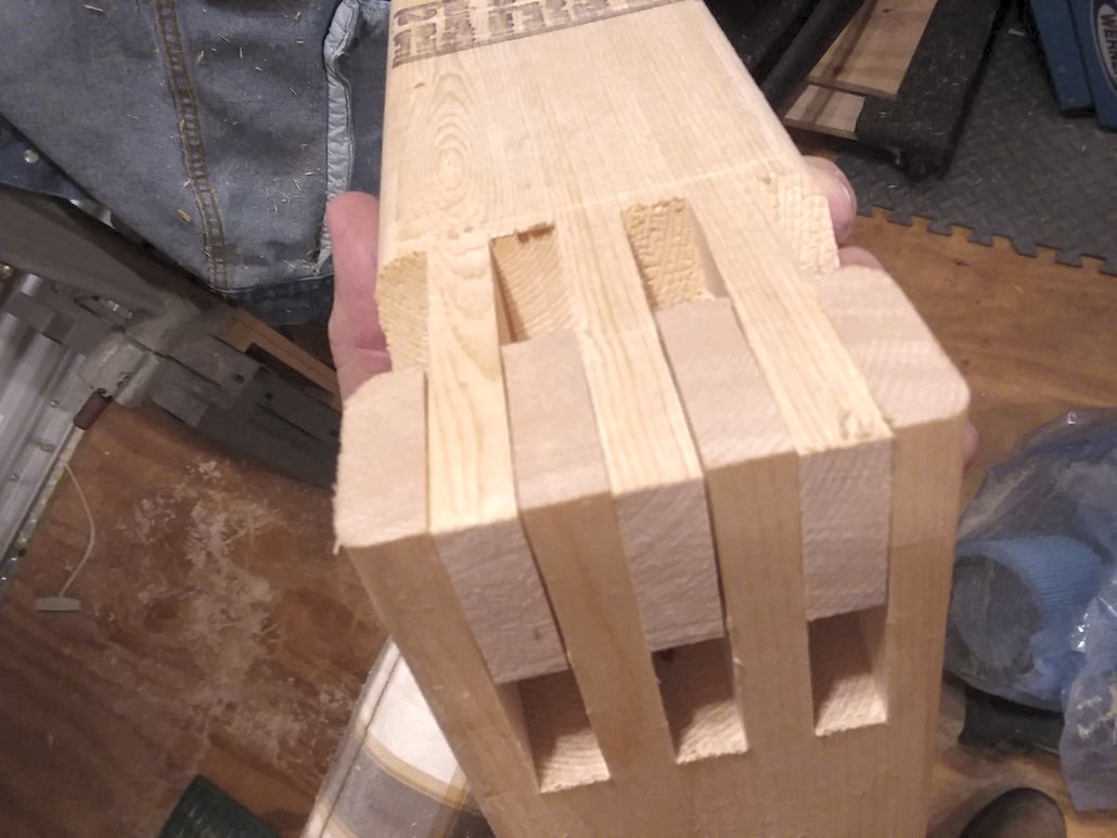

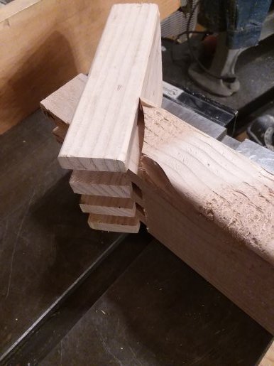

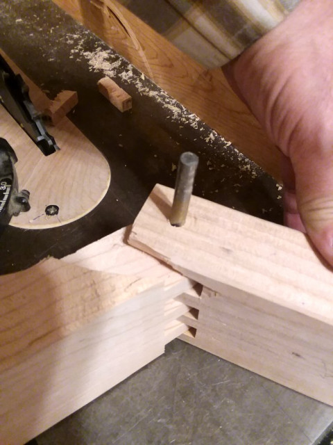

The joint on the inside closes when the flask closes, and thus I can make round cuts with the dado blade.

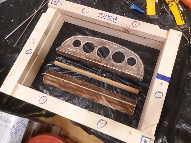

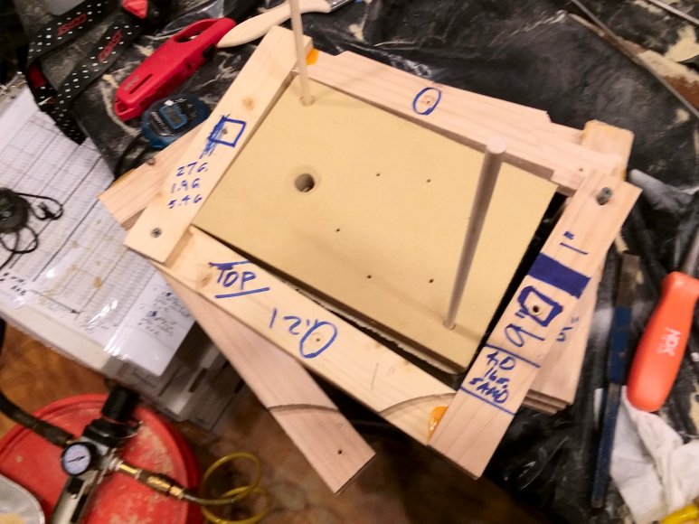

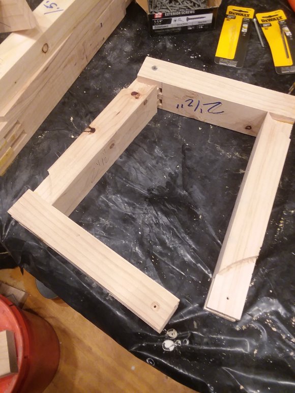

Here is a flask I made for the Chirp man.
Patterns made by Chirpman.

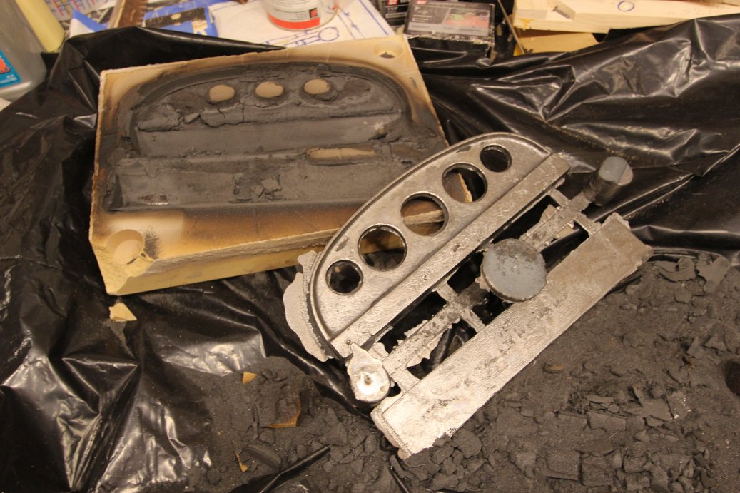

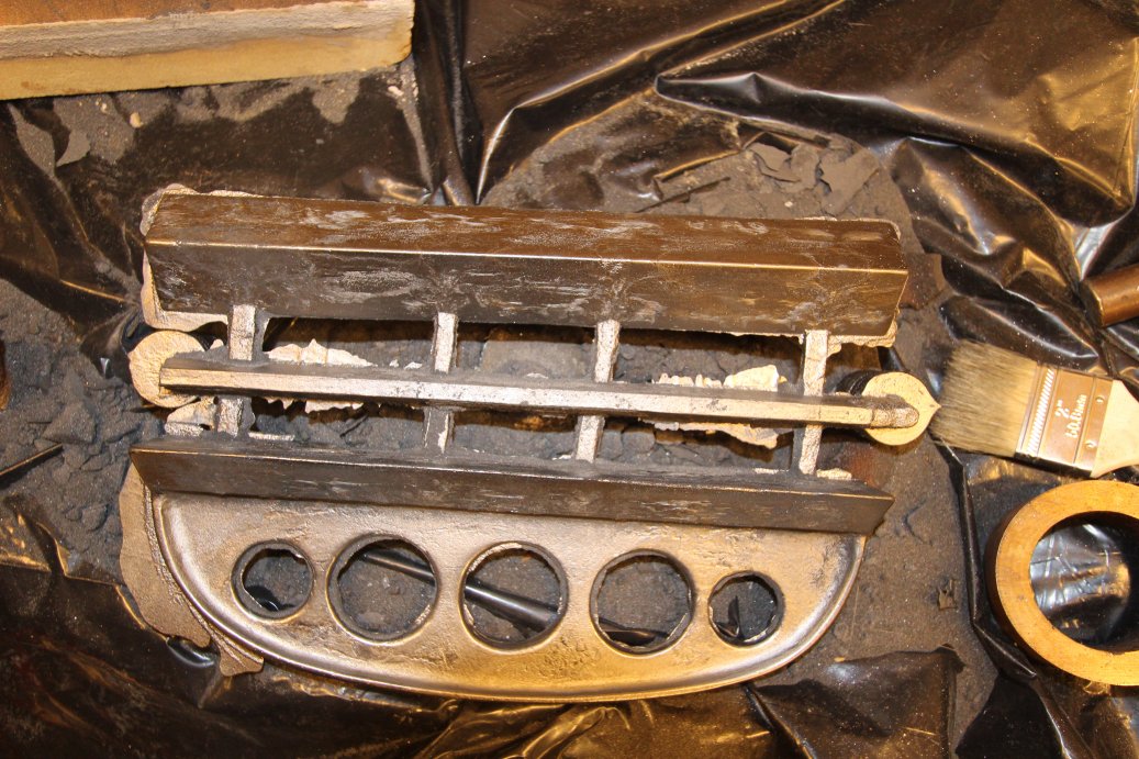

The Chirpman castings.
