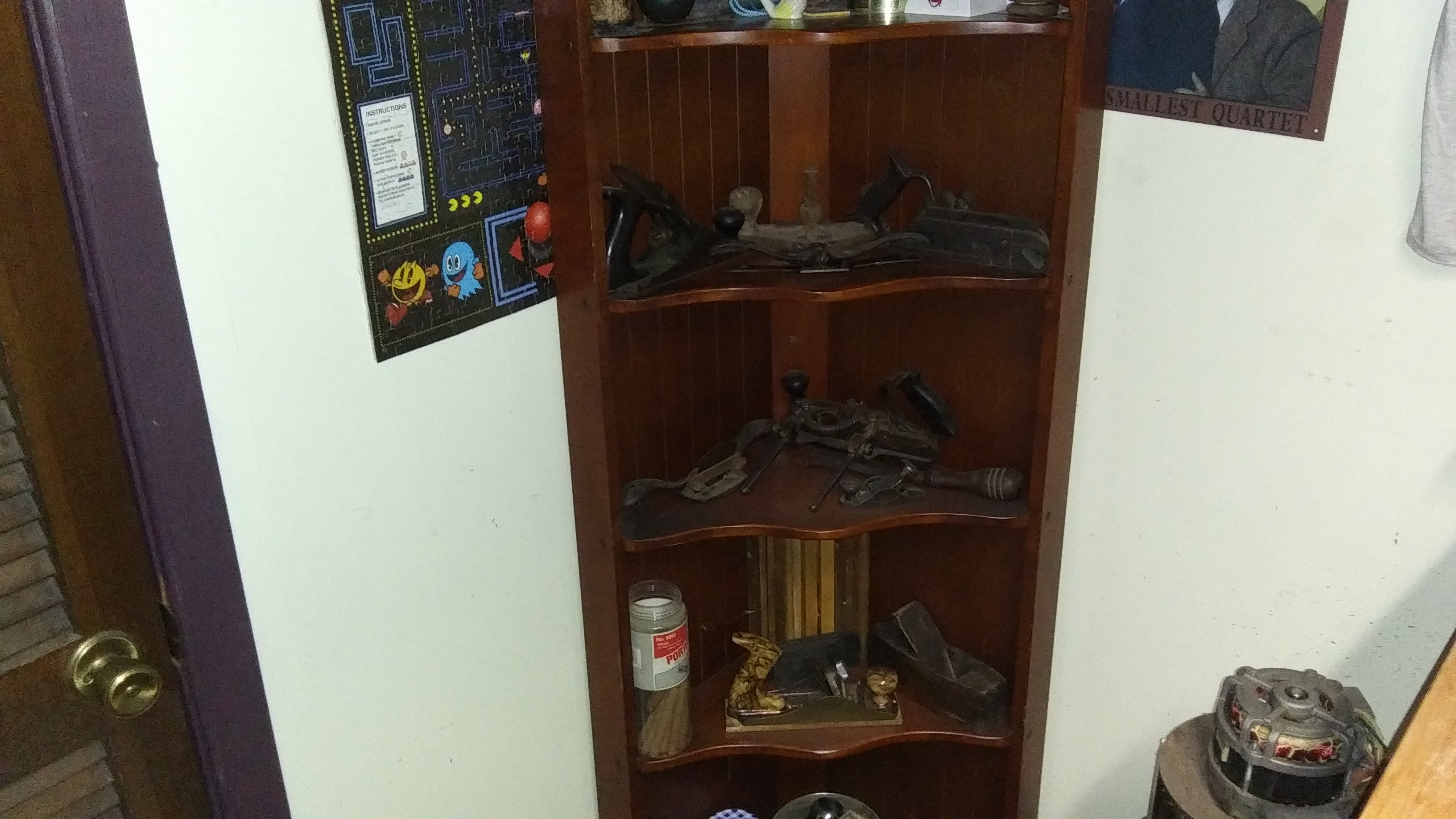

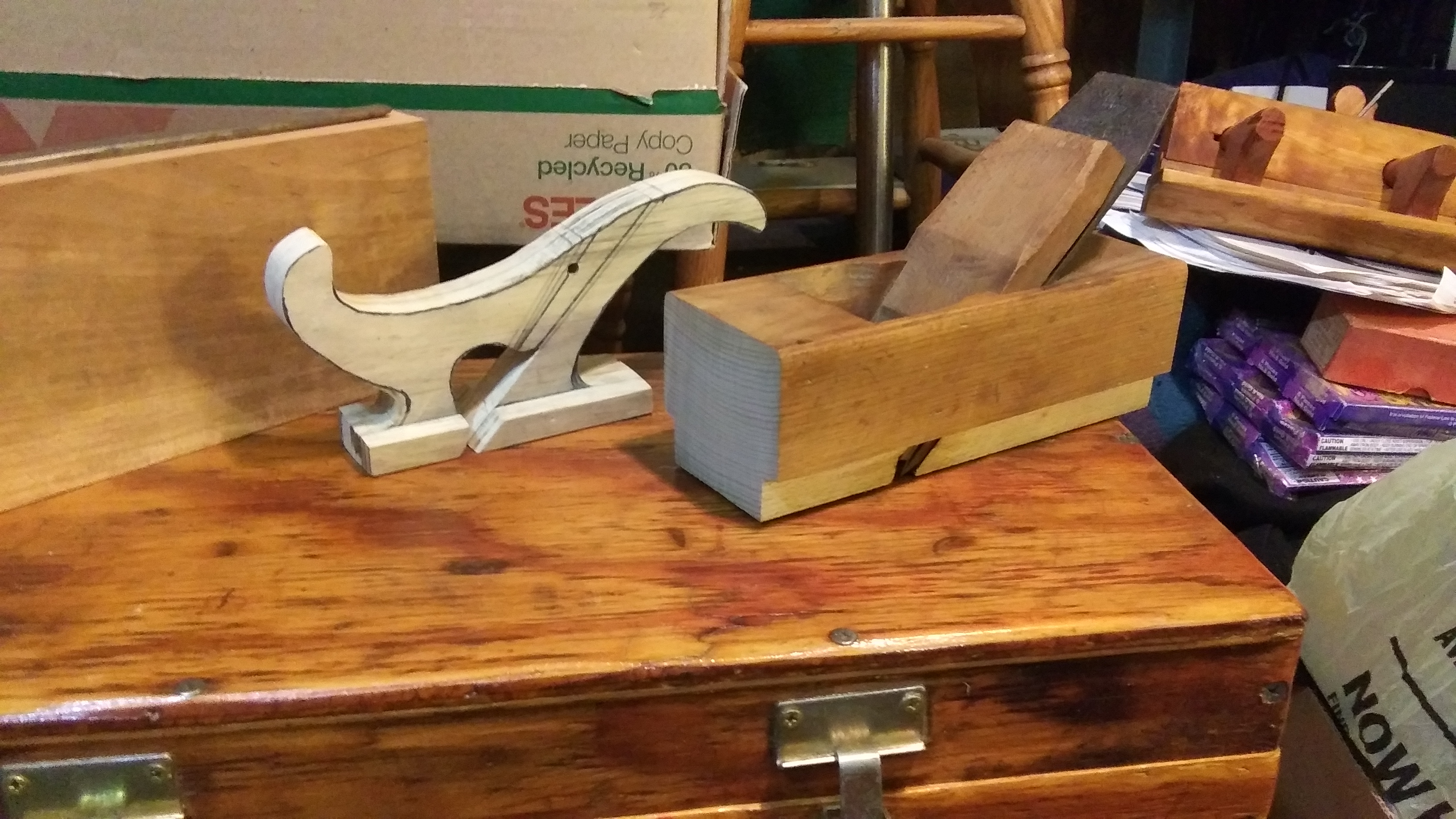

I figured I would post this, but the original patternmaker's plane is finally at home on the display case, where it belongs, with all of my grandfather's planes.

I keep saying that Im done making hand planes for the toolboxes, but I will probably make alot more to sell. I keep thinking of making the patterns up to make a T rabbet plane, but idk if I really want to do that one tbh. It looks cool and looks like it could be pretty comfortable, but yea. Then I keep thinking of just making a pipe plane style and saying screw it, lol. Im not sure why, but I really like the pipe plane style, and I can kinda see a rabbet plane in pipe plane style, but it is a bit of a challenge to say the least because of how they work, lol. There's an inherent weakness in those planes that I keep seeing, but not sure how to get around it really without making it taller, but that's not a viable option either.
Ive been thinking about it for a while, and I do have a 3/4" wide rabbet/shoulder plane that I use all the time and works really well, but I keep running into patterns and such where I need a step much wider than 3/4", so it keeps throwing that problem at me. I have an old stanley one that I have used, but I absolutely hate the thing and it really doesnt work very well at all, so I just keep putting it back in the milk crate to get rid of, then I get it out for those odd jobs and have to go over the workpieces to clean them up because of how badly a finish it gives.
I keep trying to go across the grain, and with such a wide mouth as the stanley has, it likes to give a horribly bad finish that is really rough, and rips the wood fibers out all the time. That and the blade is square across, which isnt too bad, but I think I would rather have it skewed so that it's acting as a shear cut in the work. The blade spans across multiple fibers and cuts multiple at once, which will also prevent the grains from tearing out and leaving a rough finish, so smoother finish and less cleanup afterwards.
I have a few ideas of what I want, but not sure the best way to do it really. At the same time, I kinda want that T rabbet plane also, so maybe I can just make it both? :P

I like the display, nice to have your grandfather's tools.

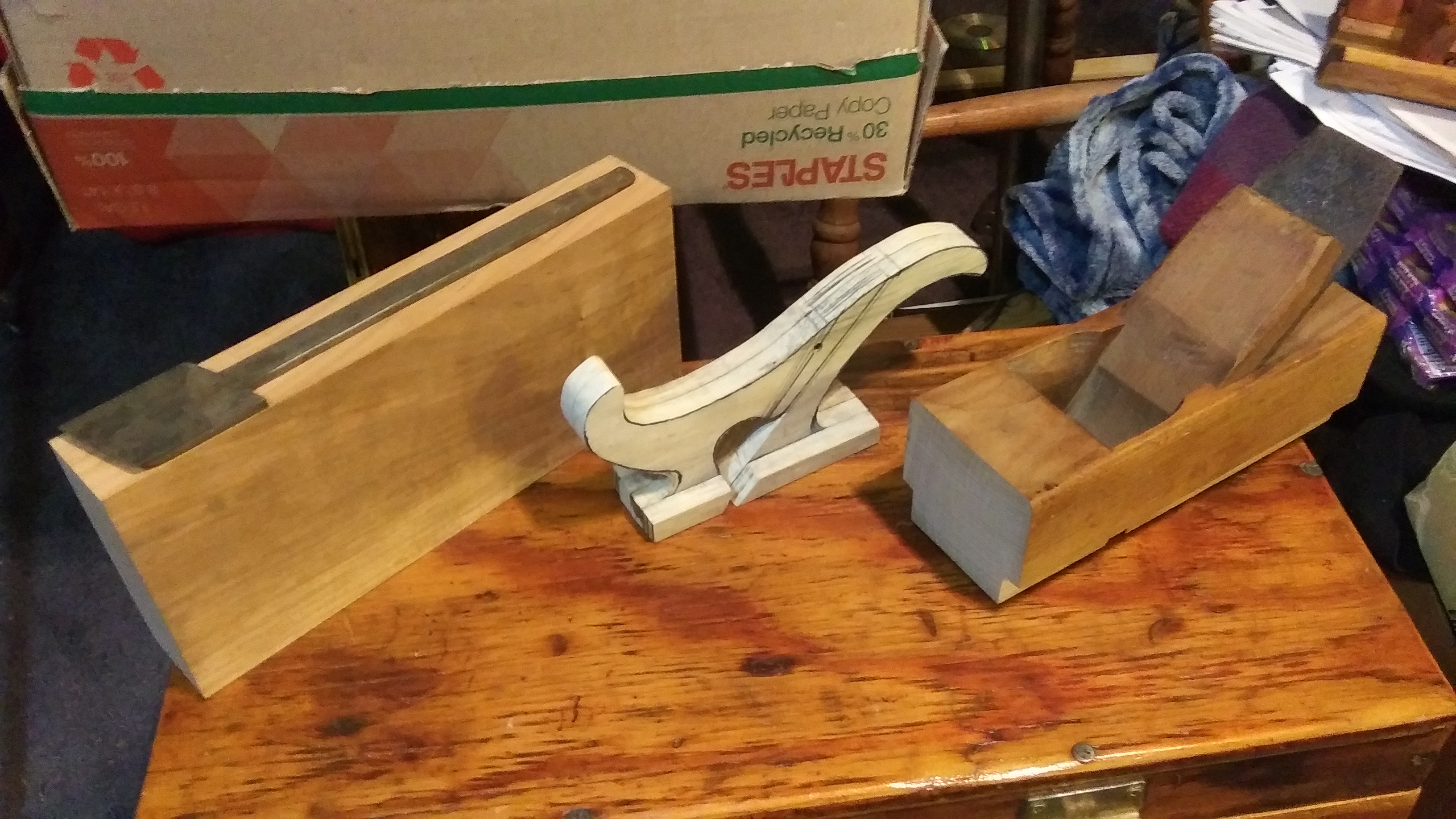

Well, I was struggling if I wanted to do the T rabbet plane, skewed iron rabbet plane, or a door check plane. They're virtually all the same, but some are better at some things than others, and Ive been struggling to decide which one to make, so I finally just said screw it and decided to make all 3, lol.
The skewed rabbet plane, Ive had the blade/iron for it for a while now and Im guessing it's from the 1820s-1840s at least, but it's very very old wrought iron with carbon steel cutting edge welded on, and it's pretty pronounced, which I thought was pretty cool and Ive wanted to make a body for it for a while to put it back into service, lol. I have a block of quartersawn cherry that Ive cut a tongue and groove in it and put a hedge apple/osage orange bottom onto it, so all that's left is to cut it out and lay it all out, then start drilling and chiseling everything to fit. The glue is drying between the body and sole right now, so maybe tomorrow Ill get onto laying that out.
T rabbet plane is all ready to go, just need to carve it and put a pocket in it for a fake split wedge to act as a core print. I have it sitting there so it's ready to go for something to carve on at carving group. It's a split pattern, but it'll be cast in bronze when I get it done. The door check plane, I traced a coffin plane shape on it and marked it half way to create a half coffin plane top and half square body plane, which would be pretty comfortable and the best of both worlds. I already cut the waste off, just need to carve/shape it, which once again, saving it for carving group, lol.
I kept seeing the door check plane in use in the videos of the one planemaker I watch, and wasnt sure what that plane was, but when I finally figured it out, I decided that I had to have one, lol.

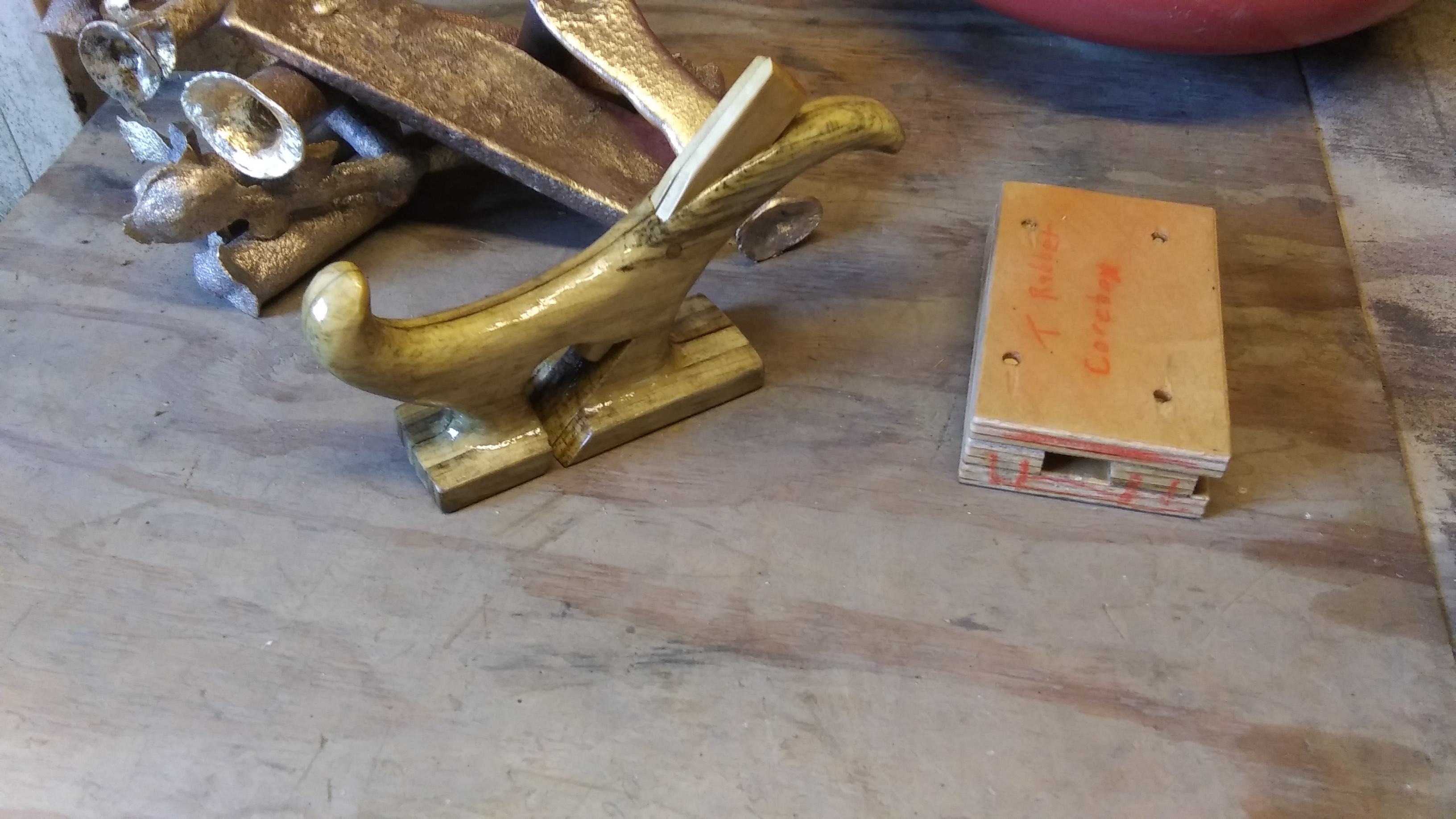

A little update:

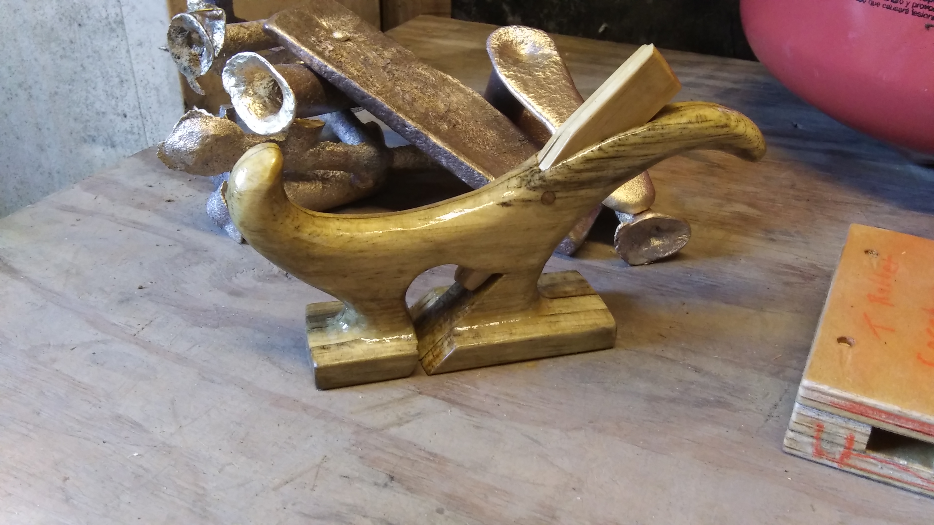

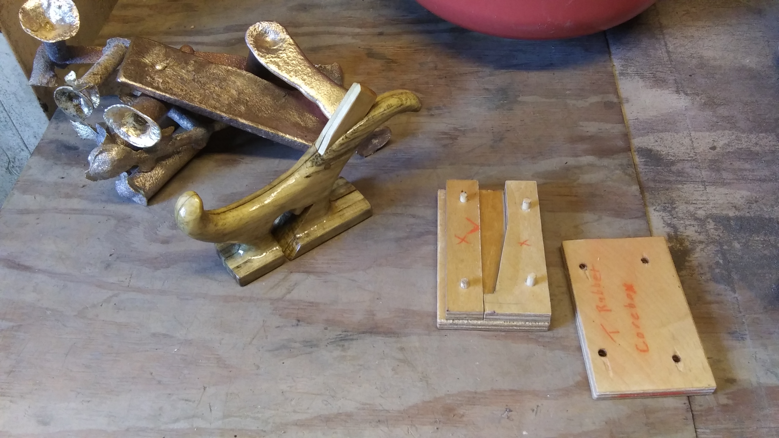

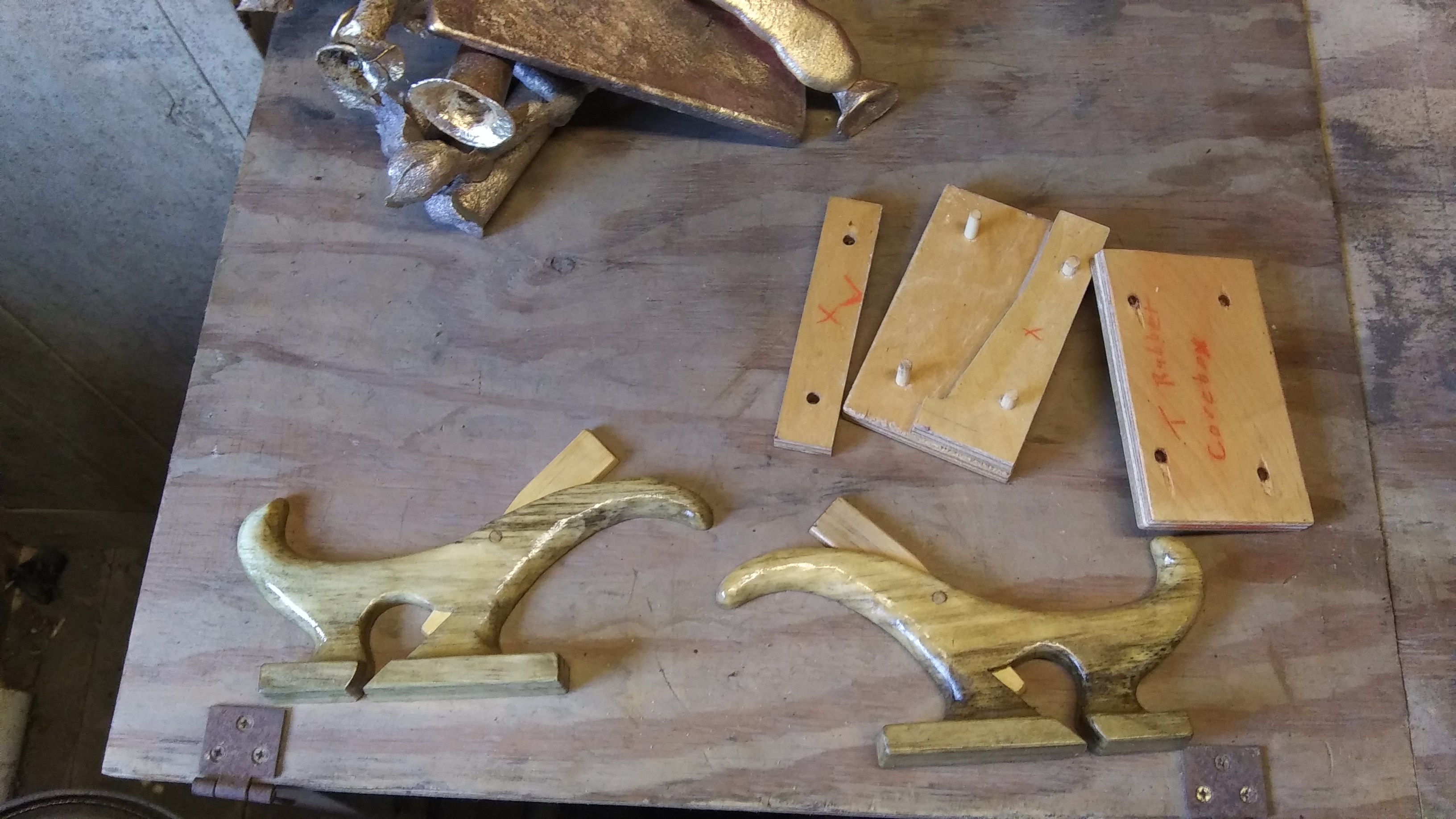

T rabbet plane, I got all carved up, sanded, and shaped how I wanted it, cut a pocket in it for the wedge to go through before carving, which a dummy split wedge went in to act as a core print. I also made up the corebox for it from some higher grade plywood that I had that was exactly the right thickness, so it got cut up and shaped. I did go back and filled in the corner at the back of the escapement area there with some wax so it wouldnt form a cold shut in it.
Looks like it'll take around 4lbs of bronze to pour it, which when machined up should be a pretty stout plane, but pretty nice weight too. I have plenty of bronze sitting behind it to pour it, just need to wait on the shellac on it to fully dry/harden up, then a rub down with fine bronze wool and some paste wax, then it'll be ready to ram up and pour.
The door check plane, it got cut down and I started carving on it at the carving group, but ran out of time, so Ill work on it next time. Here it is partially cut out, just need to shape it into the conventional coffin shape for the top half, then radius all of the edges so it feels comfortable in the hands to use.

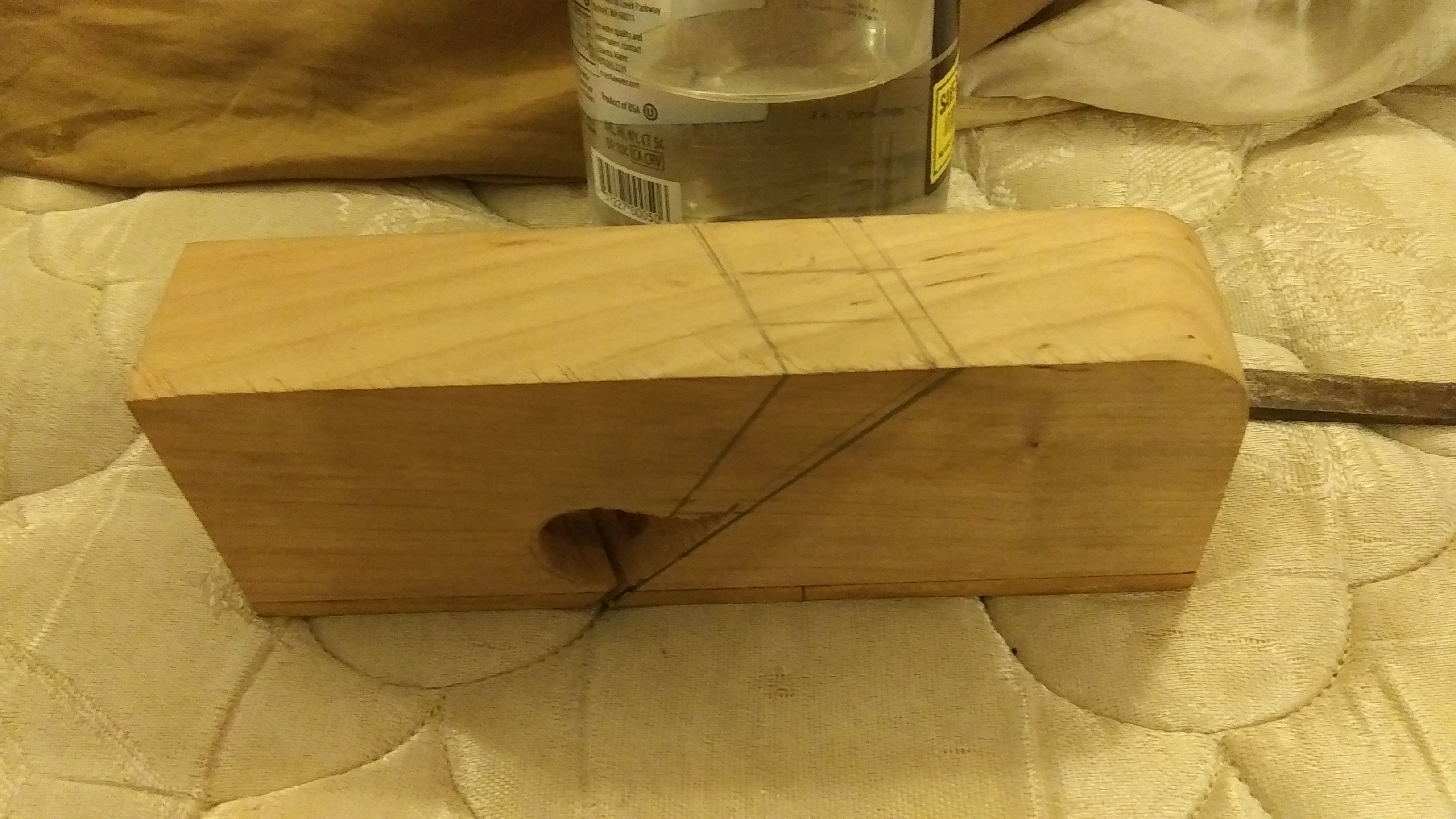

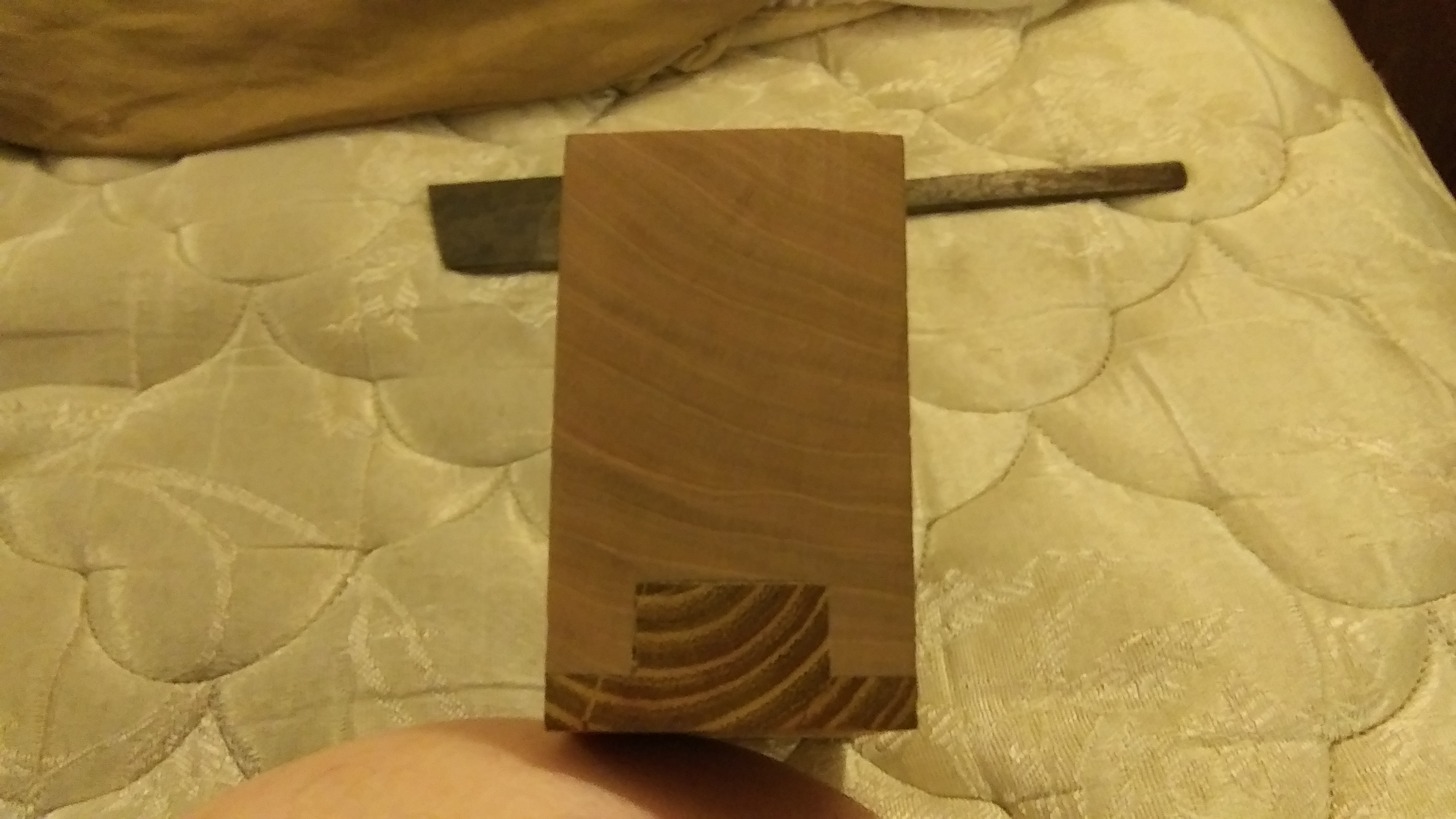

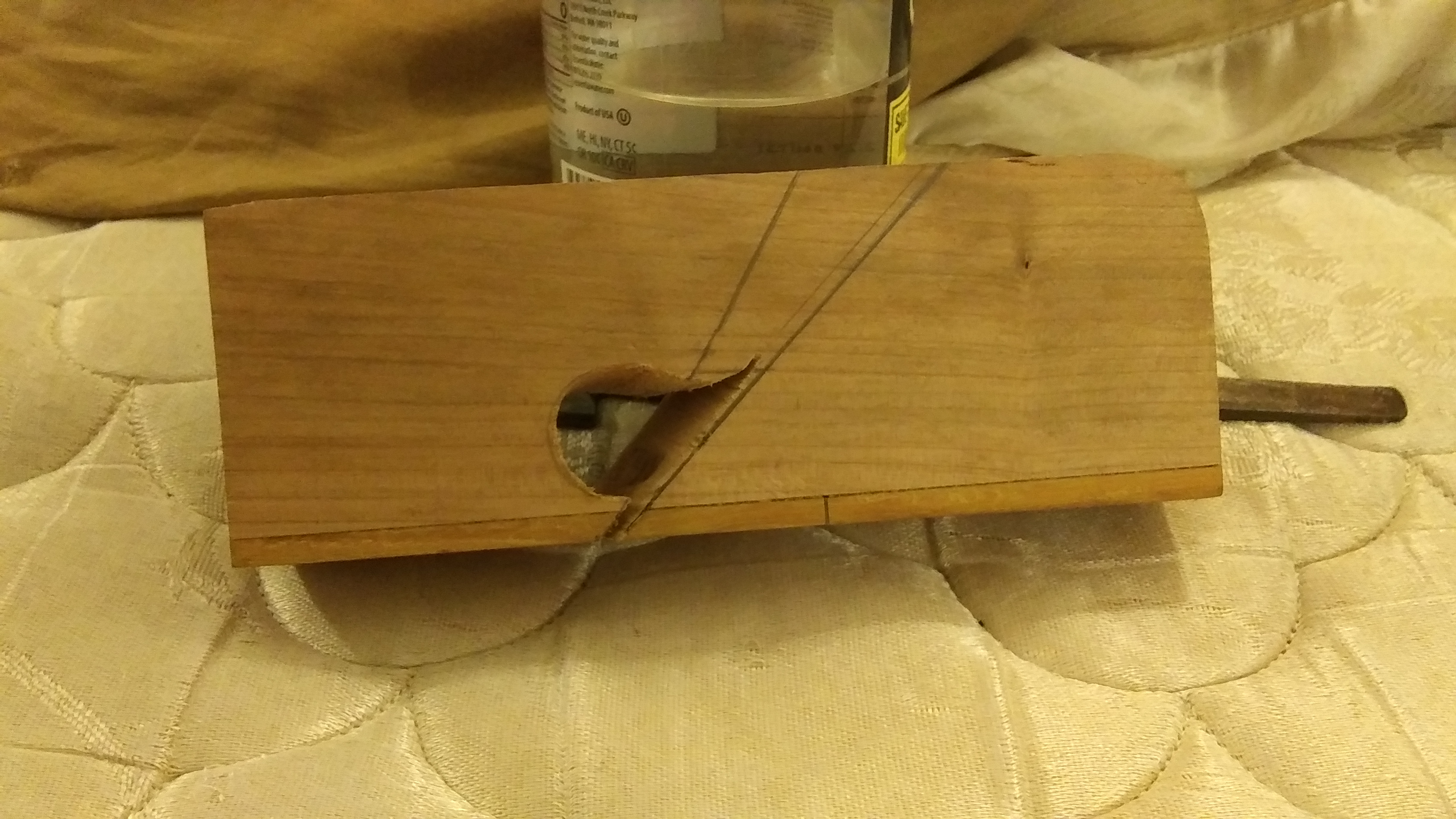

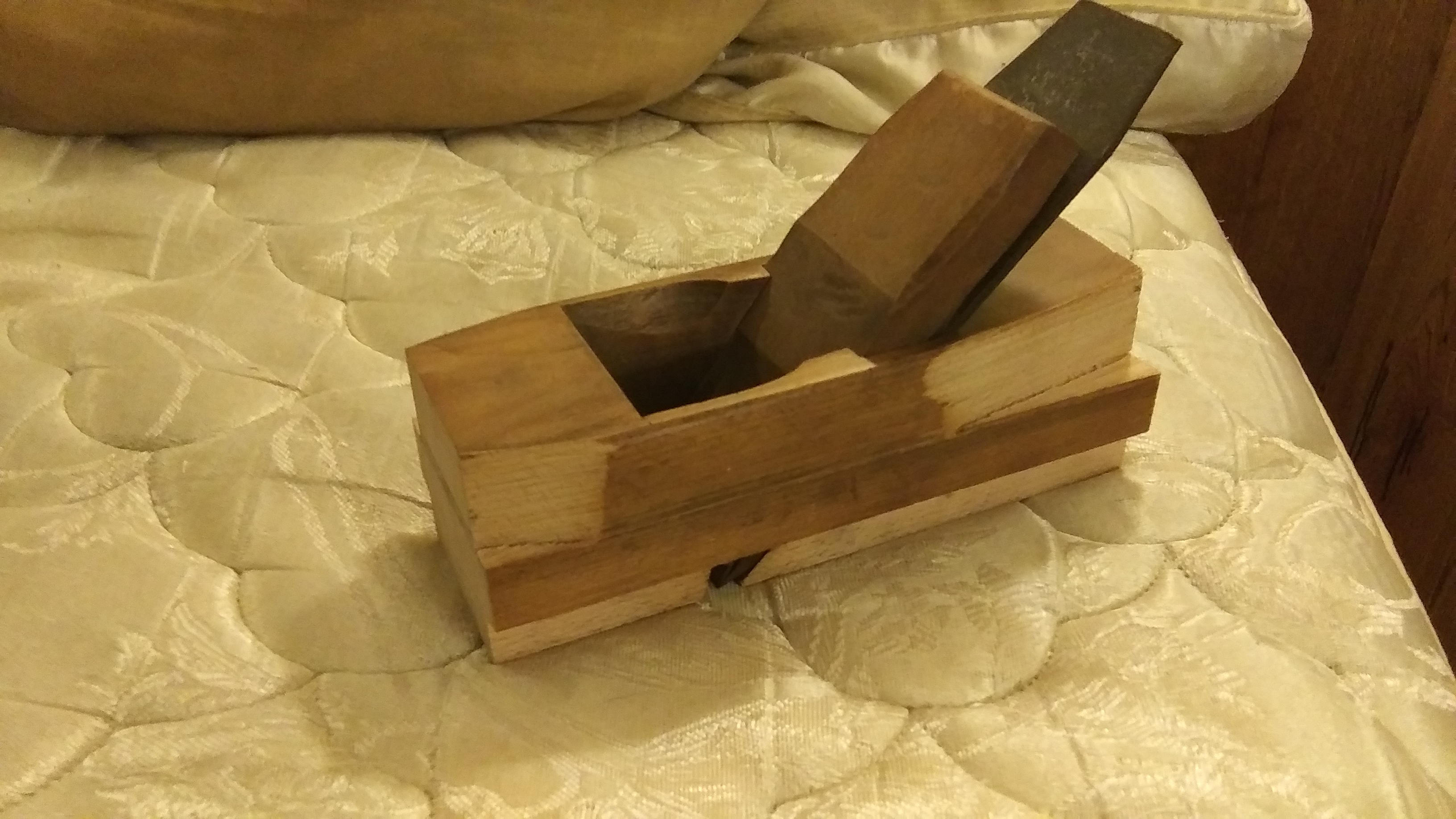

The skewed rabbet plane, I got a start on that, but it was defenitely not easy to drill and cut out for sure, lol. The body was cut up on the table saw to size/shape, a tongue and groove joint was cut into the bottom of it to put a hedge apple bottom/boxing in, and the mouth and escapement was cut out. I have since drilled out the mouth and removed a large bulk of the material for the wedge pocket, just need to sit down and start cutting it out to shape with my keyhole saw and get it chiseled out to shape.

So you're going to cast the small one in Bronze? That will look sharp, well, either one will look sharp.

Thanks guys, and that plane really is not a small one, lol. The skewed one hadnt been cut down yet, so it looked bigger, and that old one is just massive. Those planes will have 1 1/2" wide blade in them probably, maybe 1 5/8" on the T rabbet plane. That large one is massive compared to the others and has a 2 1/4" wide blade in it, so it's a pretty massive thing, lol. The T rabbet plane does look pretty small, but it is typical size for those, and equal to a standard #4 block plane for length, if not a little longer tbh.
It's all wiped down and waxed, just buffed it earlier and it's sitting at the molding bench ready to ram up. I want to try something a little different with this one to help improve surface finish since my last one (the chariot plane) was just raw sand core and surface finish was pretty terrible inside of the casting, lol. I cant honestly remember what I did ages ago with the steam cylinder castings I did, but I dont remember the surface finish being that bad, although it was in aluminum and not in bronze. I do remember it was a bit of a nightmare to get out afterwards tho because I added way too much sodium silicate.
