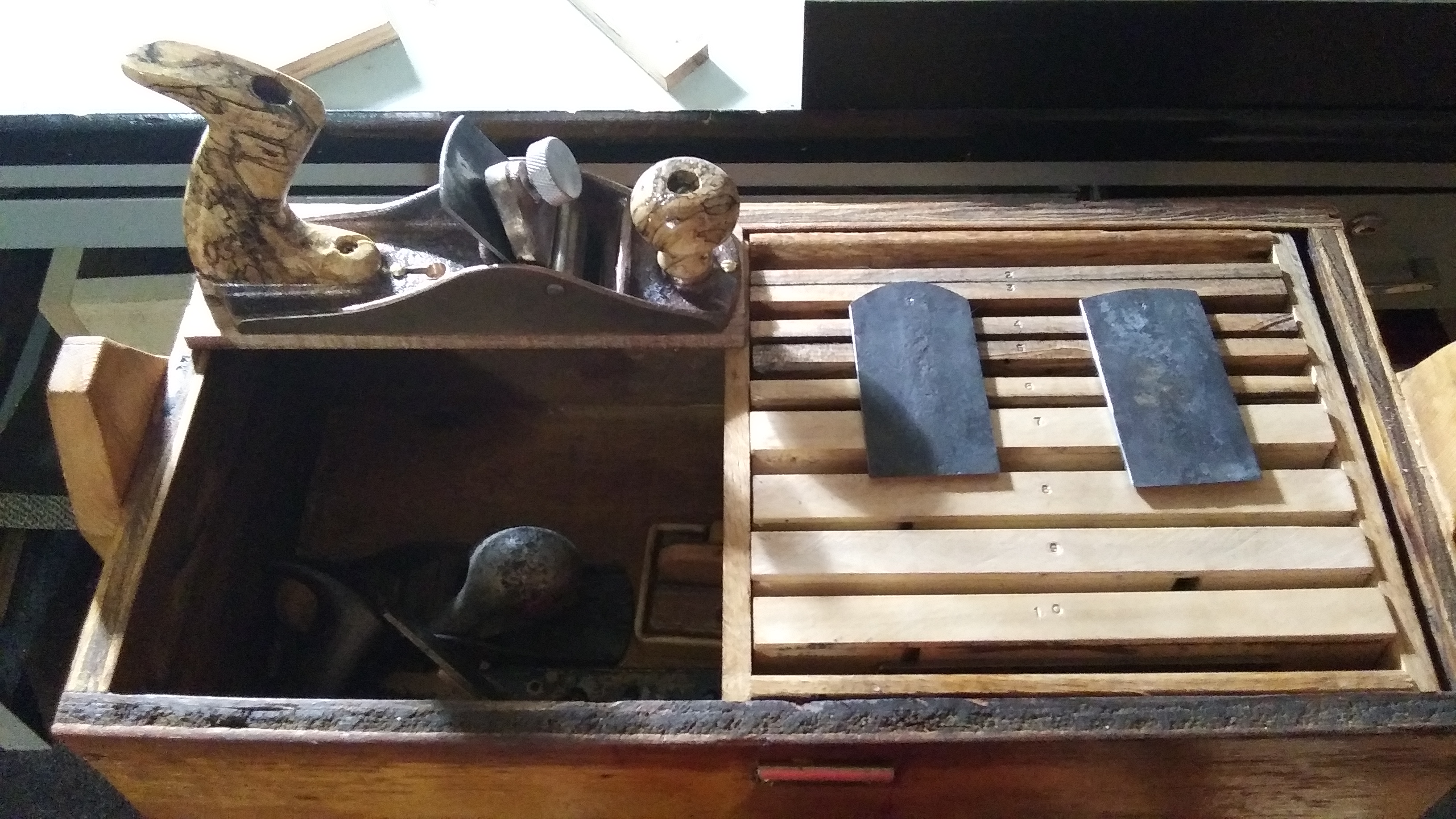

Well, when I was learning pretty much everything I could about patternmaking, I saw all of the hand planes that was used in the old patternmaking books, and with my allergies to wood dust, and how high of precision I could get using a finely tuned one,I really began to appreciate a good hand plane, lol. So after a while, I tried making myself my own patternmaker's plane.
I made the pattern in two pieces, the frog (where the blade sits) was held in with pins and was made as a loose piece, since it had to be pulled at an angle to the rest of the casting. The blade angle is a bit higher than normal planes, which I deal with some pretty knarly wood at times and some hard woods, and the higher angle blades help alot with that.
The plane was poured in a harder silicon bronze, and here it is after machining. The blades are forged out bed frame, which is commonly just recycled old railroad track, so around 1080 steel with added manganese, so it can get quite hard and still hold quite an edge. Thats why you hear that people cant drill it, weld it, etc and hate it. It's a higher carbon steel and the heat treatment on bed frames can be hit and miss at best, but when forged out and annealed, the steel machines easily and can be heat treated to hold a very nice edge.
I found a piece of firewood that I had sat off for a few years and had thoroughly dried, I cut up with the chainsaw into slabs, and turned the front knob on the lathe. The handle/tote was cut out and carved to shape with my whittling knife to fit my hand.
The soles on a patternmaker's hand planes are usually wooden, that way they can be shaped, and are numbered along with a set of blades to match each bottom/sole, which allows the owner to shape the profile, radius, etc that you would need, and just by swapping out the bottoms/soles and blades, you can change it to a completely different plane, which when toolbox space is limited, having one plane that can do many things is alot better than alot of individual planes.
That's the patternmaker's plane, and the start to this really really deep rabbit hole so far, lol.

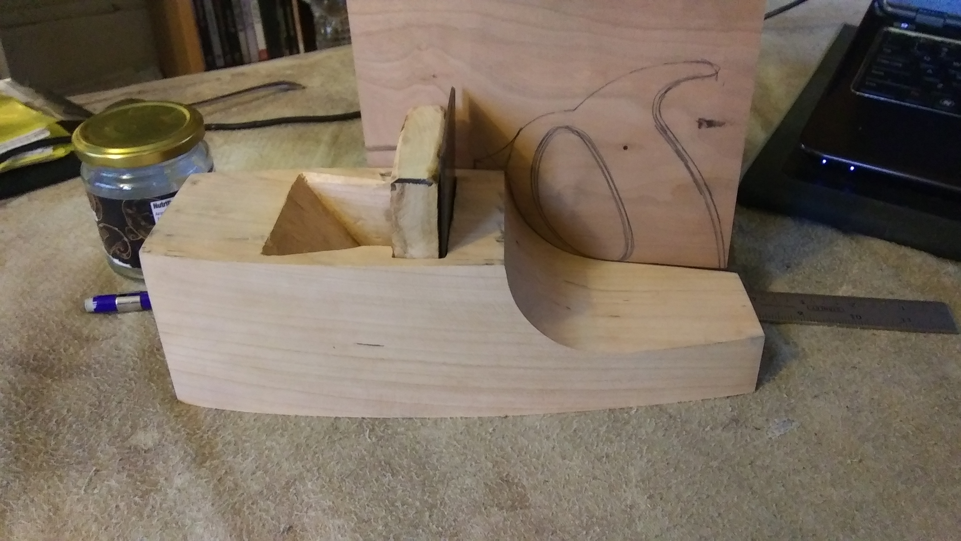

I wanted a scraper plane for a while now, that way I could just scrape and clean up the surface of a rough cut board, which alot of the lumber I get and use is rough cut, and also to clean varnish and such off of old scrap wood that I get also, so I decided I would just make one, lol. I found a 2 7/8" wide scraper blade from a stanley cabnet scraper plane, probably from the early 1900s or so, and knew I wanted a scraper plane with a large blade, so it was perfect for what I wanted.
I got out a block of cherry as usual from the firewood pile and it was rough cut and just came from a furniture place (we had just bought a semi truck load of wood blocks for firewood for winter), so I cleaned it up the best I could, planing it down with the patternmaker's plane. At this point I have it set up with the sole with a very closed mouth and set up as a smoother, and was getting a very good finish on it. I tested the moisture level of the block and it was right in the range I needed, and started carving on it with hammer and chisel.
As you can see, I kinda ran myself into a problem with the mouth and needed a keyhole saw to cut the wedge pockets and the mouth out to shape, so a bit of a side tangent to make a keyhole saw, lol. The blade was an old power hacksaw blade I had gotten last year at algonquin, but was a 14" blade, and my power hacksaw takes a 12" blade, so couldnt use it, so I cut it with the angle grinder and cut a tennon on the blade where it would go into the handle. The handle is the same black cherry that I use for most of my planes.
But with that done, I could get back onto cutting out the mouth and various parts of the plane.
I cut the back out and created a nice curve to it with the oscillating spindle sander, then cut and shaped the sides into a coffin plane shape, that way I could put a nice full tote/handle on it. I get a bit of a chuckle at how much it looks like a little tug boat at this point, lol.
I chiseled out and put a pocket in the body of the plane using some forsner bits and chisels, that way I could shape it exactly how I wanted it. I then recessed the handle/tote down inside the body of the plane, then did the same to the handle/tote pattern and created a tenon on the bottom of the handle, that way it would fit just right into that pocket.
(Ive run out of pic slots in this post, see next one)
