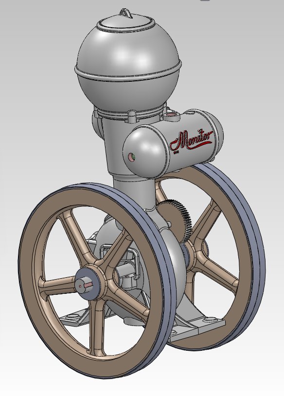

I am not sure where to put this, but "patterns" is probably a good place, since that is about where I am with the design.
I have built one steam engine, but really want to build an IC engine, and the Baker Ball Hopper Monitor seems to be an iconic design.
I had played around with some 3D modeling a few years ago, but restarted with all new models after I ran acround a guy named Barney on ytube who owns two 4-hp ball hopper monitors.
I was able to get Barney to take some measurements and photos of his engines, and then found some old factory information and additional photos on flockbook.
There apparently are very few photos of Baker ball hopper monitors anywhere, especially photos of disassembled 4 hp engines, which is the engine I am modeling.
It starts in Autocad 2D, and then goes into Solidworks.
I made a lot of progress on the 3D models for this engine over the last Thanksgiving holiday.
The next step is to start printing patterns on the new Prusa XL.

At 1/2 scale, the flywheel will be 14 inches diameter.
Looking closely at the photos I have, I am trying to spot the parting lines on the original engines.
I think I know where the parting lines are.
Baker did a good job of hiding their parting lines.
Here is where I am with the 3D model.
