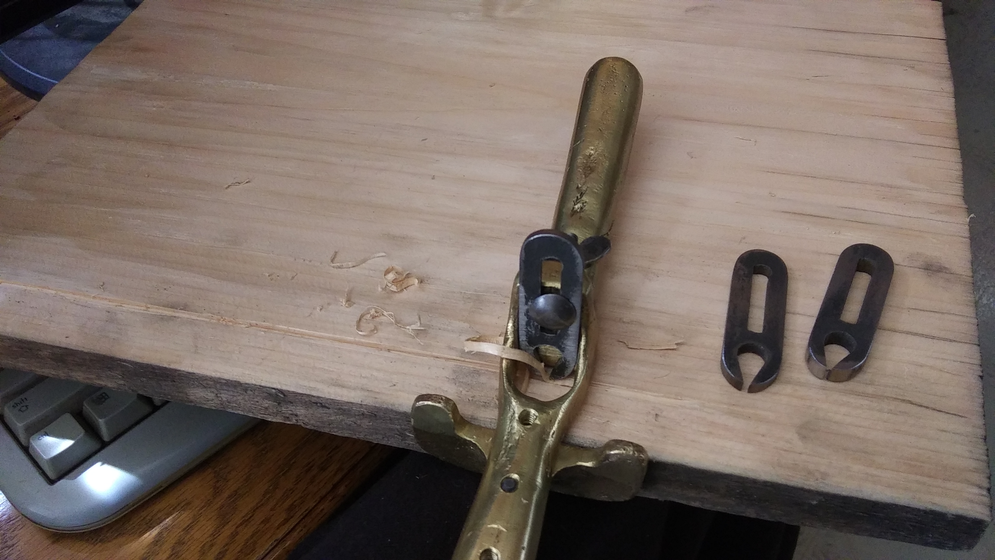

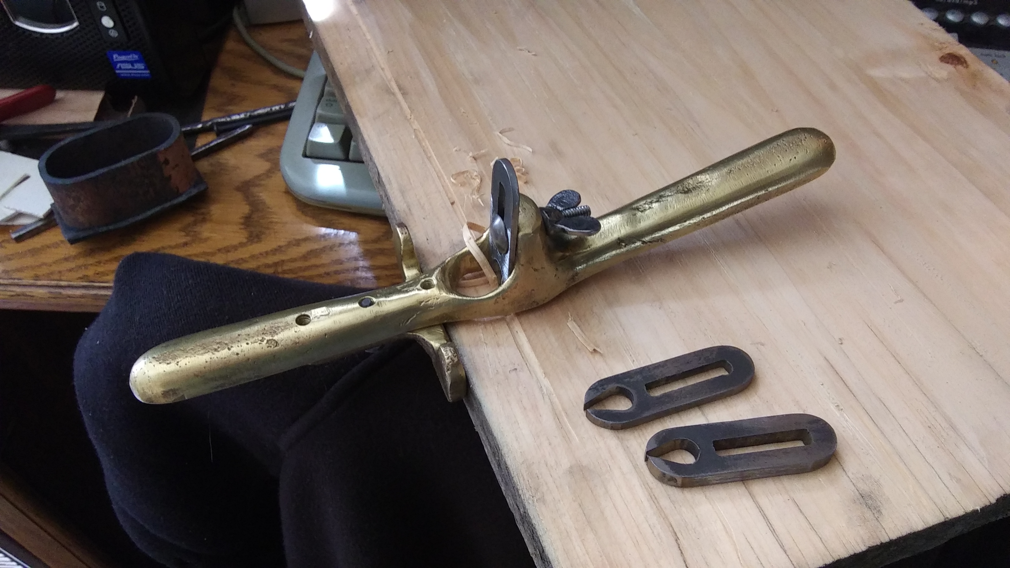

Well, I got the blades cut out, made a 1/4", 3/16", and 1/8" cutters, which I still need to cut the V grooves in them for the spurs/knickers on the one side, but I just havnt done that yet. I thought about making some thinner cutters for it, but not sure I would ever use them tbh. The 1/8" was just a piece cut out of some bed frame, which was already at 1/8" thick, and the one I'd be using the most anyhow, and the other two were made from some leaf spring off cuts that I had cut off of the jointer plane, and milled down on the shaper.
It has technically had it's first shavings, which it does work pretty well and is pretty quick and easy to use, but not having that front part open for the spurs/knickers, it really makes it akward and not want to cut very well. The spurs/knickers slice the wood ahead of the cut, then the other side of the cutter comes in behind that and scoops the material out, so it can go across grain and leaves a perfectly smooth and sharp edge to the slots/grooves. The spurs/knickers side also sets the depth of cut too, which right now, both sides are equal, so it doesnt really want to dig in and cut very well at all since both sides are technically set flush with each other.
I was thinking of taking some black shoe polish and rubbing it down with it and giving it a buff, then the casting defects and sand cast texture underneath would get filled in with the black shoe polish/wax and harden, so it would look like the old japanning, but removed off in the high spots where you would grip, so it would fill in the defects and would look like unworn areas from the japanning, and the rest would be patina'd brass, which it wants to do pretty quickly on it's own tbh.
Edit: after reading how the shoe polish wears off pretty easily, I do have some black paste wax I can use to fill the spots in, and i know that it does harden, so I may use that instead. Ill have to do some experiments with both to see what works and what I like.
yea, when you get the angle just right, it cuts really really well, but because the cutters are missing the spurs/knickers side, and the cutout for those to also set the depth of cut, there is really no depth of cut and is finicky to actually get it to want to cut right now. Once the spur/knickers side is done, it'll drop the cutting depth down a little bit so the scooping edge can dig down in a bit and work alot easier.
Well, it's done, lol. The blades were filed out earlier this morning and heat treated using the propane torch since I couldnt fire the forge up. We have burn bans all over the place here, everything is just too hot and too dry, and we're in a major drought right now, so I just used the propane torch to do them up.
To do the spurs/knickers in the blades, I wrapped the cutting edge side of the blade in a few layers of blue painter's tape to protect the edge. Then I just used a V file and filed a notch in the middle of the spur/knicker side, then used the corner of a normal file to dig down in and remove the material. The larger blades, I did the same, except I used a round file/chainsaw file to file the material out, so they have a round groove in them instead of a V.
The spurs make a massive difference in using them, even going across the grain. There was a knot in the board and it didnt even recognize it was even there, it just sliced through it like it didnt even exist, lol. Going across the grain, you really saw the difference, the board I was testing it with, it is very soft eastern/northern white pine, and some of it was a bit punky, so it wasnt the best to do the test on, but it still excelled tbh.
The top in the first pic was before the spurs/knickers and it just tore chunks out of everything, second was after it was just filed and rough shape, before it was actually heat treated and sharpened, which you can see was a massive difference. Then in the bottom pic, you can see the edge was even more cracked and punky, but it was done after heat treating and sharpening to razor sharp, so the edge of it was very sharp/crisp, so I couldnt ask for more than that. It is very very quick at cutting the grooves too, I was really surprised about that, probably removed 30-40 thou per pass quite easily, so you could do a groove along the edge for a drawer bottom in a matter of 10-15 seconds at most.
