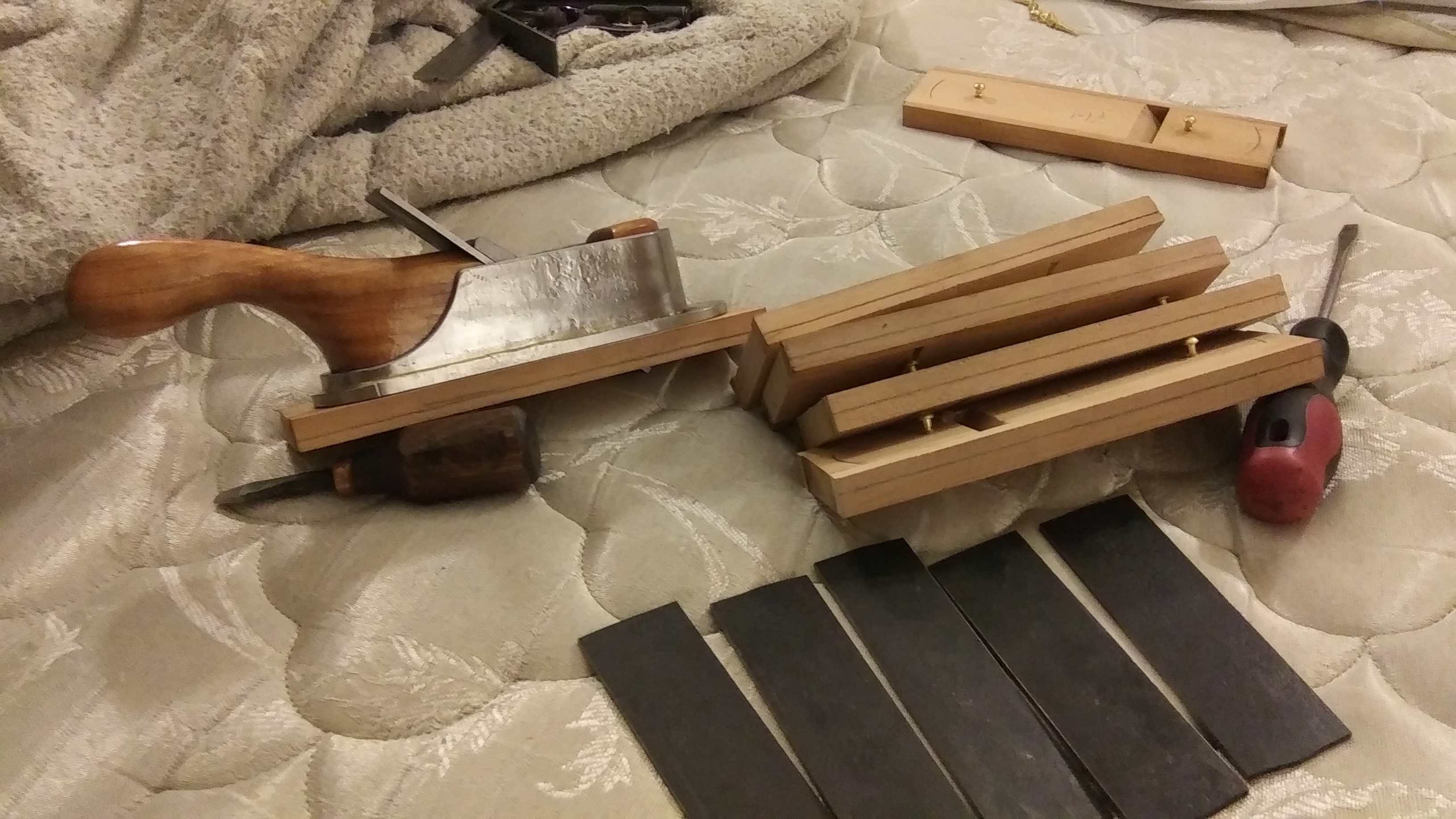

A bit of a catch up here, I re-forged the plane blade blanks to try to shove the seam down into the blade a bit more and to flatten them out, which there was a bit of warp in them before. I went to machine them and it ate the piece of HSS that I was using, and did very little to the plane blade blanks, lol. That shows how hard and tough bed frame can get when hardened, lol.

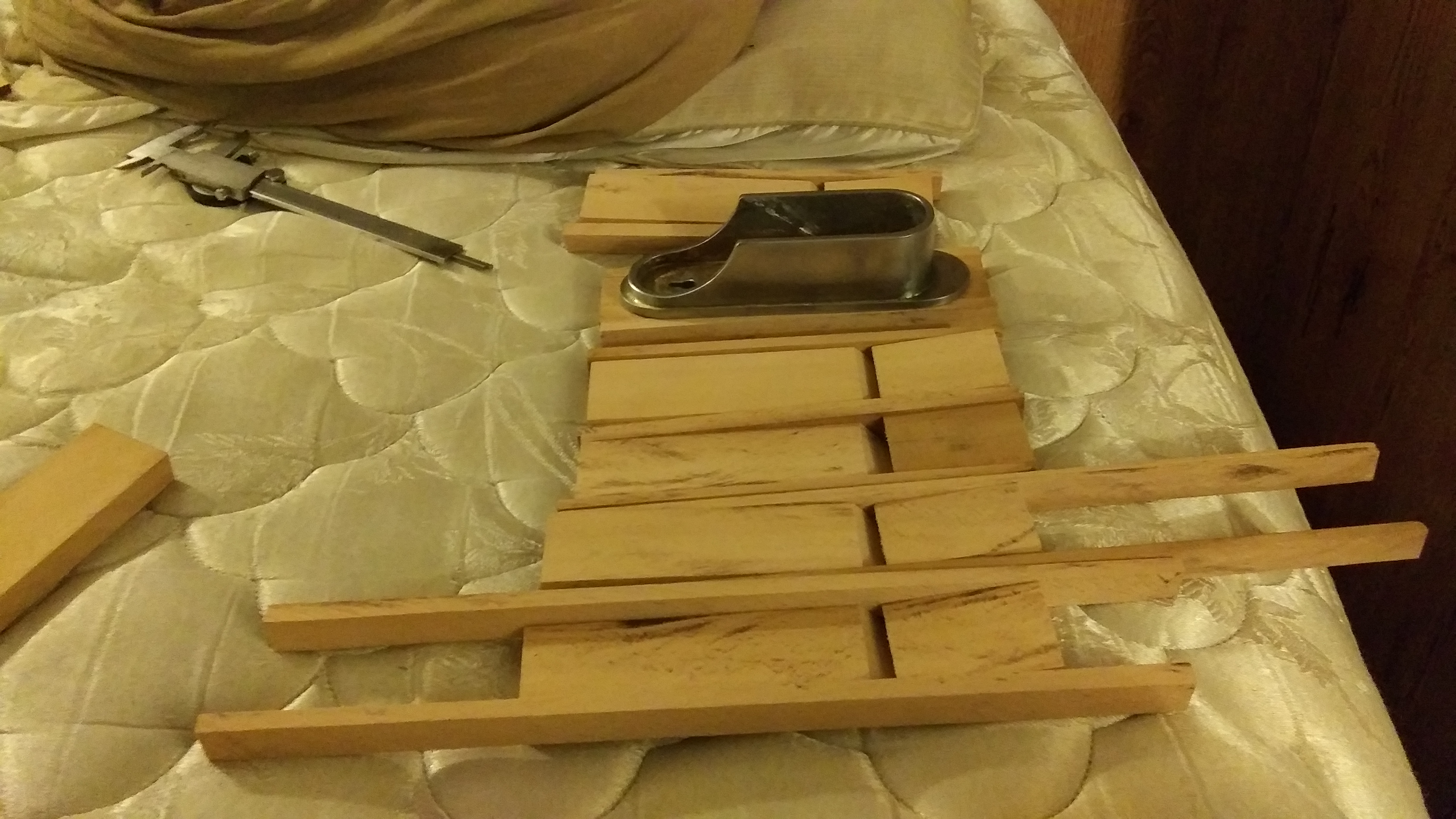

I had this really really old jointer plane that had broken a number of years ago, and that I had gotten at an auction. It was in such bad shape that there really was no saving it, so I just kept it as stock to use for fixing other antique planes and such. I used a cutoff of it for making the wedge for that antique plow plane I restored a while back. Well, I cut it up and glued it back together to make a half a dozen bottoms/soles for this plane, and the bottoms are now ready to shape to the various radiuses Im after.
The infill was coated in boiled linseed oil and left to dry for a few days, then has I think 5 or 6 thin coats of shellac on it now. The infill was also laid out and drilled out around the keyhole slots with a forsner bit to allow for plenty of clearance for the domed head screws.
Now that we're caught up, I stuck the blades back in the forge, tying them all together using some bailing wire so they would heat up and cool down as one big block of steel rather than individual thin pieces, and just got them red hot and left them to cool down in the forge after closing up the front and back doors on it. They were machined up once again on the shaper and this time, they were like butter to machine, lol. I also machined the new lever cap so it was parallel and fits into the body of the plane nicely now. It just needs drilled out and cut up, then the groove cut in the front of it when it comes time.
The infill was put in, everything filed to fit perfectly and so the infill had a seamless transition between the steel of the body and the internals, and the screws for the soles were put in for attaching using the keyholes. The infill on this one isnt going to be epoxied and screwed in like usual, just screwed in and left as that way in case I ever need to remove the internals to work on making new bottoms/soles later on.

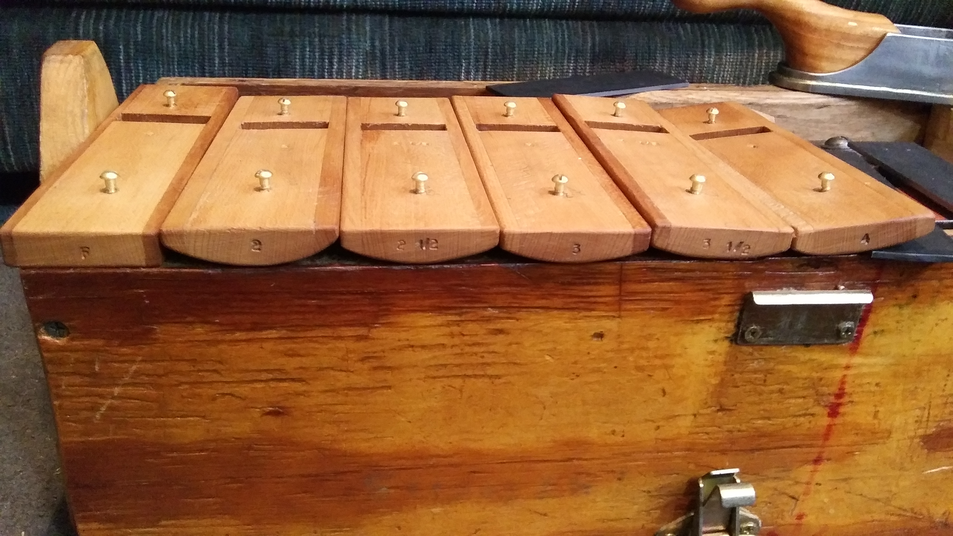

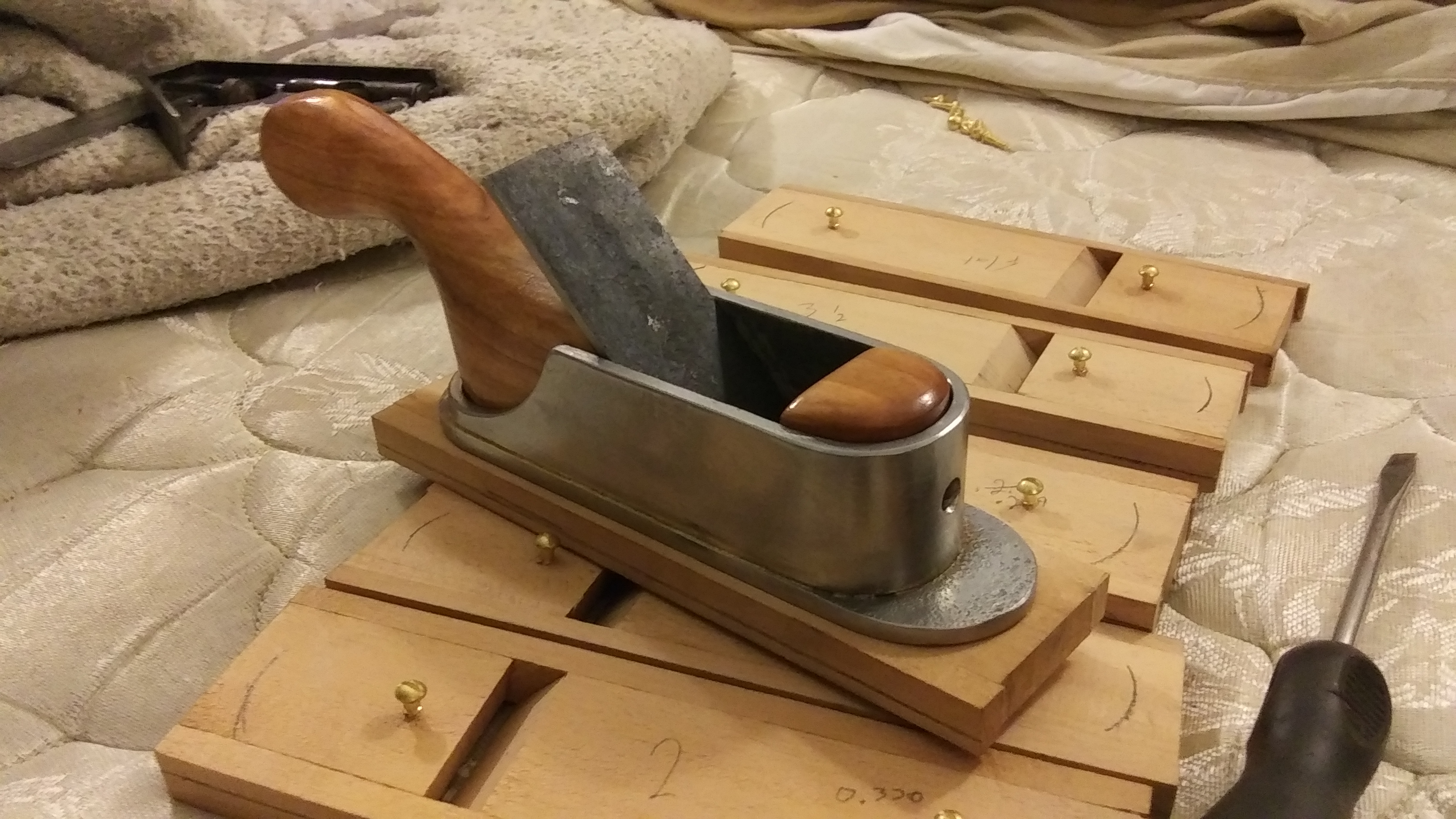

The bottoms/soles were cut to length and ends trimmed up and cleaned up. The lines on the sides of the plane soles/bottoms, they were there for laying out the radiuses for the bottoms, so this morning, I took some cereal box and cut out some templates, transfered it to the soles/bottoms, and started going at it with the block plane, lol. Then I went over them with my cornering tool to round over all of the corners on it so it is comfortable to use and wont splinter/chip in use if it gets bumpped into something in use.
One flat one, a 2" radius, 2 1/2", 3", 3 1/2", and 4" radius bottoms, which they still need sanded, coated in BLO and waxed, but those parts are done for the most part.

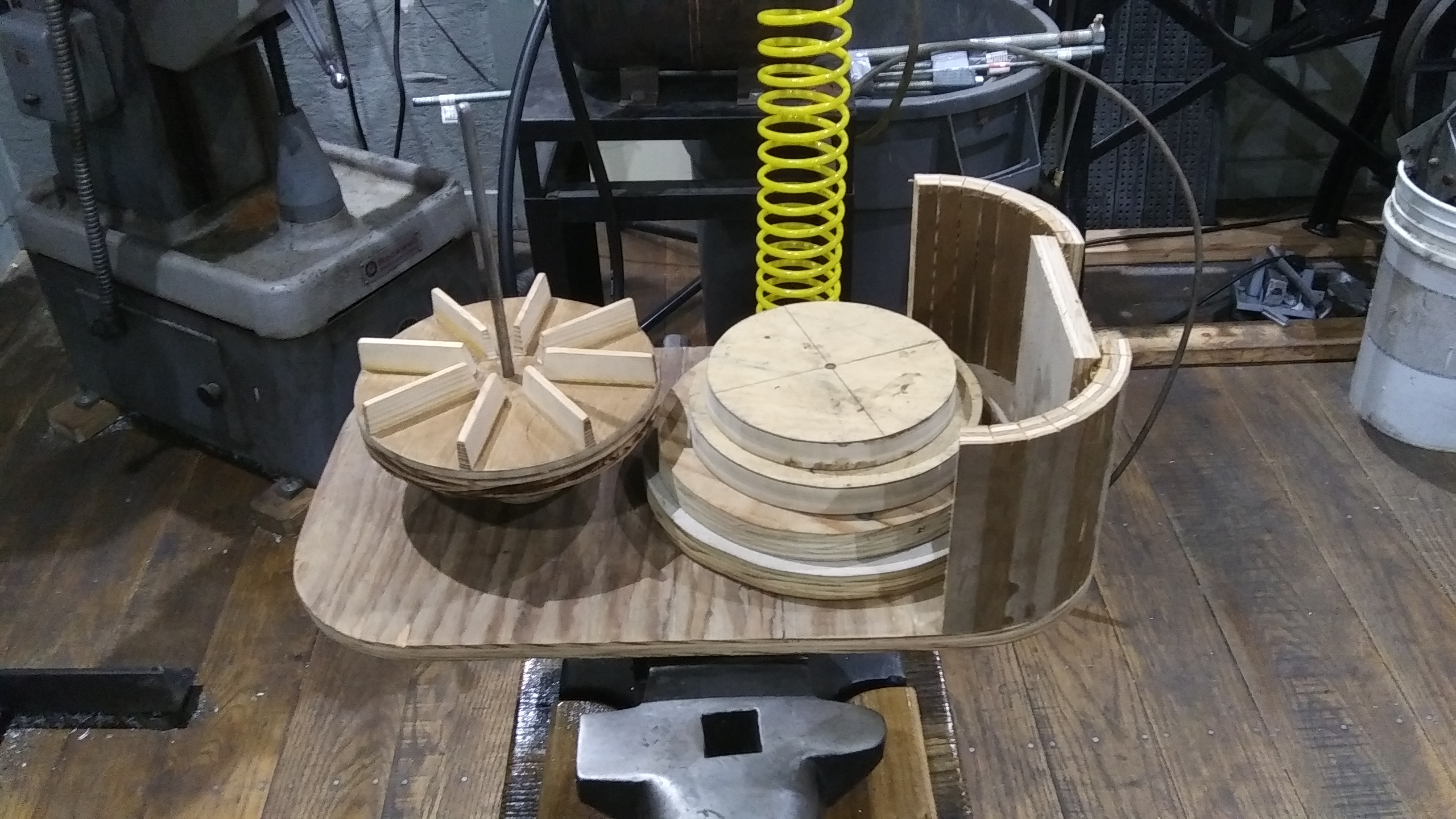

Here's an example of something I would use it for, for cleaning up the insides of coopered parts, which these are the patterns for the corners for the vertical milling head's belt housing.
With this plane being much narrower than the other one, I can get into areas that the old one couldnt, and it opens alot more possibilities and makes it much more useful.

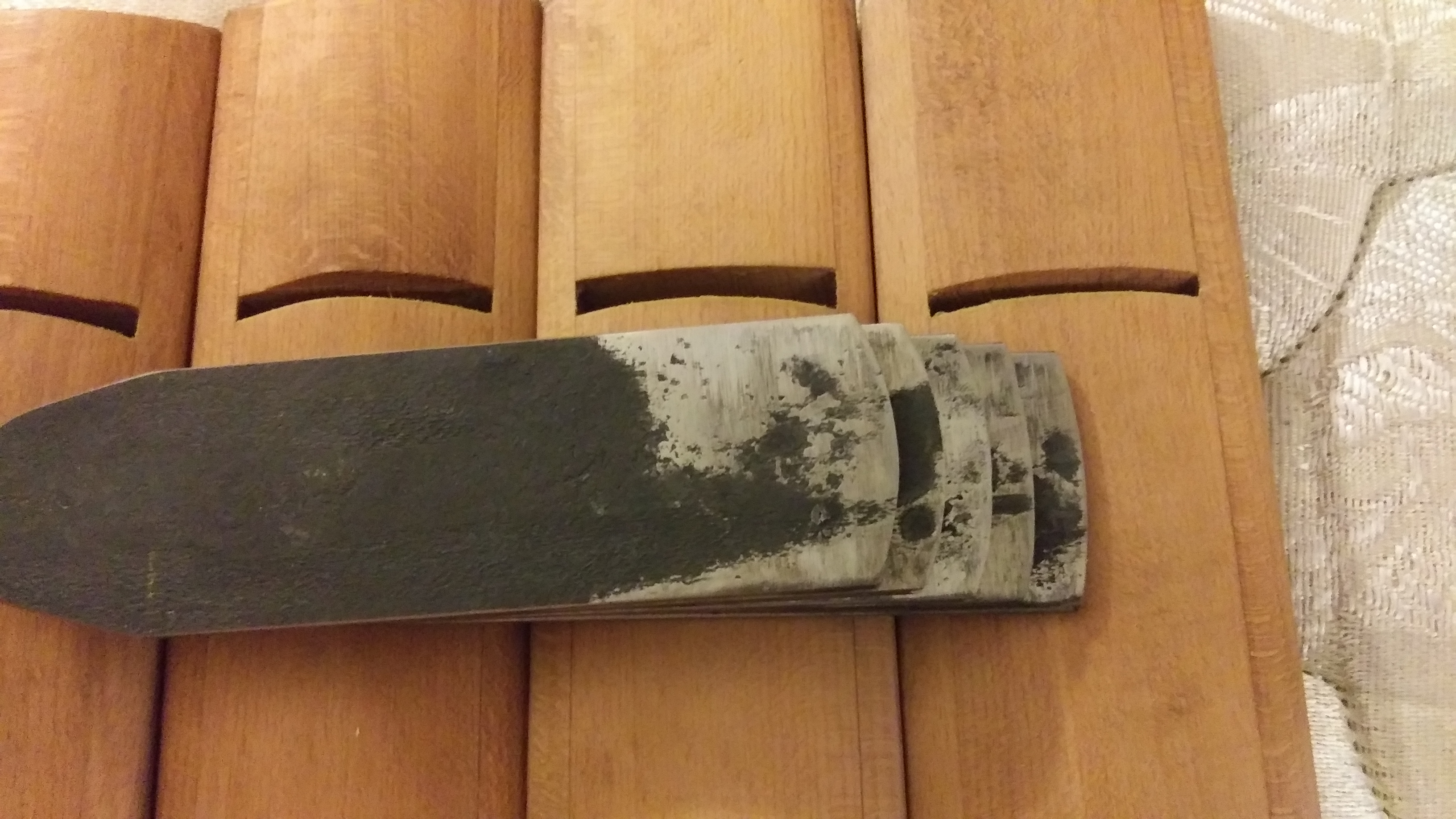

Blades are ground, bottoms were coated in BLO and paste wax a few times, then stampped with the sizes along with the blades.
Blades were ground to shape, then they were stuck in the various soles and used a yellow mechanical pencil lead to draw on the backside of the blades for each shape, then ground to shape profile to match the bottoms.

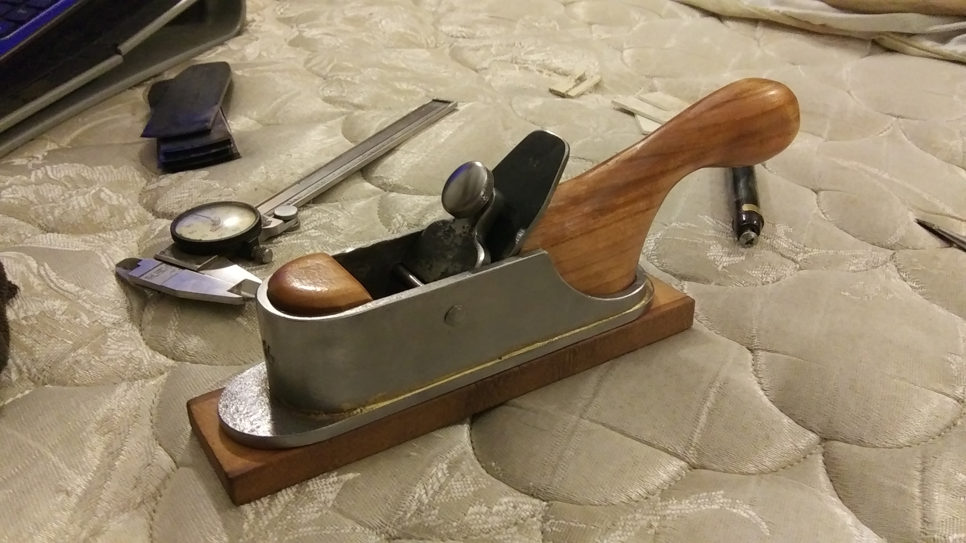

Lever cap was laid out, drilled out, cut up with the angle grinder, then shaped to fit exactly what I wanted. It was then drilled for 1/4" thread for the thumbscrew/knob. I just stuck a hex bolt in it for a general idea really.
Knob was turned down out of some coil spring from a train that I had straightened out ages ago, just turned it down, trued running the knurling tool over it and it was more or less a lost cause really, lol. The steel was far too hard, and tool post moved more than the steel did, so it kinda double tracked the knurl a few times, but it just looks like a super fine knurl now. I cut it off with the angle grinder and then stuck it in the cordless drill and took it to the belt sander to rough shape it while spinning it in the drill, then used the slack part of the belt to finish up the profile and create a shallow domed face to it. I then took some sandpaper and held it in my hand while spinning the knob/thumbscrew in the drill to clean up all of the scratches from the belt sander, and finally to the wire wheel to clean up the sandpaper marks and give it an antique silver finish.

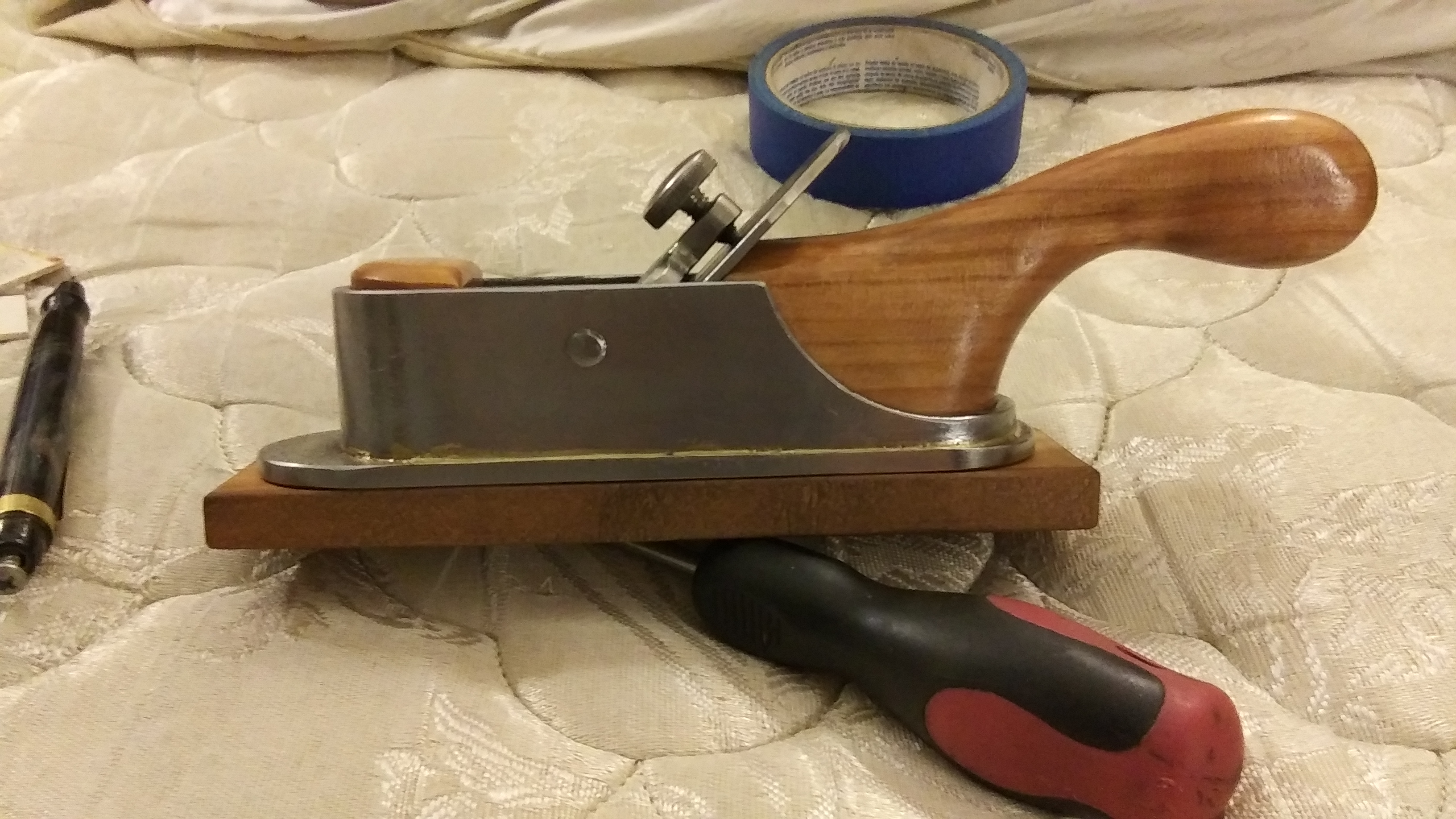

Then I laid out for the cross pin and drilled through the sides, and countersunk the holes. I then took the lever cap and found the position of the pin where I wanted it to be, laid it out, then took the angle grinder to the top face of it to cut a shallow groove across it. Took it to the shop and used a 1/4" round file to file the angle grinder groove open, just going down till it cleaned the groove up and the pin sit in it nicely. I had to go back and adjust it a little bit, but it was pretty close the first time. The thumbscrew/knob was cut down to length and end was ground into a cone shape, and pin was riveted in.
You can see why I wanted to shape the infill and lever cap and everything the way I did, that way the back of the knob's thread pushed on the infill just at the top of the plane body, and not above it, which would cause the blade to bow. Doing it that way makes for the most secure setup for clamping the blades in place, while keeping them nice and straight and against the mouths of the bottoms. If they had been bowed, then it might not be held that well and can slide up in use, and also could actually cause the blades to chatter in the cut, causing all kinds of wierd surface defects/problems.

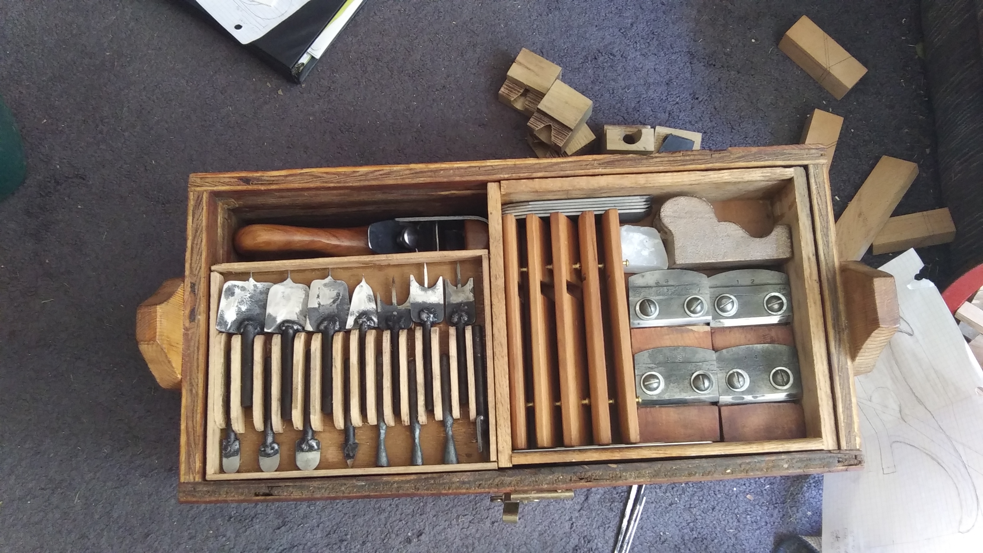

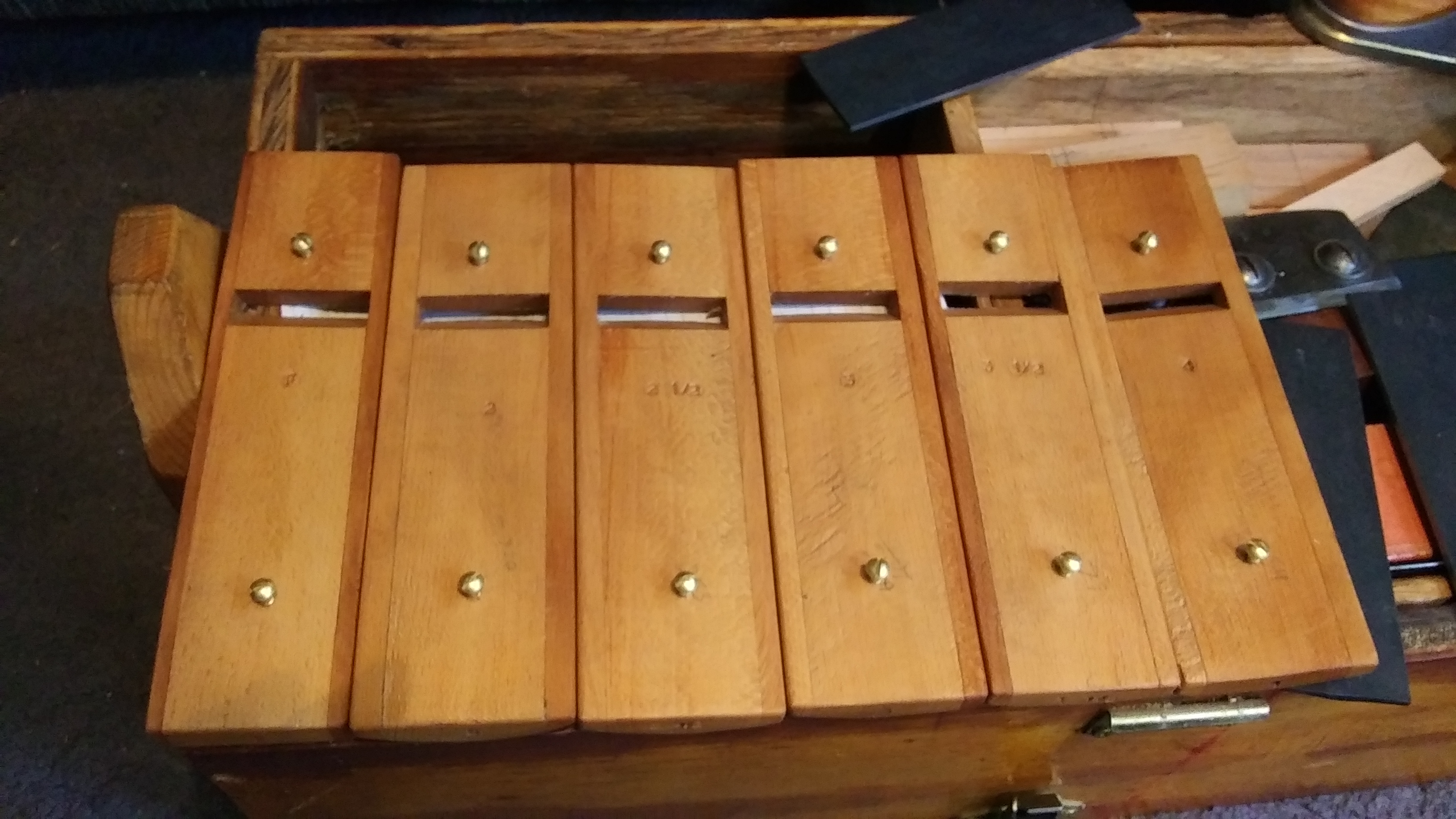

Finally some real pics of the plane showing what it looks like in the light, rather than the barely lit pics I had before, lol.
Also a pipe plane family picture, lol.
And finally at home where it belongs, in the toolbox.
I can say that it's officially all done.
