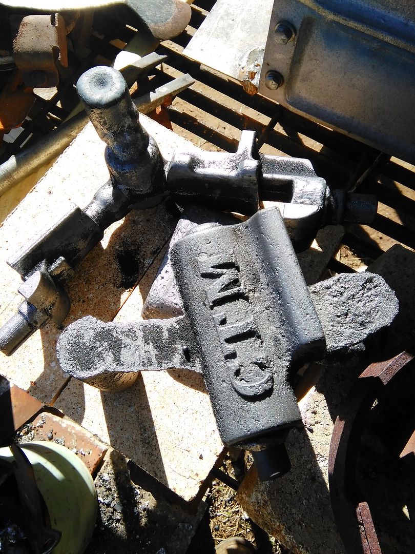

That impression looks great Davedallen wrote:scratched around on the letter with a wood chisel some this morning and finally got a decent pull on the initals on this pattern.
its not as good as I would like, but hey we take what we're given, this part has been a pretty big pain in the butt to do but I probably caused a lot of the problems myseld by not trying something different sooner.
Anyway its all rammed up, waiting on the sun to come up and the neighbors to get out of bed so I can fire up and cast it again, hopefully I'll get a good part.
weather man took the day off so it was nice and calm this morning,
fired up and melted around 20 pounds of iron and poured the two molds that I rammed up yesterday.
One came out looking pretty good
This little vies pattern came out great.
The other better but not good enough to hand off to someone else and say that I did it, so get to do it over again, initals came out pretty good thou.

Pour from yesterday
Looked like it poured well, Dallen. Look'n forward to see'n the result.
