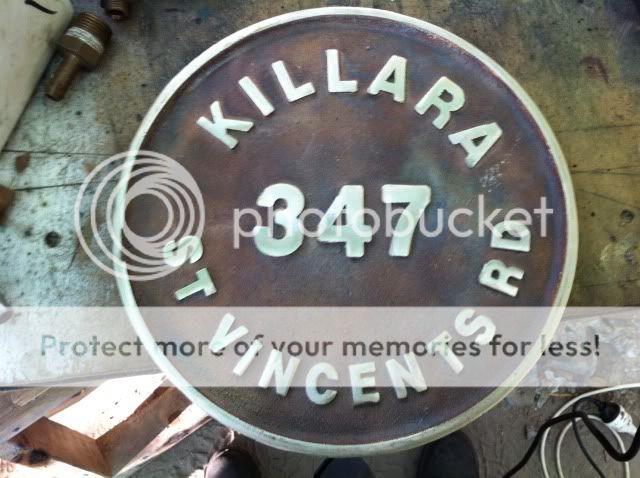

I finally got the plaque cast :D
Re: My first bronze casting
Looks very good, Mike... congrats!! :D That patina didn't turn out bad at all... I'm surprised. One thing to remember, wash that piece (after you've gotten the color dark as you want) and wash it a few times with detergent to ensure no further patina reaction is occuring. Then take a block of flat wood, tape a piece of 180 grit sand paper to it, then burnish off the high points (letering and border) in a nice smooth, even vertical, or horizontal pattern so the visual is consistant. Wash it once more, gently, to remove any micro grits, bake it at 250 degrees for about 15 minutes, pull it out, set it up where you're going to paint it then coat the entire piece with a semi gloss CLEAR acrylic spray paint. She will think you bought it special ordered through the catelog :D

I don't know why but the photo keeps come up upside down, anyway it still needs a clear coat
Mike, how did you apply that fertilizer? Did you merely spread it on the bronze or did you mix the fertilizer in water and immerse the plaque in the solution? The best way to obtain the deepest brown color with sulfur is to mix it as a strong solution with water then heat both, the solution and the plaque, and immerse the plaque and let it set for an hour or so.
What I'm also noticing with your picture is that there is a hint of green in the patina. That's no doubt due to some amonia nitrate in with the fertilizer. One way to get bronze to turn verde green is to soak sawdust in amonia then bury your bronze in the sawdust and cover it with an air tight lid. Allow it to set over night, or up to a week per your preference on color.
Your plaque looks great, though... WELL DONE! :D

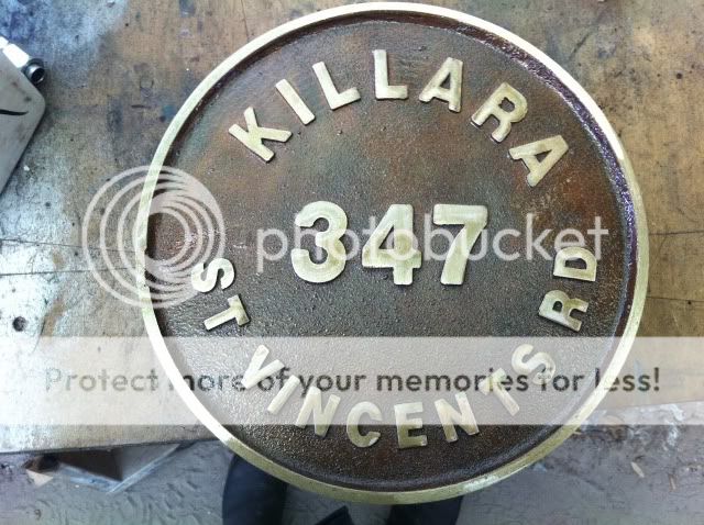

I put the fert in a spray bottle and gave it a good shake, I then heated the plaque with a gas torch and sprayed the mixture onto the plaque, heated again and sprayed it , i did that maybe 6 or more times, it left a white powder on the plaque so I just washed that off and BINGO all done. next time I may try immersing the whole plaque in a solution bath and see how I get on
Photo is the plaque with 3 coats of clear
I have some pieces of plaque that was a failed or learning experience casting, I'll use one piece for and experiment with the saw dust :D
