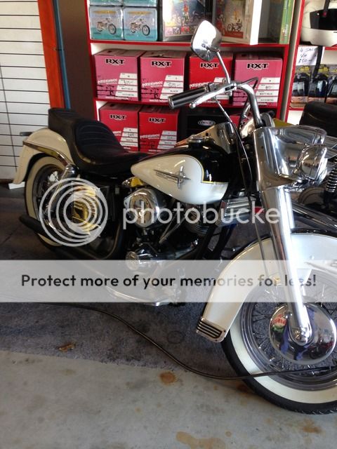

Speaking of old shovels this 1970 Police Special was in a bike shop that I drop in to every now and then for a bit of a chat
