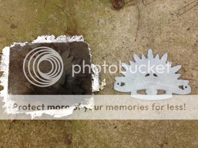

I got a little careless the other day and didn't vent a casting even tho I knew my sand was just a bit damper then I would normal have, I forgot to vent and got my first steam explosion, man did that ever get my attention, even tho I clamp my molds the metal blew out from between the cope and drag, plus it shot out the sprue. Photo 1 shows the part I was casting plus the result Luckily I always wear a leather apron and leather leggings, leggings took the brunt of the metal as can be seen in photo 2, the mesh face shield that I use has strip of metal about two inches long and about a 1/4 inch wide at about where my cheek would be, but no burns on me, it was a very lucky escape and lessons learnt

Aluminium or Brass? Either way it would have hurt! You can take a flame to the pattern before you close it up to dry out the surface, that may have helped.

Jammer wrote:Aluminium or Brass? Either way it would have hurt! You can take a flame to the pattern before you close it up to dry out the surface, that may have helped.

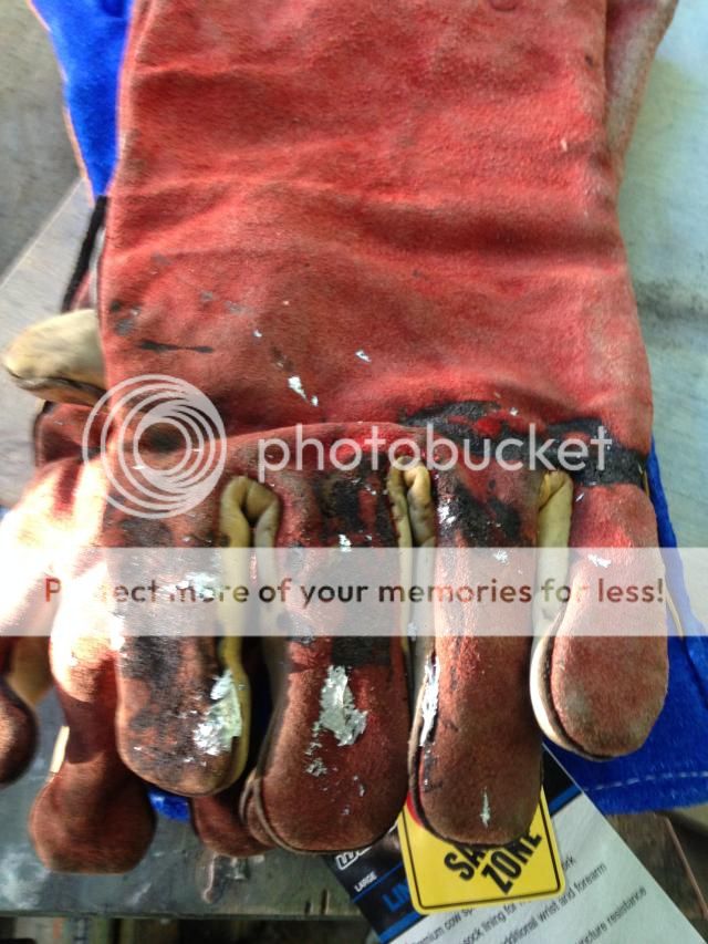

It was Aluminum Jerry. Today I went to do some welding and noticed this on the back of the gloves, which I use when casting, I could have been in a heap of pain :shock:

yep that's what gloves are for, keeping hot shit of the backs of your fingers and sometimes the palms of your hands
Be glad that you had them on. and be even glader that the stuff didn't get inside with you
