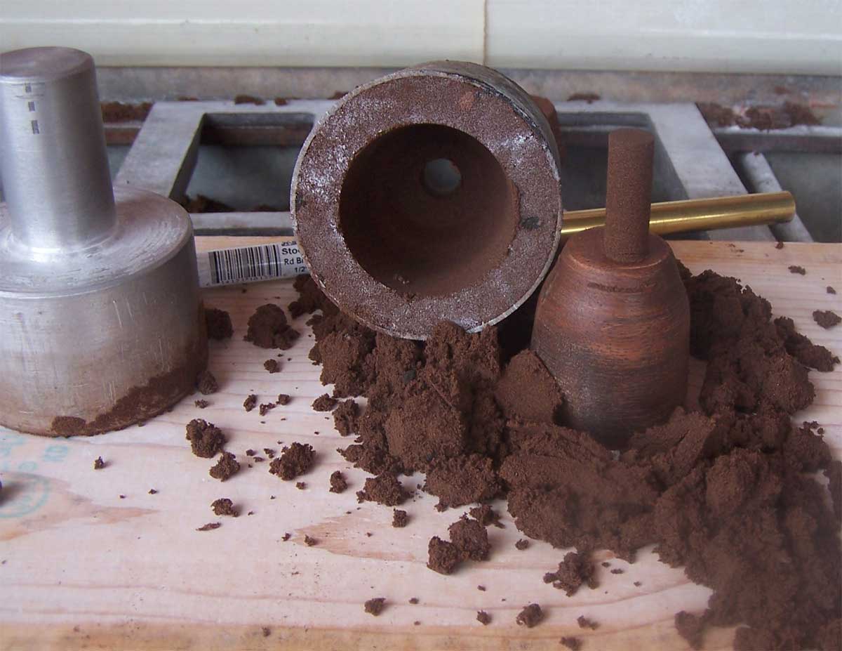

Made a small cone shaped pattern and a tool for pressing the sand in around it. I think I will make more of a cone but really this works great. Using a 1/2" piece of brass tubing from the hardware store it makes a choke that works pretty good for pouring most of the stuff I do.

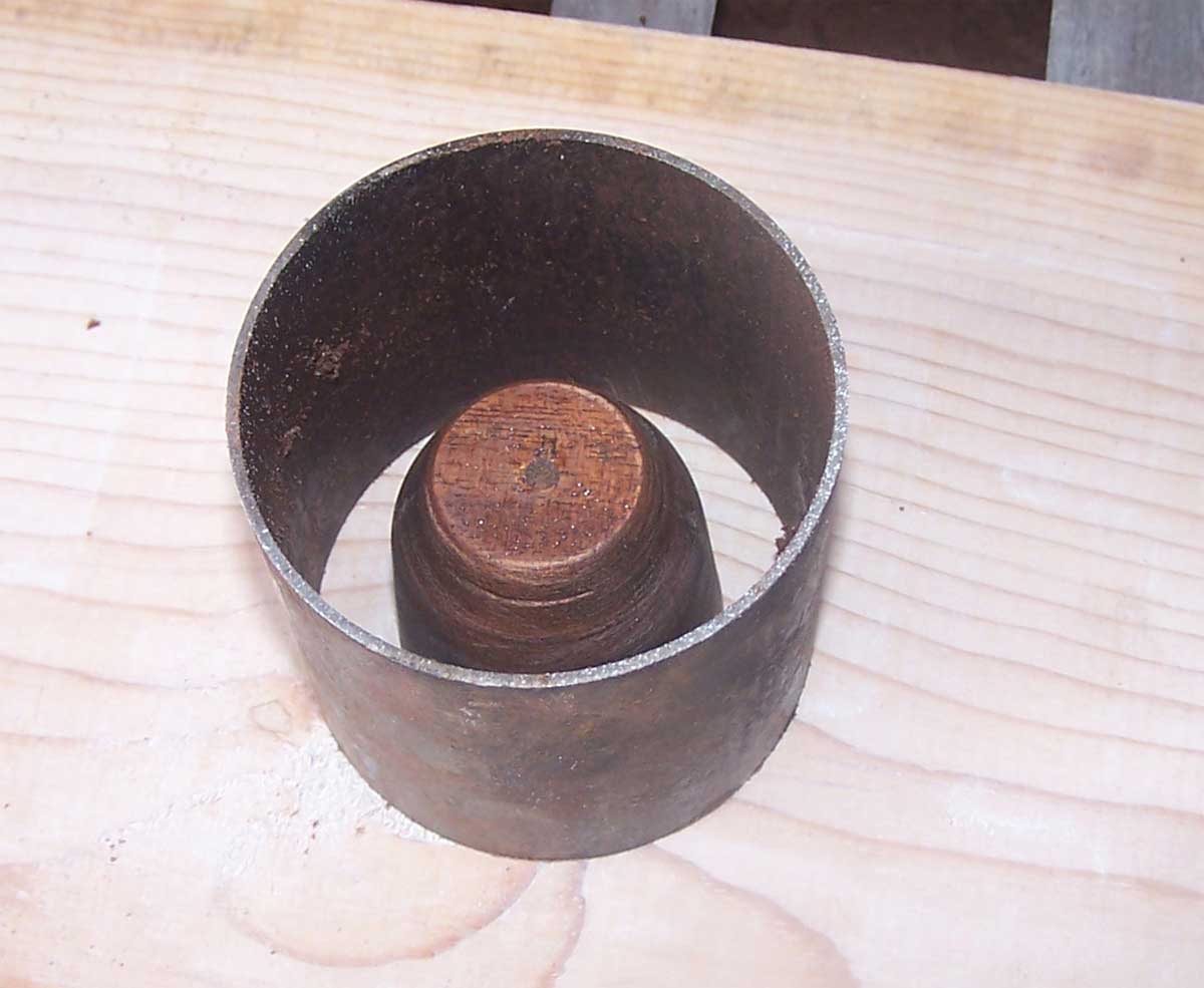

Pattern for the cup inside of a 3" tall piece of 3" thin wall pipe.

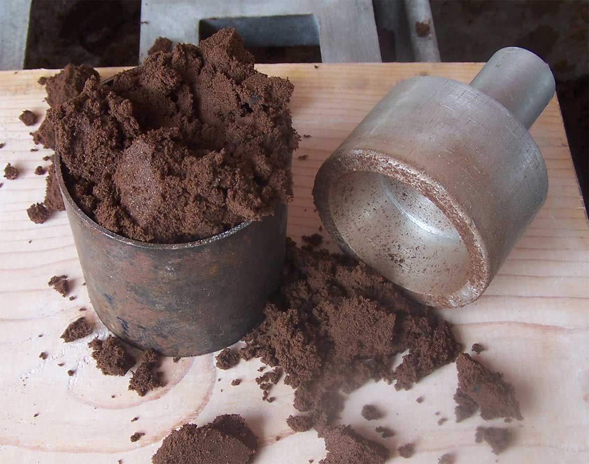

Toss in a little sand to pack down around the pattern.
Packed in with a little tool I made, just knock it on the side of the molding bin to clean it out.

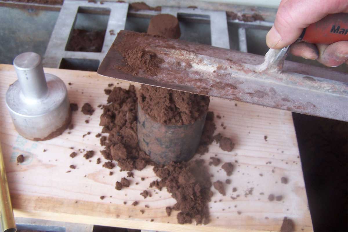

Topping up with a quick smash from the trowel. I like to leave the sand a little high from the pipe so it can get a real good bond to the sand in the mold.

And a finished cup ready to go, while pouring I keep the cup about half full and when it starts to rise I know the mold is full. There is enough room in the cup to catch it before it over fills. Since I have been using these I have not had an overflow at all. They also work great for a little extra head pressure, just make sure to add plenty of weight to the mold.
