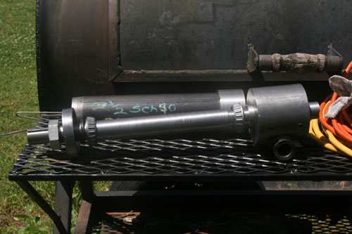

I am in the process of building a Muller based on the Steve C's. book, I'm not the first nor will I be the last, I just think that it is an easy piece of equipment too build, the design is simple, the parts are few, and yes there is some machining involved. This is where I started my Muller, no reason to build a big ole heavy tub and not be able to make the parts inside go around and around. So I started with the Drive Shaft, besides I already had the pipe for the tube piece of 24" .375 wall. and the plate for the floor was just a short drive away at the Junk Yard, and the method of power is the 1 HP motor that I took off my 12X36 lathe when I repowered it with a 3 phase motor and VFD.
Anyway for those that like pictures, heres the first of the ones that I will post to keep everyone entertained as I build my muller.
