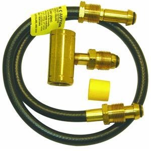

but I'm having trouble justifying the cost. the real question here, does propane need to be piped through brass/copper, black iron pipe would be much cheaper, and all it would be was a tee, two couplings, and a couple of nipples, all the brass compression fitting s for tanks, I already havePropane parts material

use propane rated hose with 1/4 inch female fittings, that way your are not bending the copper tubing inbetween the cylinders and instead of that high dollar tee fitting I see, you can use a regular 1/4 steel high pressure (IE hydrulic tee), move the tank nipple thats in the regulator to the end of the hose and use a Three inch nipple to install the tee onto the regulator. Actually you can get it all at Home Depot if you use a Brass Tee from the Plumbing department and the hose from the Lawn an Garden.

dallen wrote:use propane rated hose with 1/4 inch female fittings, .
That would put a hose before the regulator, what is the pressure of propane coming out of a cylinder? the last thing I want is a propane hose whipping about with a flame blowing off the end like a torch.

pressure in a propane tank is around 100 to 125 psi on a hot day, all of your propane hose will be rated around 300 psi, or instead of using rubber hose if you have a high pressure braded hose laying around that would work also.

As far as plumbing them, Dont see any reason why you could not use black iron pipe to make a manifold, galvanized is not used because the coating can flake and plug orifices on appliances.

I've been thinking about this some more, a two tank set-up like this would be pretty easy to put together using scavenged and/or low cost parts. POL fittings like the one below can be scavenged from discarded barbeques, you need two, one of them can come from your regulator you're currently using, everything else needed you should be able to get for any good hardware store, a 12" long piece of 1/4" pipe, brass is preferred but black iron will do, a brass 1/4" tee, a 1/4" brass coupling and a 1/4" brass nipple.
