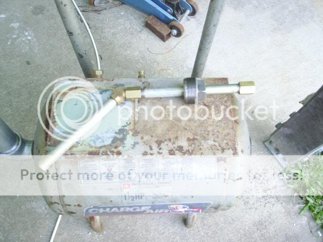

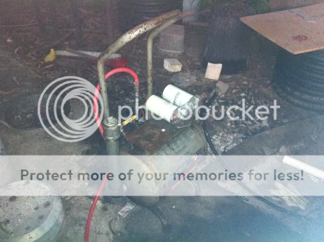

Hi Shadow, Sorry I'm no help for your pump issue, but what I did was I got and old compressor tank
ts an old compressor tank with remote filter brackets on top to filter the oil

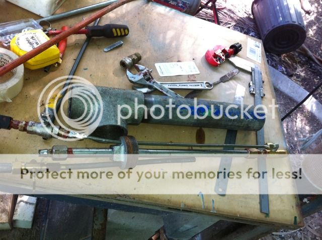

To pick up the oil I removed the bung from the end, drilled it to size and welded in a piece of hydraulic oil tube which I had ran a tread on each end to suite the fittings, one fitting has a 45 deg elbow to put the tube near the bottom to pick up the oil

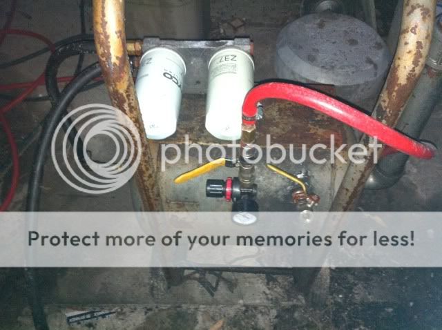

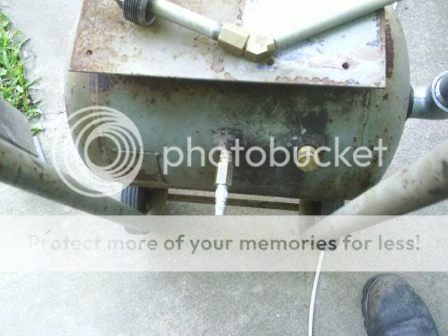

You can see the quick release air fitting, I removed it and put a regulator in and thats were I pressurize the tank, the bung on the right was removed and a ball valve was added to release pressure
