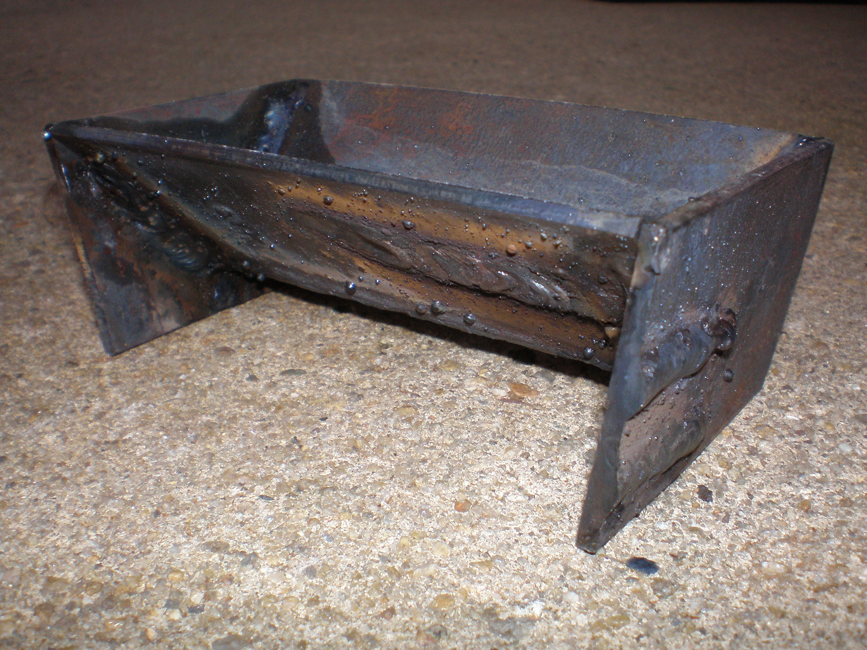

I brought home some welding samples from kids in metal shop. Many of them were flat on one side, so I figured I could do something with them.
The result was an ingot mold. I currently use a cast iron cornbread tray that makes corn on the cob shaped ingots. My crucible fills it perfectly, but since I'm making a bigger pot, I'll soon need more room.
Its deceivingly large in the photo. The real dimensions are about 5x2.5"
Bill
Re: New Ingot Mold
Looks good Bill, the steel appears nice and thick which will keep it from warping and I see you put a nice angle on the ends which will help in dumping it.
