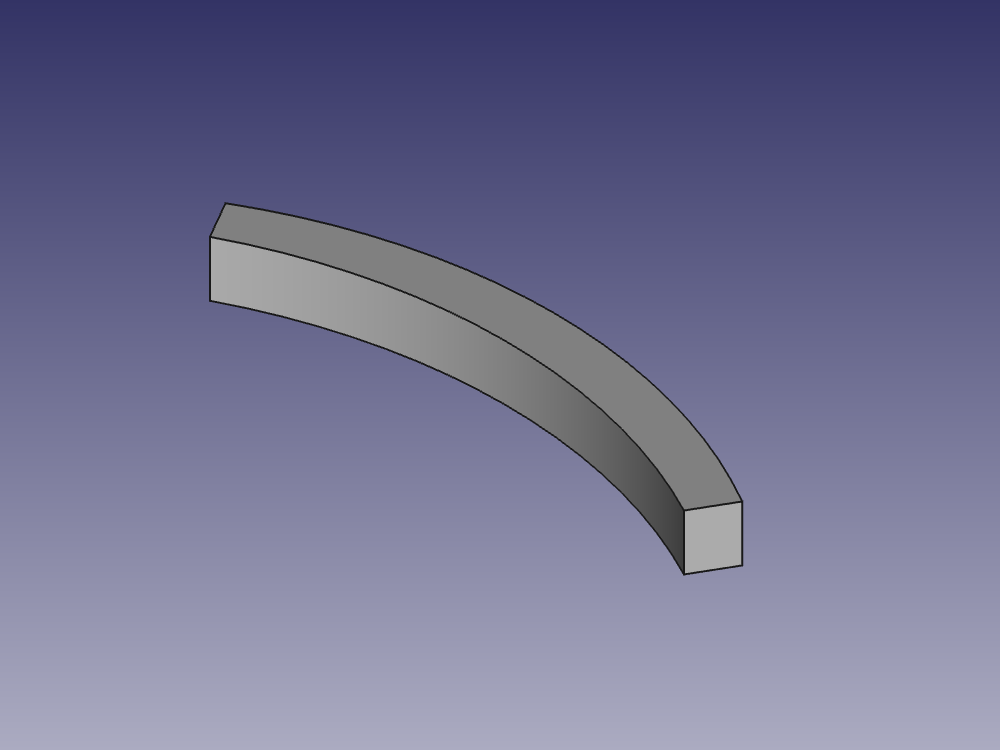

I just need the part drawn. I can draw it in Illustrator and export it, but I'm lost in FreeCAD and Fusion360.
I have a CNC to cut the pieces, just can't program... Thanks!

Doing the drawings is my main problem. I've tried to do stuff in Fusion 360 and FreeCad and always end up pulling my hair out. cae2100 says he will teach me but we can't seem to get together for more than a couple hours. He's about 2 hours from me so by the time I drive over there, catch up and cast or forge something I've got to head back home.

Oh, what part do you need doodled up in freecad? I know the basics enough to make about any pattern I would need in freecad, but I can always doodle up what you need as long as it's not too insanely complicated, lol.

A segment. 7" long, 14" arc on outer and inner, .5" wide. with each end 30 degrees inward.
Might be easier if I supplied a pic...
I should be able to extrude the depth, but we can start with .75"
Thank you!
Thank you!
Re: I'm all discombobulated...
yea, that one's really simple, did you want draft on it in any direction or any other stuff done to it? To change the thickness of it, just double click on "pad", and you can change that there. Everything is symmetric to center line, so you should be able to change the dimensions to whatever you need without much effort. With 14" diameter on both inside and outside, the part is thicker in the middle, is that right, or is it supposed to be parallel all the way around? I made the 1/2" the thickest part in the middle, but I can change that so the ends are 1/2" instead.
Here's the file so far. Files are in the zip file at the bottom, if you need anything else done to it, just let me know. I also tossed in an STL file to cut it out on the cnc, just load the stl file into your cam software for the cnc and set up your paths and tooling, then youre good to go.
Edit: I dont know what I was thinking about measurements, but all is fixed now, so the stuff in the zip file should be good now.

cae awesome! Thank you!
Yes it will be thicker in the middle. Would prefer the ends to be .5" wide.
The thought behind both arcs being the same is that I hope it would cut down on cutting paths when I do multiples..
What do I owe you?
What do I owe you?
oh, give me a second and Ill modify it so the ends are 1/2" thick then.
All done, here's the new freecad file and STL file, ends are 1/2" thick, middle is a little thicker as you wanted it. And you really dont owe me anything, it only took a few mins at most to doodle up anyhow and I just did it up before I passed out for the night, lol.
