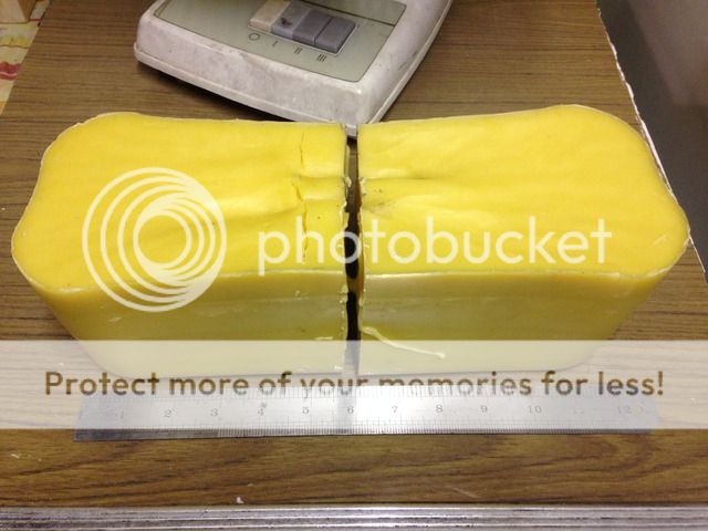

Dropped in to see a mate today who just happens to have a few bee hives, He asked if I wanted some bees wax, he walked inside his house and came back out with a tub of dirty wax and said I can have this but I'll need to melt and filter it. So after melting and filtering I ended up with a 3 KG (6.6lb)
I now need to ask, is there any difference between bees wax a commercial molding wax.
