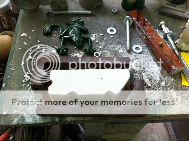

Core box mk 2

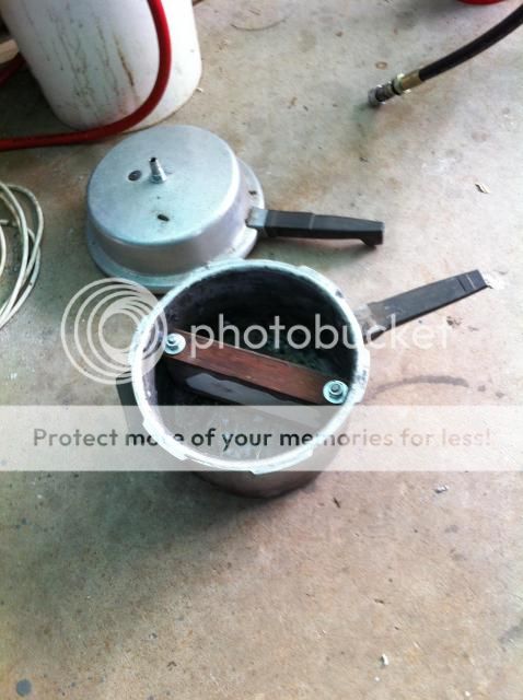

Tried the new core box today, I'm using a pressure cooker as a gas chamber to gas the core,

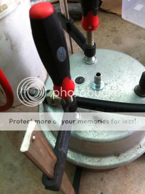

I added a quick release air fitting to the lid and to a co2 fire extinguisher hose
I then very carefully gassed the core

I see the frog's still keeping an eye on you Mike, Core looks good, nice job on the core box.

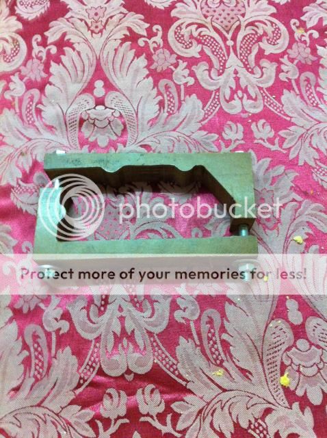

Casting turned out of, the two hole are were I had two flat head nails to hold the core in place, frog must of thought it was getting a bit cool and needed warming up he he.... Hope to try machining cooling fins tommorow

Did some machining on the mill today, I'm now waiting on a angle plate so I can machine the ends, plus a radius cutter so I can radius the boss's, the thick fins on the end will end up being removed when I machine the ends
