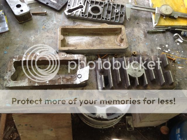

Made a few modifications on the sump extension, just a short video, apologizes for not explaining it all to well as I'm not to great at being in the movies ;) Patterns were cut on a CNC and they are made out of Kwila, the same timber that I sent over to Dave. all the patterns were made larger then needed but will be machined back to size after casting

Son pulled in today on a day off work, so I grabbed him to give a hand molding and pouring, this is the result
Re: New sump extension pattern
good looking castings, do you get many calls for this cover and sump?
Fins on the sump look really good, you may want to add a little height to that round spot in the middle of the cover so you can machine it off without hitting the fins and to take care of any shrinkage that may occur. Just a thought.
