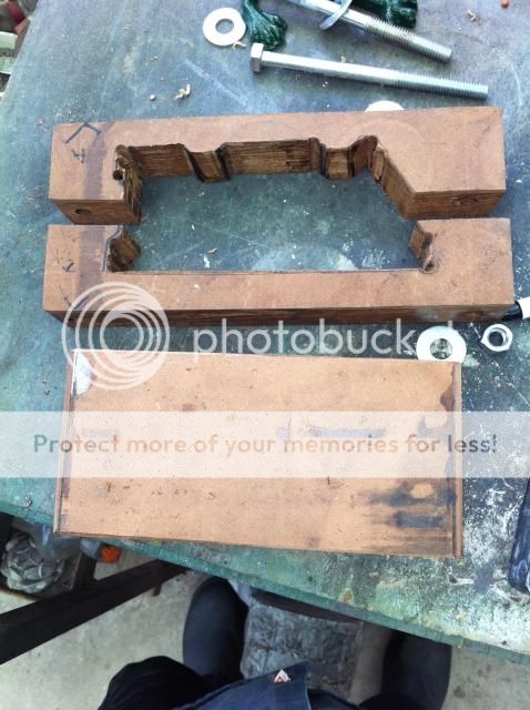

When ever I try picking up or moving something that has a bit of weight I end up injuring myself, so the alloy rocker cove that I'd planned on making has been put on the back burner because the flask full of sand will be way too heavy for me to move about, so untill I get some lifting arrangement set up it will have to wait. Soooo for now I'll do small stuff. I'll start on a new XS650 sump extension pattern (http://founddreaming.com/forum/viewtopic.php?f=32&t=243 The old one has seen its day so I had better get cracking. the old pattern was rather difficult to lift from the sand, so this time I'll make a core box
Bottom of the photo is the pattern, which still needs work, this extension will have cooling fins in the leading edge, so I'll leave groves on the pattern and finish on the mill with a ball mill when cast. top of the photo is the core box, and it still needs a lot of cleaning up

I'll be redoing the core box, that one looks like shit and there is three undercuts, so the next will be a three piece core box. Don't know if I'll get much done on it next week, with work commitments and a few other things that are happening.
