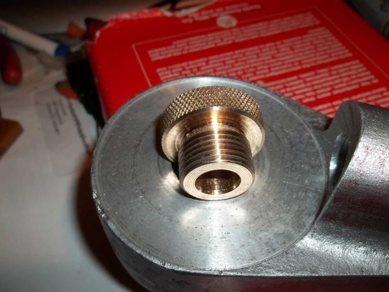

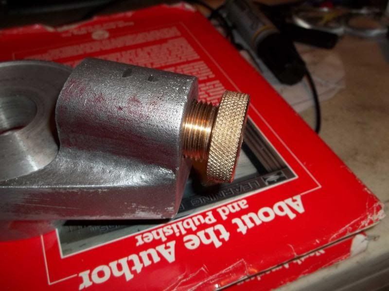

got to feeling like actually doing something on the shaper tonight so I made the brass retainer that will hold the pawl in place, I made it big and clunky as the original was still not sure about the exact shape, have been in contact with Fabber McGee in Fairbanks he said that he would get me some photos here pretty quick.
anyway photos of the brass, man do I so not like threading bearing bronze.
the knurl is off a little should of took a couple more thousands off of it.
