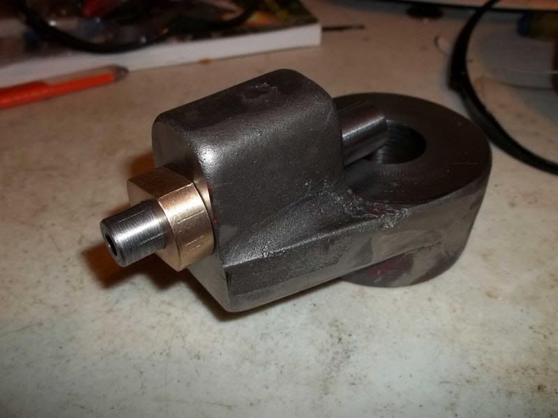

got a little more done on the new Cast Iron Ratchet this morning, but looks like I'm going to have to turn a new pin the one in the photo doesn't want to cooperate.

I am just about done with the new ratchet that I've been working on.
