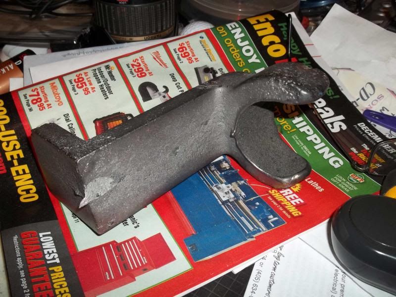

I'm thinking its slag that was the middle of the gate from the riser to the part. that was as close a picture as I could get.
the welding rod was throwed in right at the end of the melt, and the burner was shut off pretty quick after it was added. Metal was some of the better Iron that I've melted this year. mostly it was iron that I had already melted at some point in time. with one chunk of a bearing housing that I throwed in.
Oh yea almost forgot I left it in the sand for like and hour and a half before pulling it, the gating was cut off with a hacksaw.
I could of used the part but that wouldn't of solved the problems that I've been having, so I cut that chunk out to see what was in it, that part also was cut out with a hacksaw.
Jammer if you have any thoughts please post them. I've been doing a bunch of reading in the Cast Metals book, ok not a bunch but what there is on Gray Iron which isn't a lot. the copper seems to really help. The silicon that I throwed in was the 99.5 stuff from MM, hoping to melt and pour again on monday when I have some help. will use the FerroSil, will try to keep things the same except for the change in Silicon to see what happens.

if the weather holds I hope to repour the same melt, I wrote the stuff down on the side of the muller, you might say its wrote in chalk instead od chisled in stone.
Anyway the welding rod is still in the curcible and if I pour I'll have some help to maybe hold the slag back I try to skim it off but its not like spooning the stuff off of aluminum. Just have to hope mother nature holds good.

I think I'm going to go get a back of courser sand and mix some in with what I been using the stuffs starting to get full of fine from parting dust and just general handling and with the cast iron I can stand to be a little courser so the castings don't look so slick. have to see what happens tomorrow.

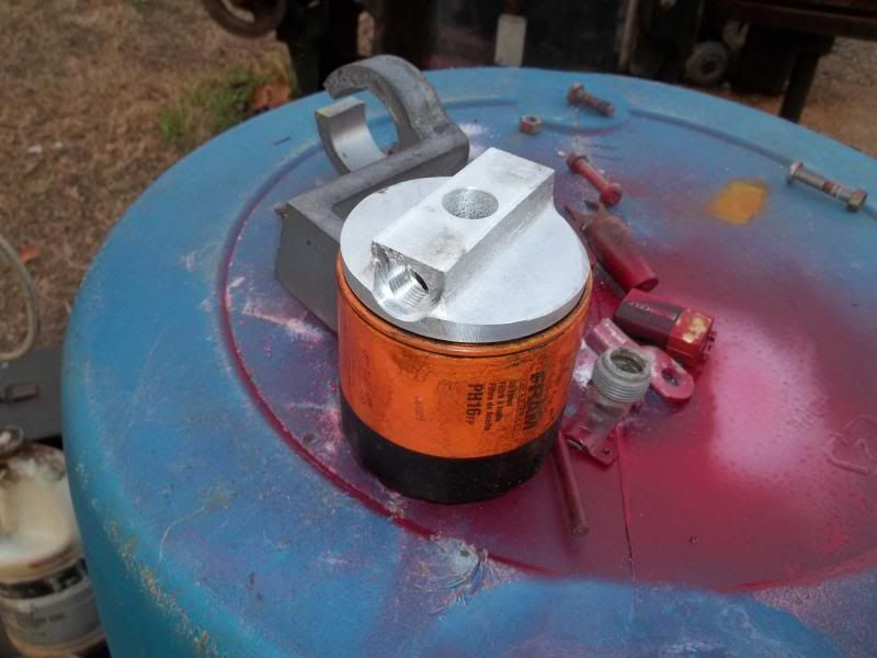

didn't do any iron work today, was too wet this morning, I did this afternoon make me a plate to mount a spin on oil filter on so I can filter my burner oil. and maybe use it to supply the nozzle with at a flow rate greater then the syphon nozzle will pull it. Still have to make a bolt that needs to be drilled and tapped for a pipe fitting.
Then the shop monster wanted pie, so I made him a sweet tater pie.
got in a little more time on the filter plate after making the pie for the shop monster, thinking now all I need is a pump which I have and some way to turn it which I plan on using a 1/2 inch drill I have for the moment.

well the pour didn't turn out so good today, I had two gates into the mold cavity and one of them froze which caused the problem that you see in the photo. metal seems from what little I've worked on it to be soft, it was left in the sand for a couple of hours after being poured (I had to go help a friend) anyway I had the same amount of melt in the crucible, used the same amount of Silicon, Copper, and the NiCast welding rod what was left in the crucible from the last melt.
