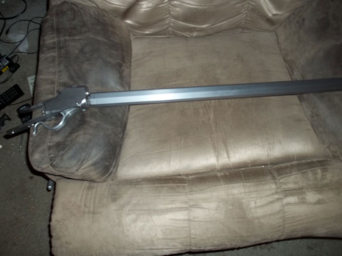

here's a really crappy photo of what me and the shop monster accomplished last night besides him wanting to sleep
