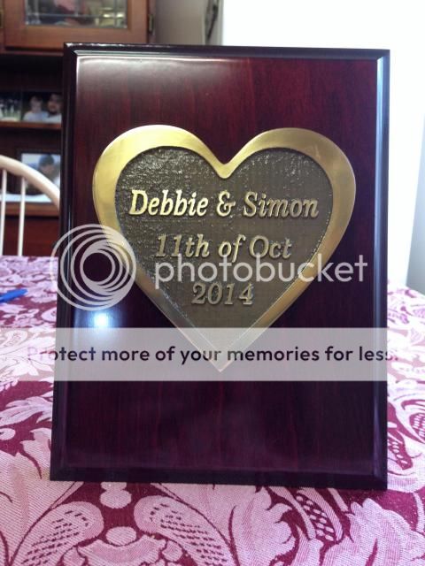

Received a request for another wedding plaque, just about all done :)

nice plaque

That looks great. That Simon sure gets around!! :) :lol: :roll:
Re: wedding plaque
Now that looks sharp and crisp... BEAUTIFUL cast!!... and finish, I might add. ;)
Re: wedding plaque
Thanks to everyone :D , I am having a few issues trying to get a nice scratch free surface. I started the polishing process starting with 80 grit wet and dry, and worked my way up to 1200 grit, I then use a buffing wheel with polishing soap using grey then brown, finishing with white, but I'm still getting fine scratches and they're pissing me off :(

Finely got it finished, the people that asked me to make it decided that they didn't want the horse shoe and wanted a darker timber. The timber is MDF thats been stained and coated with polyurethane. I took the plaque to a shop called Caboolture Presentation http://cabpp.com.au/ and they only charged me $11.50 to mount it, damn cheap if you ask me.... The owner asked if I can make another plaque so he can have a play and maybe get a better and nicer way of mounting them, its a husband and wife team and they are very easy to get along with

MDF??? How'd you get the wood grain effect? If you "made" that effect, that's TOP SHELF!! Beautiful job!! Would love to know your secret.
