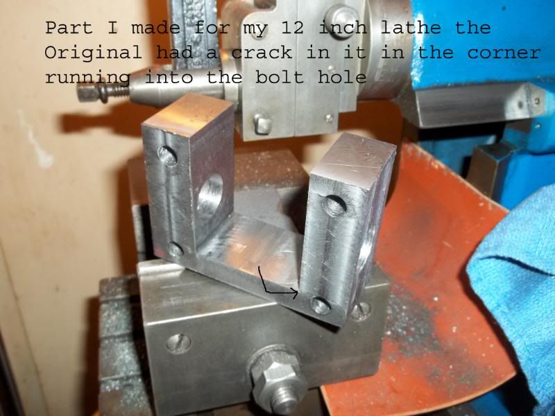

Well I mentioned it somewhere that I was having problems with my lathe, here is a picture of the replacement for the offending part

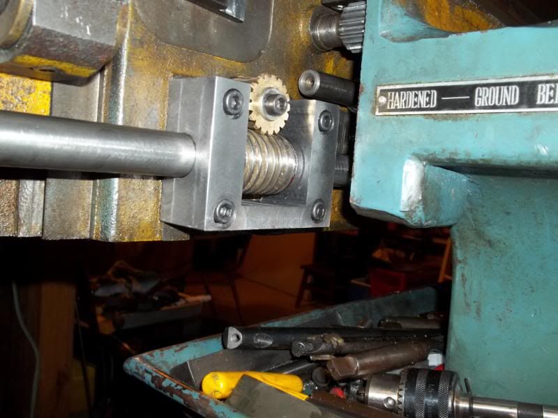

And one with it installed on the Apron
I had to pull the damn thing back out tonight and open it op about 5 thousands so it would stop binding on the sides,
