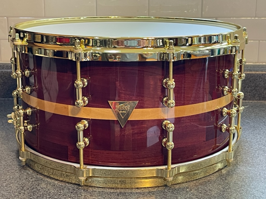

Finished off this Purpleheart segmented snare last May. Had the shell built when the customer backed out. Hung it from the light fixture in the dining room to let it patina. Maple ring in the middle for those keeping score. Anyhow...

Very nice!! Beautiful, how is the sound?

Amazing, beautiful finish there. Whats the diameter on that? Imagining those tiles are 4 or 6" so 16 to 24" is my guess.

The shell is 7.25" deep x 13.875" diameter with a .3125" wall thickness. Just zoomed in on the drum Harry. I did complete a couple of others, but they were ply shells with a wrap.
Jammer, I understand how life gets in the way. Certainly has here. Still sitting on a pile of broken bronze. I finished the drum with brush on Poly. I spin the shell as I finish it allowing the poly to self level. Centrifugically... lol. Then wet sand and buff.
