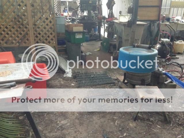

I've also decided to build a new burner, something simula to the quickie burner, I'll also be pouring a concrete apron about 4 mt x 2.5 mt. the orange tub on the left is the bunding the local council advised that I should buy, it will be installed to the right of the concrete tubs that stores my green sand, and the wash tubs that are currently there will be moved to were the bunding is currently sitting, all this will of cause will take time

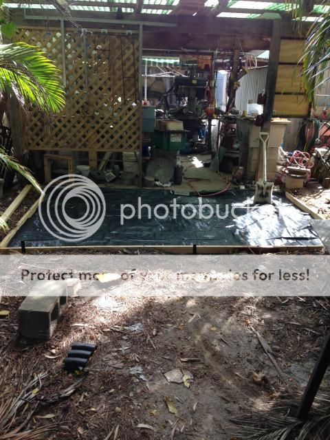

As previously stated I want to extend my concrete work area. I'm using a concrete that I've never used before, it has fiberglass fibers in it so no need for reinforcing mesh. this is it all set up ready to pour

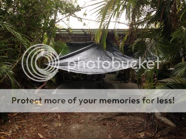

weather closed in so had to put a cover up

The framing job looks top notch, nice looking pair of Parrots never knew a bird that would pass up free meal.

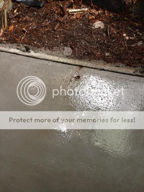

Thanks Dave, in a past life I was a concreter and cement renderer. Overnight rain did some slight damage, but I can live with it....Still raining here so nut much will be happening today

shame about the rain spots, get your burner working and you can melt them out. I know squat about concrete, if you want asphalt I can pretty much answer your questions.
