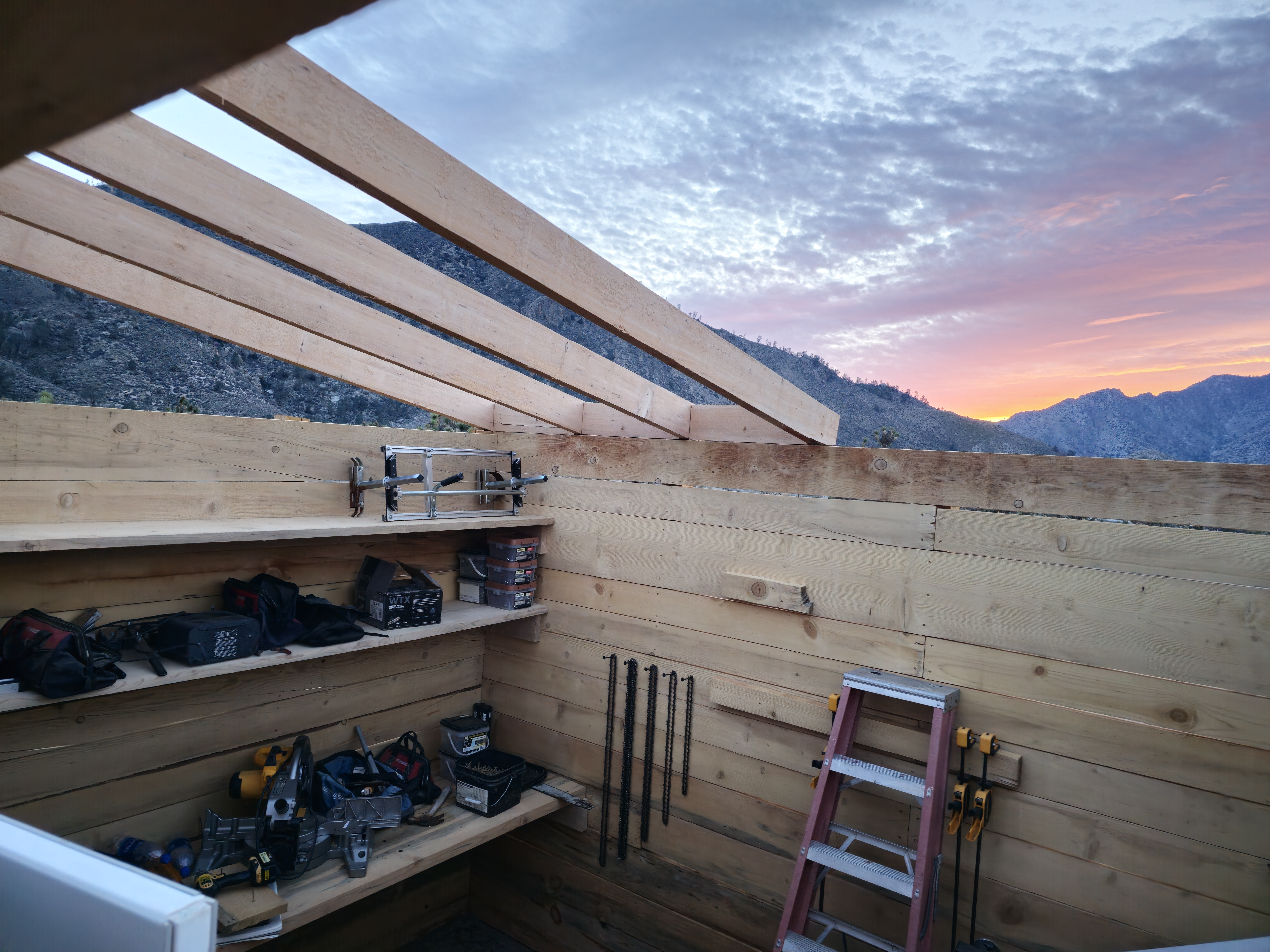

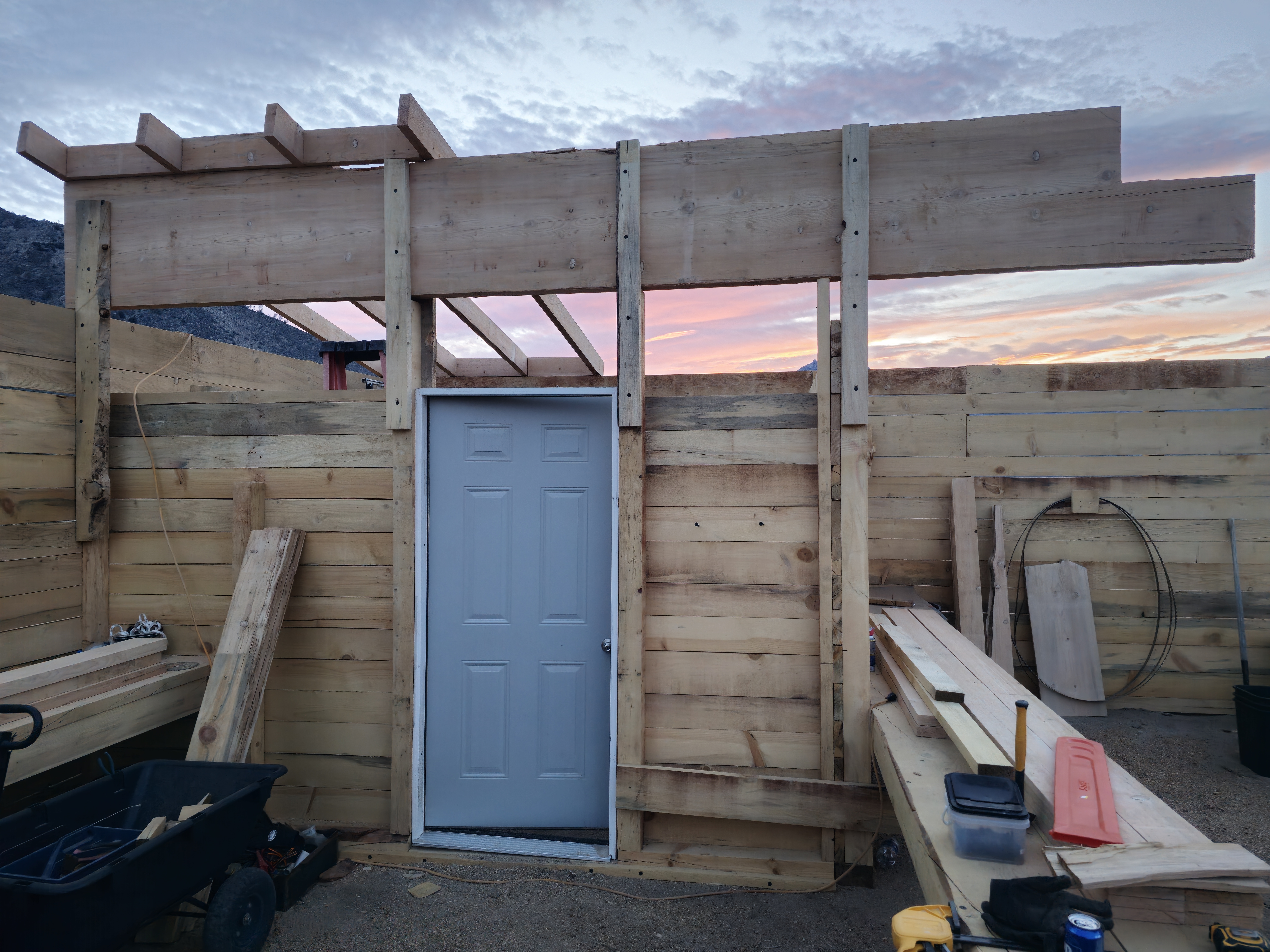

Putting the roof rafters in for the woodlot tool room. We are going to have weather tomorrow night and I have been humping it to try and get the room dried in before it hits. Of course I have had 3 people in the last two days hit me for firewood because its going to be cold and I do what I can to help folks but this has put me against the wall on finishing this project.
Worked late tonight and going to get out there early tomorrow and try to get 'r done.
That beam is a 17' long 4" x 24" 300lb plus hunk of wood. Doing things like this on your own takes careful planning and even so can be a real butt pucker when the wind comes up at the wrong time. Thinking there is a real shot at getting metal on the roof tomorrow. Still have to mill some 1" to go under the metal but have about 1/3rd of it done and a good sized cant on the mill ready to start lifting lumber from.
Those walls are all 1 1/2" thick lumber, the uprights 4" x 4" and its all sitting on 4" x 6" dunnage footing made as a sacrificial ground contact I can easily replace or eventually put in a concrete footing. The walls are on the windward side giving a break to this work area. We have crazy wind here, some of the highest average wind speeds in the nation.
