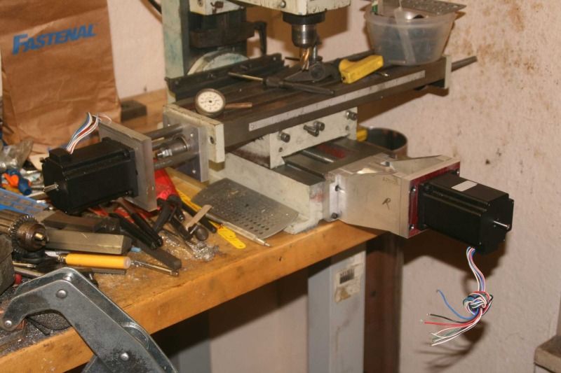

heres what I been messing with lately
Re: Got back to my CNC, Lots of Pics.
That looks great Dave :D
thanks MIke, its been a bit of work to carve out the mounts, I still have to figure out what I am going to do on the Z axis but its just a matter of time. I have been looking at some stuff on another site where a guy has done this to a mini mill and may use his setup as its pretty simple except that it uses a belt drive to drive a nut on a stationary screw to raise and lower the head.

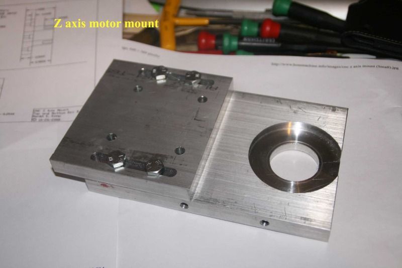

still making parts
heres a shot of the Z axis mount its only about half done the big plate mounts onto the top of the column the smaller plate has the motor mounted to it and the hole has the bearings and such for the acme screw that I am going to use.
