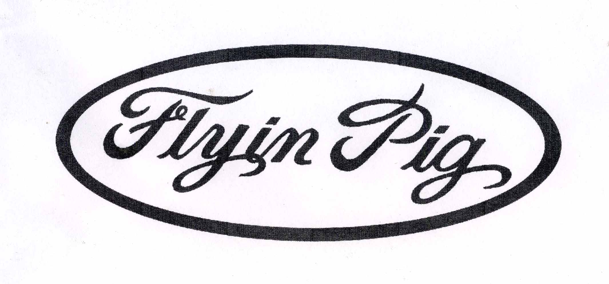

Still working on that but also on a plaque replicating the Ford oval logo also for his car.Here is the design...
A friend cut a pattern on his CNC router but it didn't turn out to my liking so I figured out another way to do it. First I made a reverse print then turned it upside down and poured about 1/8" of wax over it. After the wax set I turned the sandwich over and put it on a light box..
Next will use the "Hill Billy" CNC to cut the wax lettering,which will be attached to a wax oval,hopefully resulting in a pattern.

What would anyone think Don? Hehe... its freakin' hilarious and genius at the same time. If it works it works and there isnt much else to say.blindpig wrote:let me know what you think (and please be kind).
Don
Are the letters raised or recessed? Looking at it I am thinking raised would be best then you could paint the background blue and sand/polish off the letters. The other thing I thinking might be to drop the Pig to be able to make the Flyin' a little closer to the size/shape of Ford and maybe put a little pig down on the bottom rim.

You are right on Harry,it's going to have raised letters and ring around the edge and right again blue background. The idea origionally was to cover the stamped Ford logo on the model T radiator shell as my son's gona' put a big ole' honkin' Cheby V8 in it.
Sereindepity stepped in (us blind pigs count on that ya know)and it seems pouring the wax on to the paper print actually adheres them togeather (way cool),
cause after cutting out the lettering glue can be applied to the paper lettering and then attach them to the base oval before removing the surrounding wax,thus positioning the whole thing correctly.

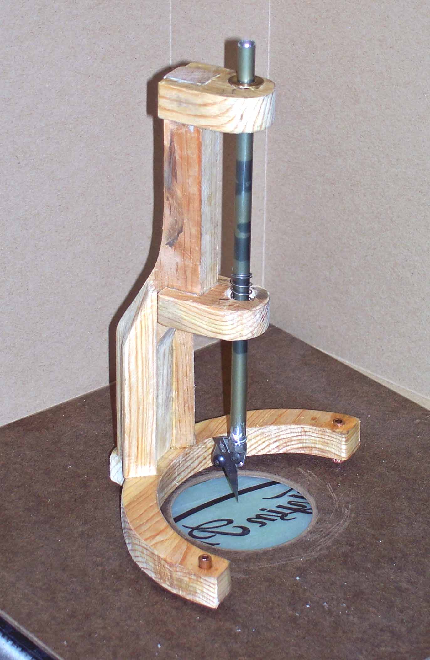

I've done a little experimenting with the" HBCNC" and discovered that the temperature of the wax I'm using makes a world of difference in the resulting pattern.Too warm and it sticks to the blade and sort of drags after it,too cool and it's very difficult to penetrate the wax,just right with my home blended wax seems to be around 75 degrees F. It's clear that more practice is going to be necessary to become proficent with it. I hate to admit it but a small pantograph with a Dremel tool attached is looming as a possible replacement for the "HBCNC"if the learning curve dosen't flatten out some....

OK! finally getting back to the HBCNC,I've put it it semi-retirement for now. Am having better luck with Hill Billy CNC II,which seems to working well.Actually it's a pantograph with a Dremel tool attached and operates with a 50% reduction between the pattern and the piece being created (allowing for an OOPs or two without ruining the piece)much better than HBCNC#1.
As soon as the "Flyin Pig" plaque is done ,thinking about some neat belt buckles,'cause this thing is gonna be goooooood for that type job.
Here's what it looks like... This blindpig has had a little trouble but he" IS "gonna find an acorn, LOL.

I really like what you have done there. Is the wood good and stiff? See I need to go the other way, I need to enlarge. so I would have to put the cutter where your stylus is. I was thinking metal, but wood might actually be better
