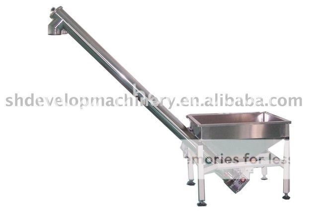

Something like this Frank, we use a similar set up at work for putting purge material into the extruders when we're starting them up or shutting them down
Re: Making things easier
Yep, I laid in bed last night envisioning something very similar to that before drift'n off to sleep. The only snag is space availability... I'd have to make both units attached closely to each other on a single framework and as low as possible so I can still have shelving space above it, or.... same configuration as stated but on wheels so it'll be mobile and I can park it out of the way when not in use. A 30x50 shop w/an office and compressor room, molding station, welding station, furnace operations, plus work benches, shelving, and a full gable end wall of shelving clear to eave height makes that shop a bit Closter phobic when projects are underway. I'm already leaning toward building a 50x30 ft. extension on the backside of the shop so I can separate my welding activities, modeling activities, sand molding and furnace operations. As it is (no different than what I had back 20 years ago) I'm already step'n over shit I've got strewn about to get to other necessary work, plus having to clean the entire shop after welding & grinding a project, then clean it again after sculpting/modeling a project, then clean it again after sand molding, then again after the foundry work. Then there's always the chore of clean up and clearing things out of the way when I got to work on my bike, 4 wheelers, or one of our vehicles. I may opt to build an awning and move my furnace operations outside which would reduce the misery of heat exhaustion when the temps are near triple digits. That alone would free up considerable space, but then I'd be having to carry molds much farther to fill. I would prefer to have everything under a roof, out of the weather, under one climate condition. If you visit any commercial art foundry operations you'll see they all separate each phase of operations into separate, isolated work areas portioned from one another by walls. For me to have my ideal work heaven I'd need two 30x50 shops connected to each other... but I can't afford another $30K expense, and the local govt. would rape me on permits and inspections especially after I squeaked the shop I did build past their approval when I took advantage of their error on what they printed on their "outbuilding permit" classification which literally gave no indication of any limitation in size. HAHAHA... They threw a fit I built what I did without scheduling for inspections at every phase and they intended to have me fined... but... the omission of size limitation on that permit I used gave me all I needed to take it to court and WIN, so they backed off and now my shop is grandfathered into their so-called ordinances. So now they're watching me like a hawk. That's why I'm thinking of what's considered as a "temporary storage structure" that's on footings rather than a foundation. They make a metal tubular frame garage/storage shed kit that's 24x30, all metal siding and roofing... no insulation. What opens the door for inspections and permits is when a permanent foundation is created. My shop sits atop a layer of basalt rock that's about 2ft beneath the surface. I can anchor footing attachments to that basalt and erect a storage unit attached to the back wall of my shop... I've already planned on that by framing in a second set of double bay doors at the mid wall of the back wall of my shop when I built that years ago. Two of those 24x30 kits will near equal the width of my 50 ft. shop and give me another 30 ft. work area (uh... storage space, that is, hahaha), and I can level and compact the ground then lay cast concrete tile pieces (3ft x 5ft) that will interlock to each other and prove to nosey authorities they're removable and not a permanent concrete slab. There are no limitations of wiring a storage unit on their books. HAHAHA... and those kits run about 5K each, and they each are simple to erect just like an erector set we played with when we were kids. Also, nowhere on their books does it say you can't "insulate" a storage structure. So, give it another year or two and I'll be expanding twice the size of the studio I have. I dearly LOOOOVE fuck'n with authorities and the RULES they put to print. HAHAHAHA....

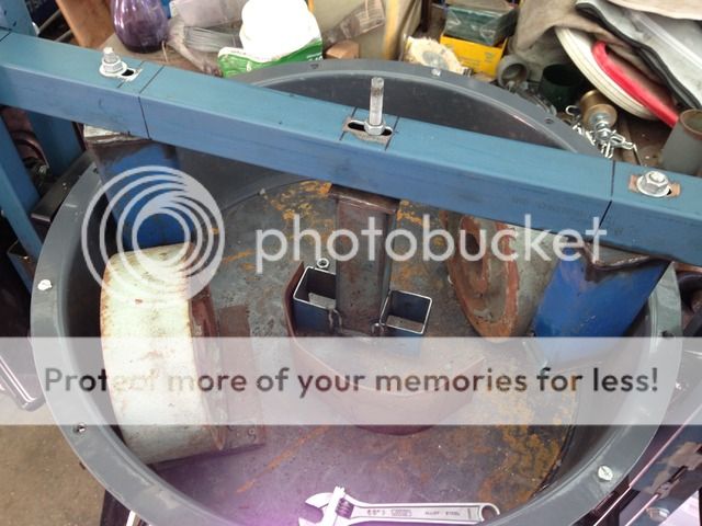

Did a little more on the muller today, drilled and cut adjustment slots on the main beam, plus I added a upright to carry the paddles, tomorrow I hope to add another paddle on the middle upright.. I'll also add something to break up the sand as it pass's under the wheels.....This is all coming along rather slowly at the moment
