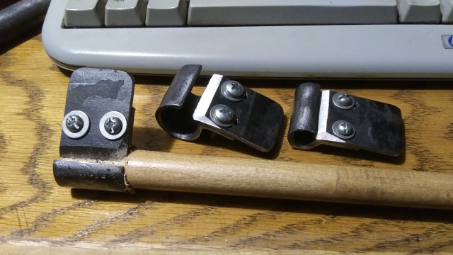

The other thing is that as you know, I made those tapering planes up a while back and wanted to make some sort of dowel making planes to turn my scraps into dowels, rather than having to turn all of it by hand on the lathe, so I had some wooden blocks that I tried making the rounding planes/dowel making planes from, but it was a complete failure. I had cut the mouth too low and it just failed completely.

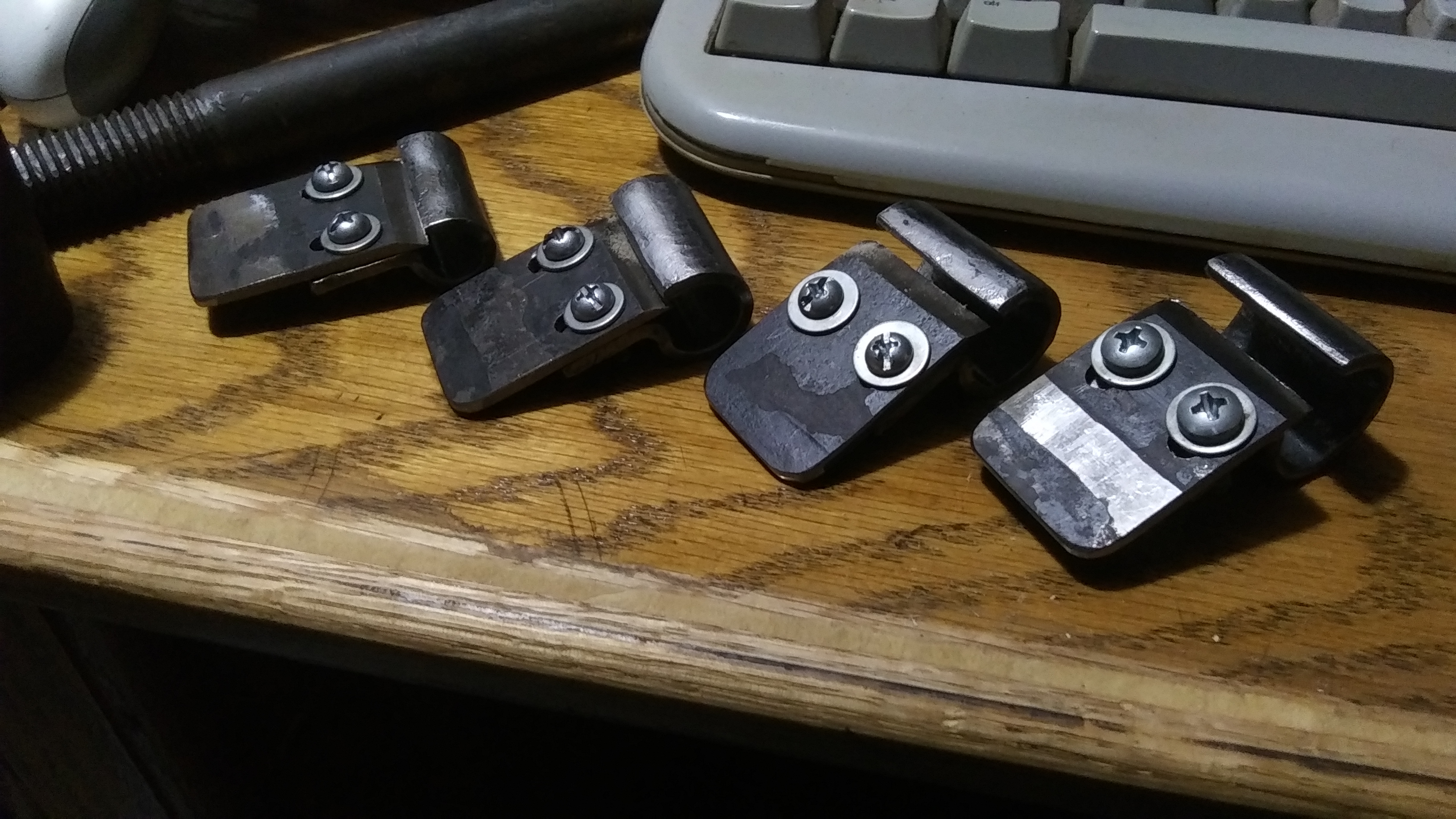

I was messing with some stuff and made up these instead. They're just made of mild steel that I had laying around, but they work pretty well. The blades are bed frame as usual.

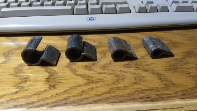

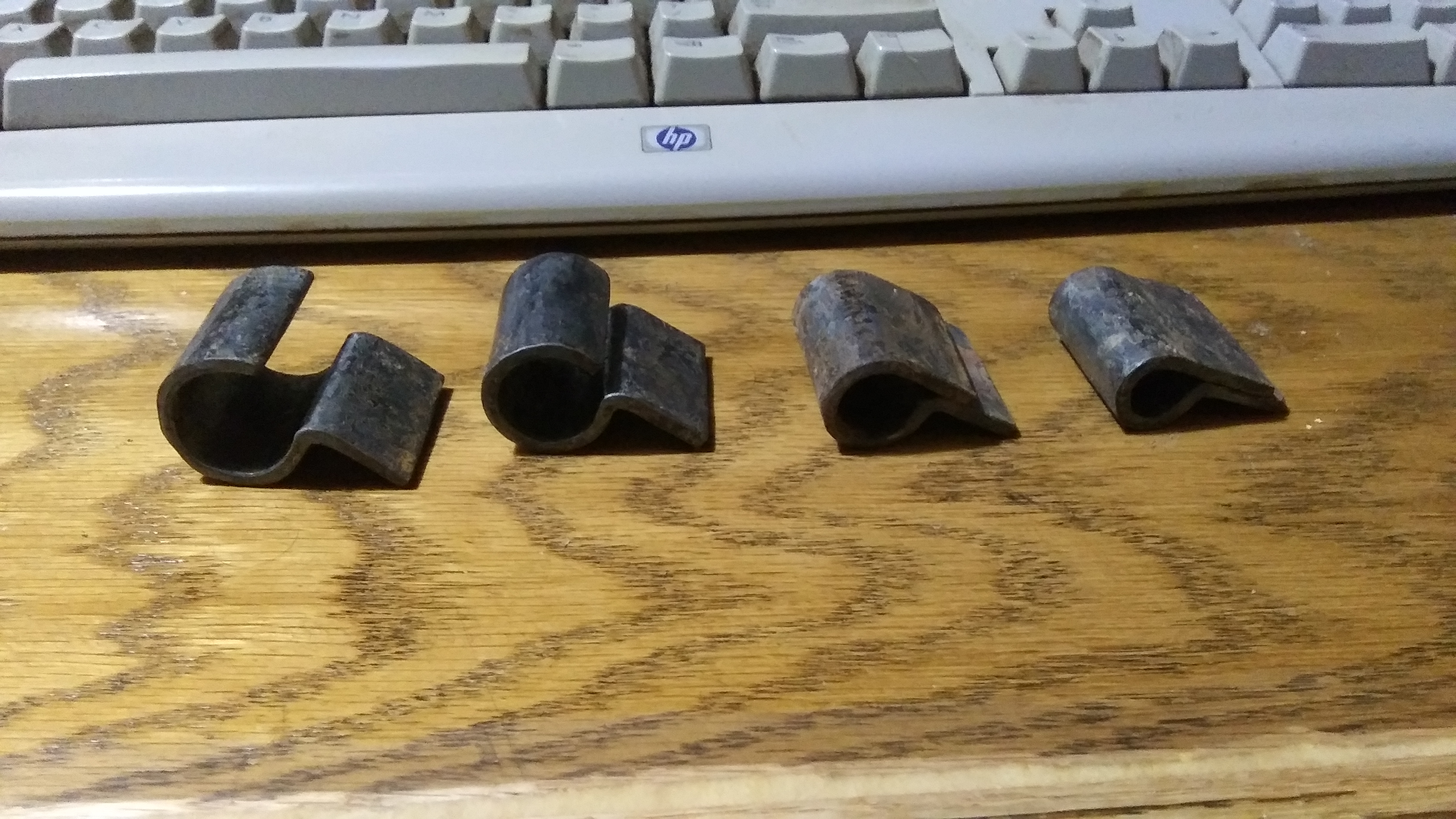

They were rolled up, cut up to create the mouth in them, and they were drilled and tapped for #10-24. After that, I made some bed frame blades and got those all machined up and ground to profile.
Thats about it, now I can take the scraps from the table saw and turn them into wooden dowels, and when I need one, I can just grab one, use it in the tapering planes for a post/boss/stand off, cut that off, glue it into the pattern, and I can toss the rest of the dowel back in the stock rack. Since I have to turn the stuff on the lathe between centers, I have no chuck to re-chuck stuff up, I end up with alot of waste if I try turning the stuff on the lathe. These solve the problem.
Those look pretty cool. Useful if you need a lot of dowels. Are you bale to use them on a hardwood? I saw your video and have subscribed to you on Odysee and Kick. I didn't see anywhere to post a comment.
Yea, I wanted to use the offcuts from the table saw and such, just knock the corners down quickly, then run it through those to create the dowel rods, then I can use those for the foundry patterns. Around here, you can only get really coarse grain beech or oak dowel rods, and neither are good for patterns really, so I wanted to make them from cherry, since I already have the offcuts here for free. Then in the middle of winter when Im working on patterns, I dont have to run out to the garage to try to turn a few short pieces, when I can just grab a dowel rod and run it through the tapering planes after marking it for length, and then cut it off to length for where it needs to go. Ive had a few situations where I tried mixing woods before on a pattern and shrinkage and seasonal movement caused it to pull so hard that it actually bowed a pattern, so I try to keep with the same type of wood, usually from the same boards, if I can.
