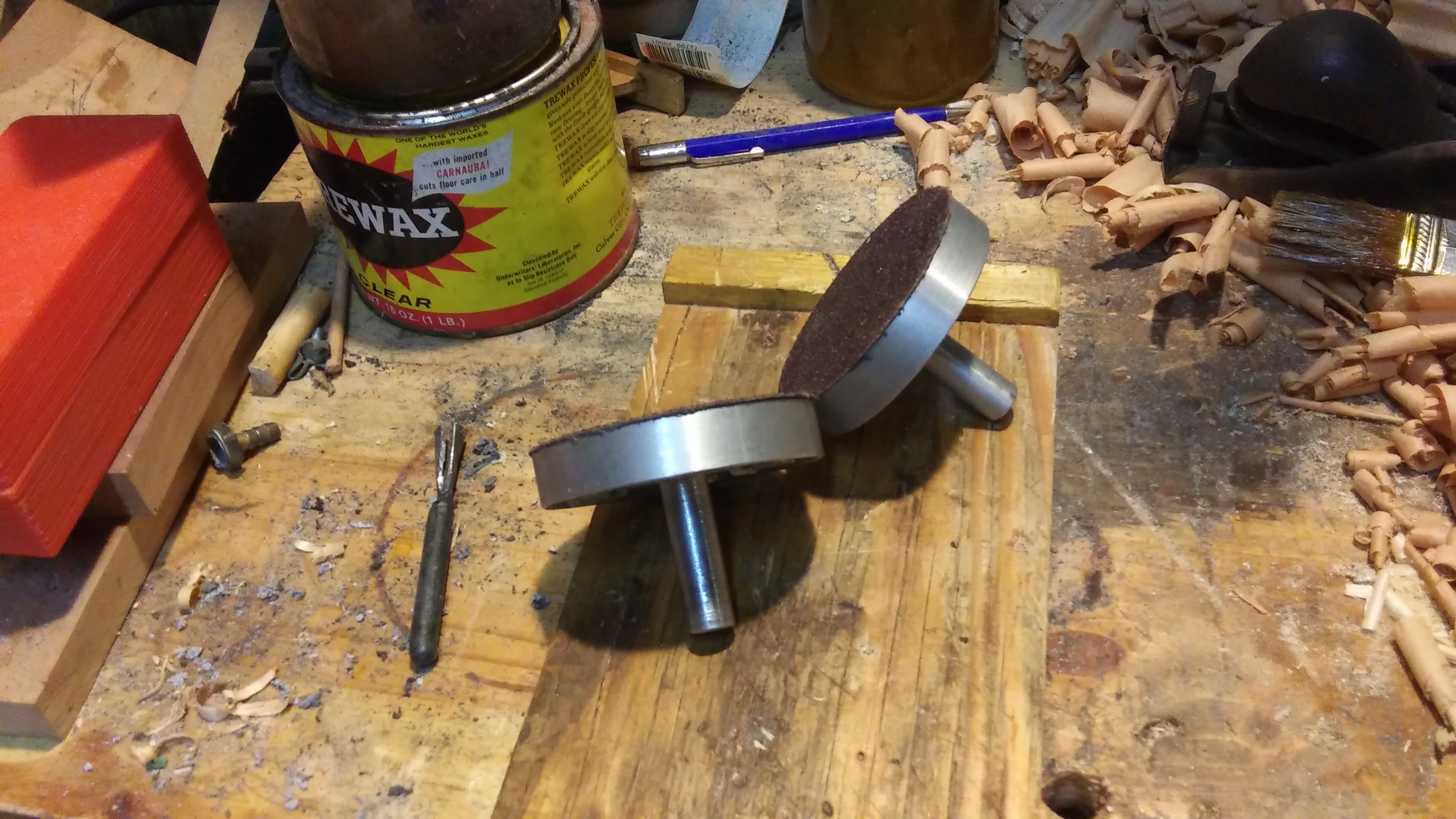

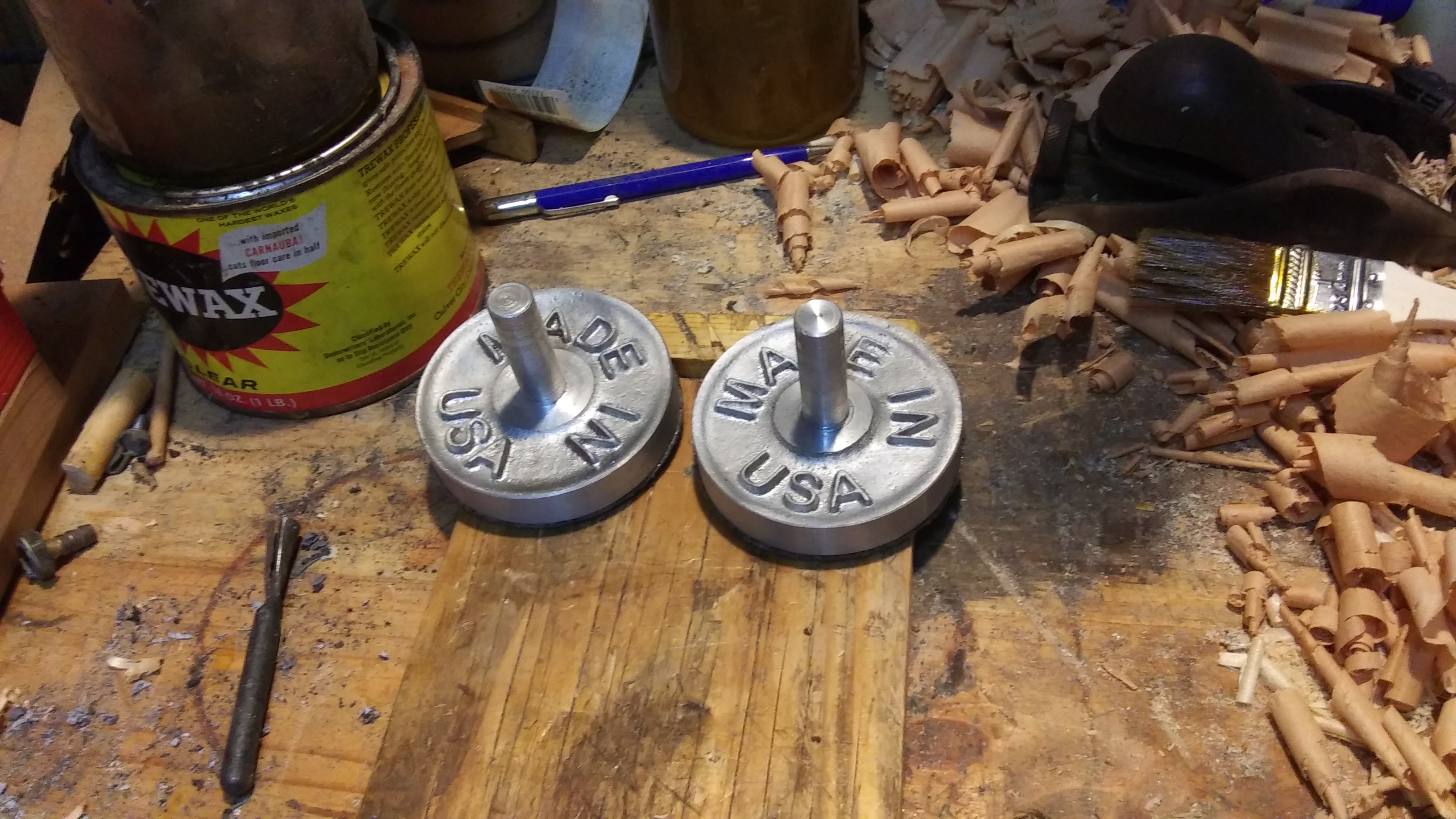

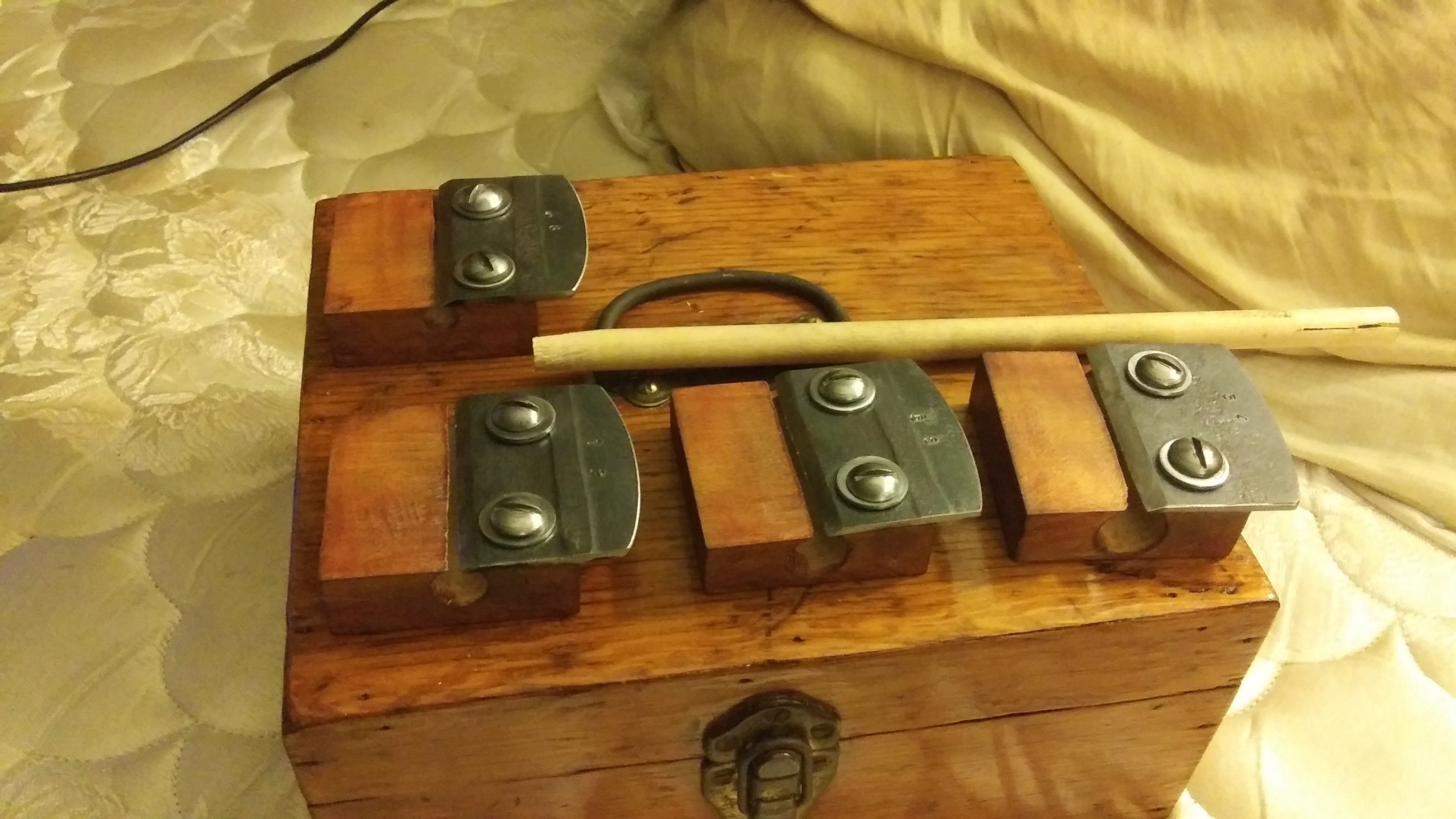

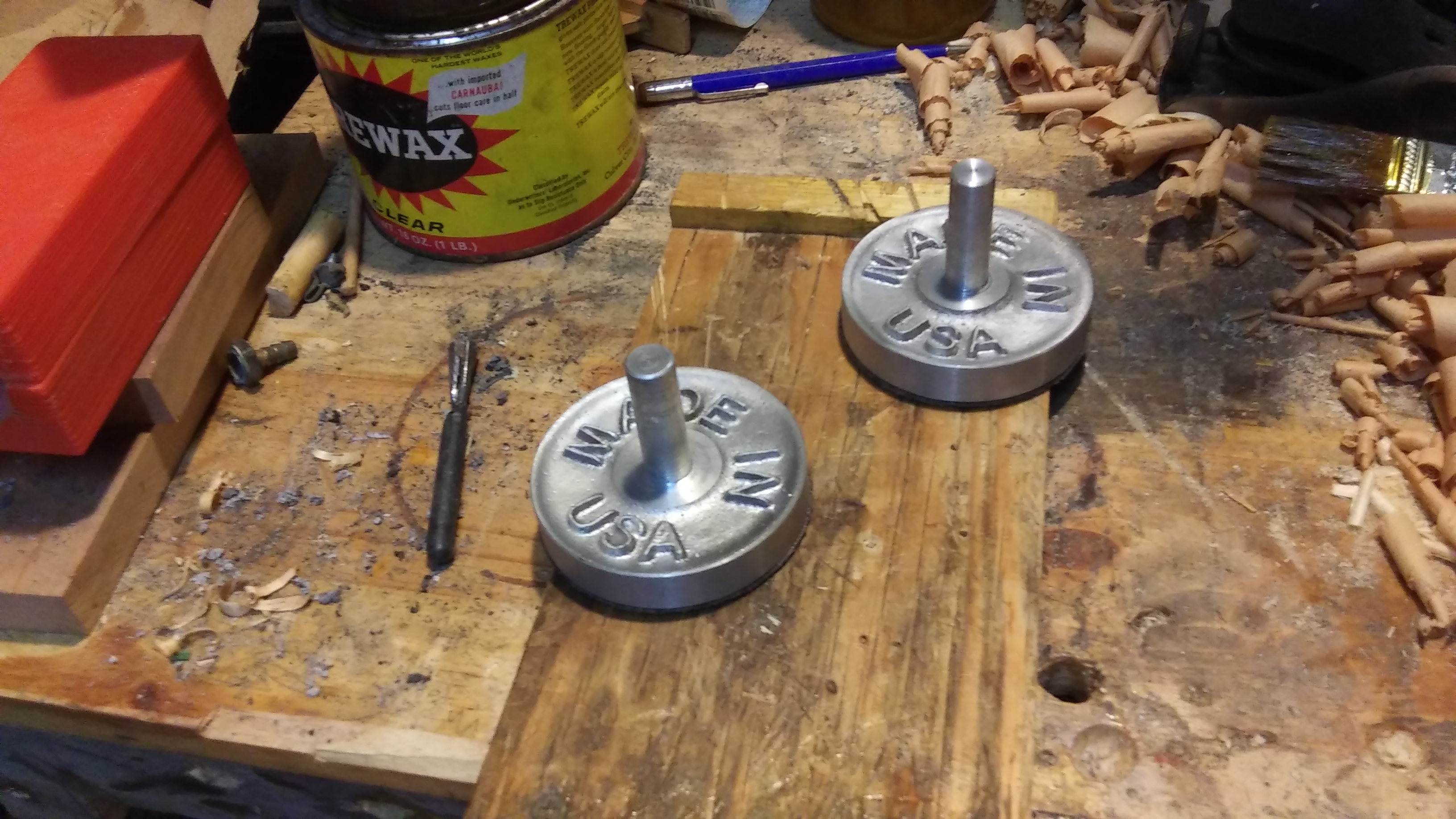

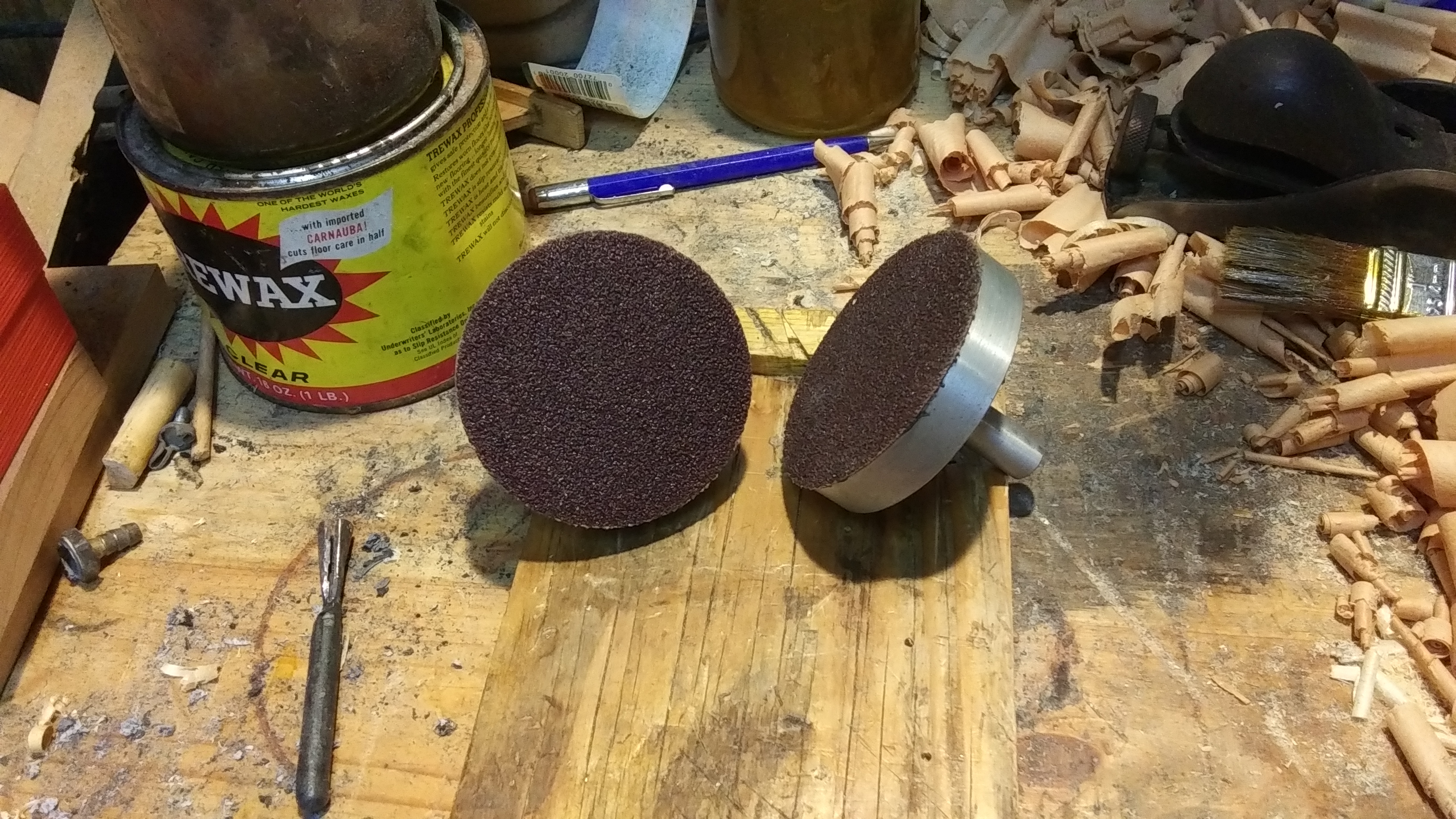

Finished the safety sanders, the one was a failure, so Im just giving it away to a friend. The A on the one filled in and I had multiple patterns in the same flask, and didnt feel like dumping it all back out just to fix that one pattern, so just decided I'd just remelt it, but took it to carving group and the one guy said he'd like to try it out and I just machined it up for him.
I think they turned out really nice, and the surface finish on them is really good. But they go in a drill press and get used similar to the old rotary planers or safe-t-planers that you used to see, but those leave a horrible finish and isnt good for shallow cuts, where as these are supposed to give a pretty good surface finish and excel at small depth of cuts. It's used mostly for flattening stock and getting it perfectly parallel for making patterns with.
another little bit straying from hand planes post, but it is still woodworking, lol.

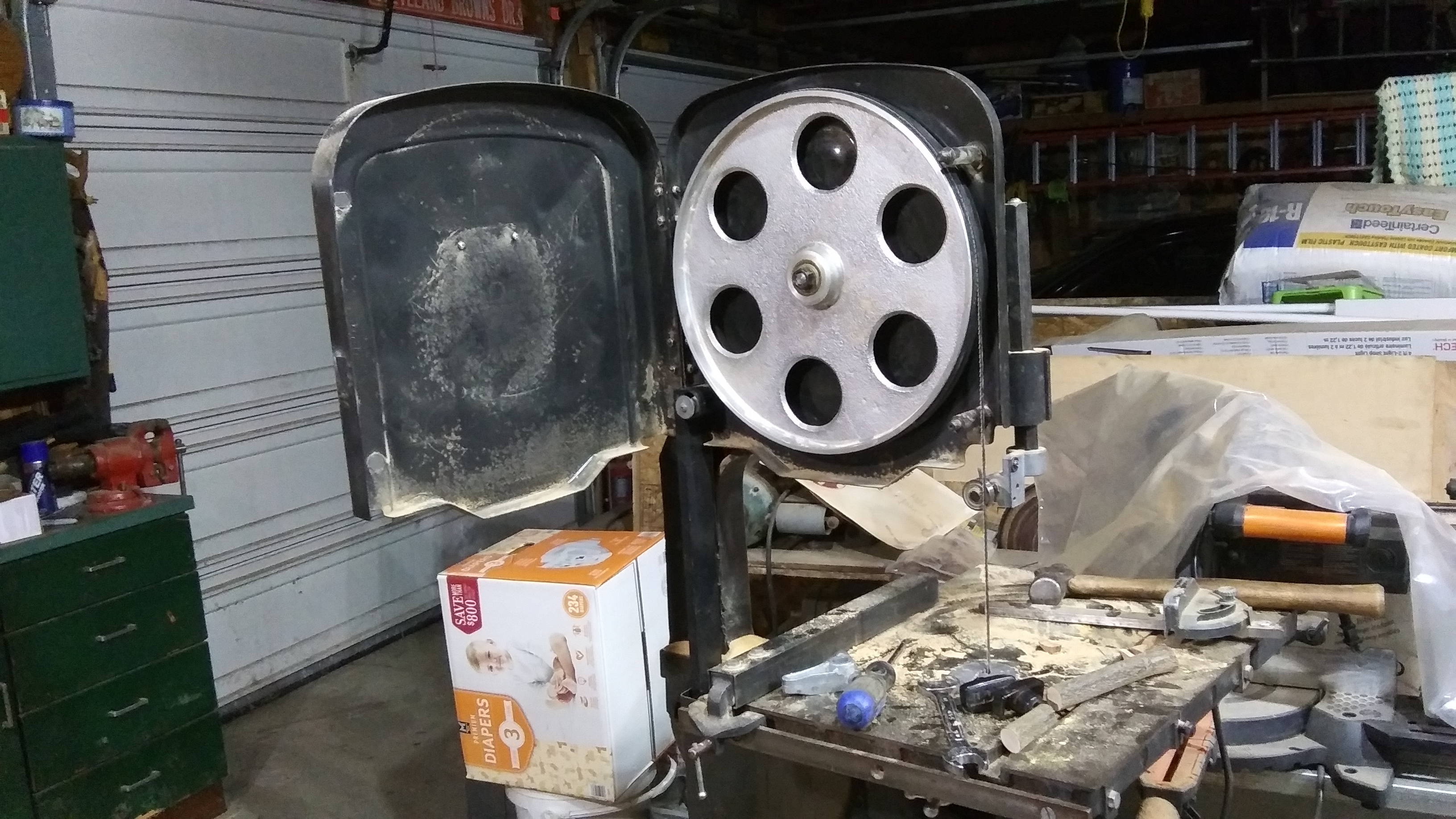

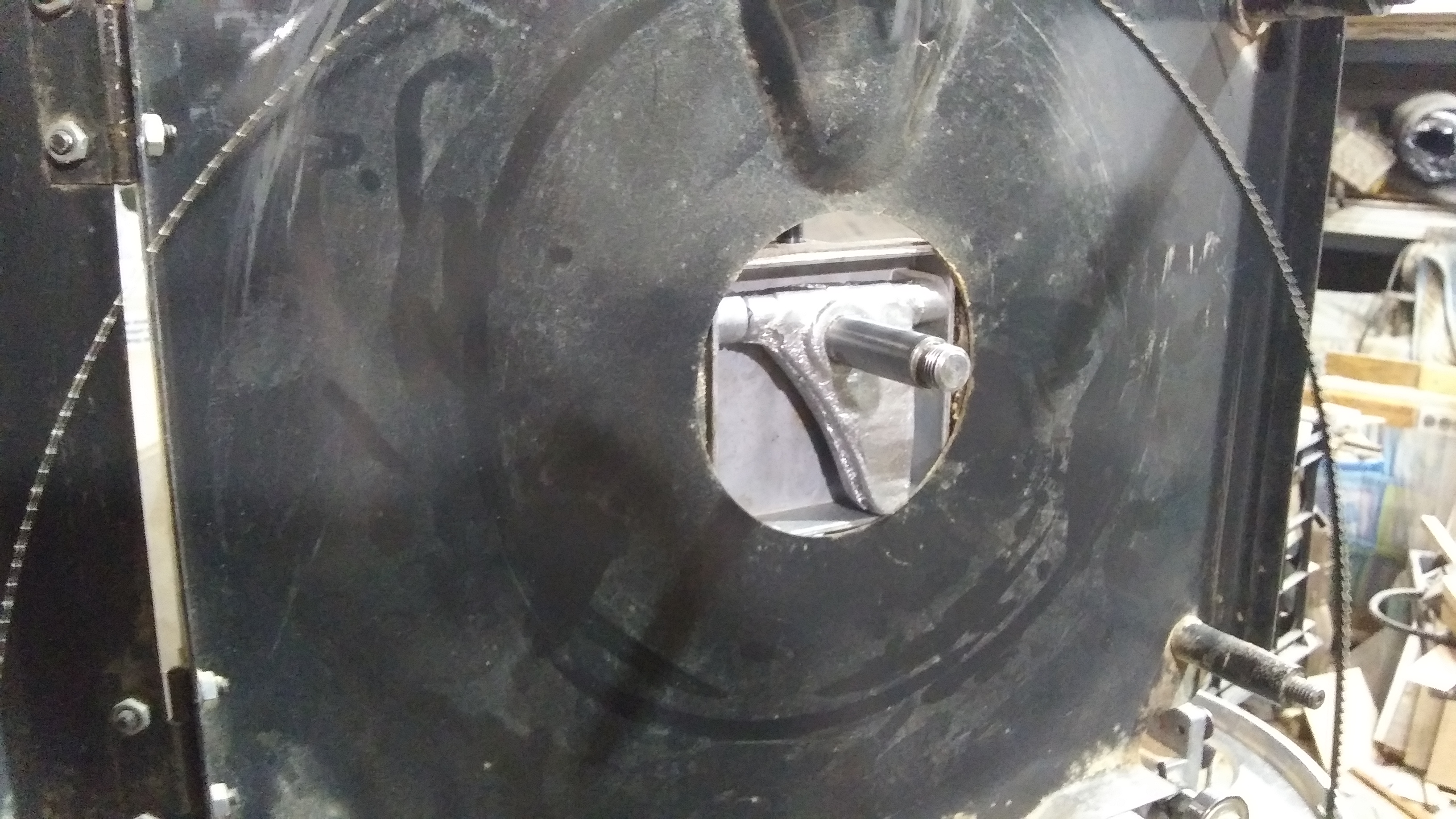

I machined up the new bracket casting for the bandsaw and got it all back together and working. The old one was really bad and I could really tell how bad it was when I got the new one installed. The tracking knob was almost maxed out before on travel, now it's just where it needs to be and everything runs so much smoother.
Now that that's fixed, I can work on patterns again, but I also do need to fix up the blade guides on it too, which were completely trashed when I got it. They were made from the same alloy, whatever pot metal they had used, and they just crumbled under finger pressure, so I think it was some zamak alloy, but probably had some lead contamination in it, which made it stupidly weak. On top of that, the castings were made extremely thin, so it was only a matter of time before it all just fell apart tbh.
All in all, it works pretty good now and I never have to worry about that part breaking on me again, lol.

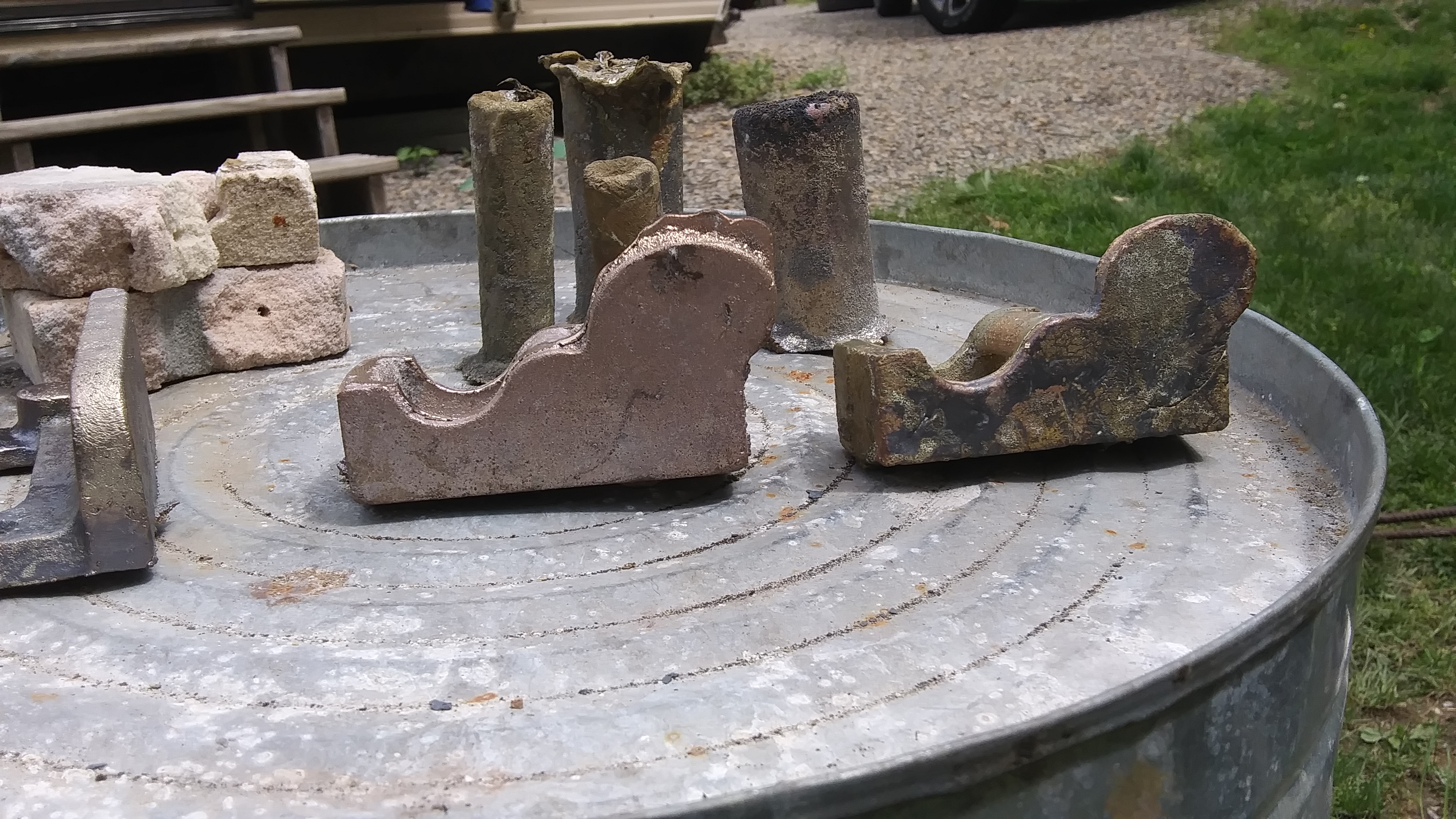

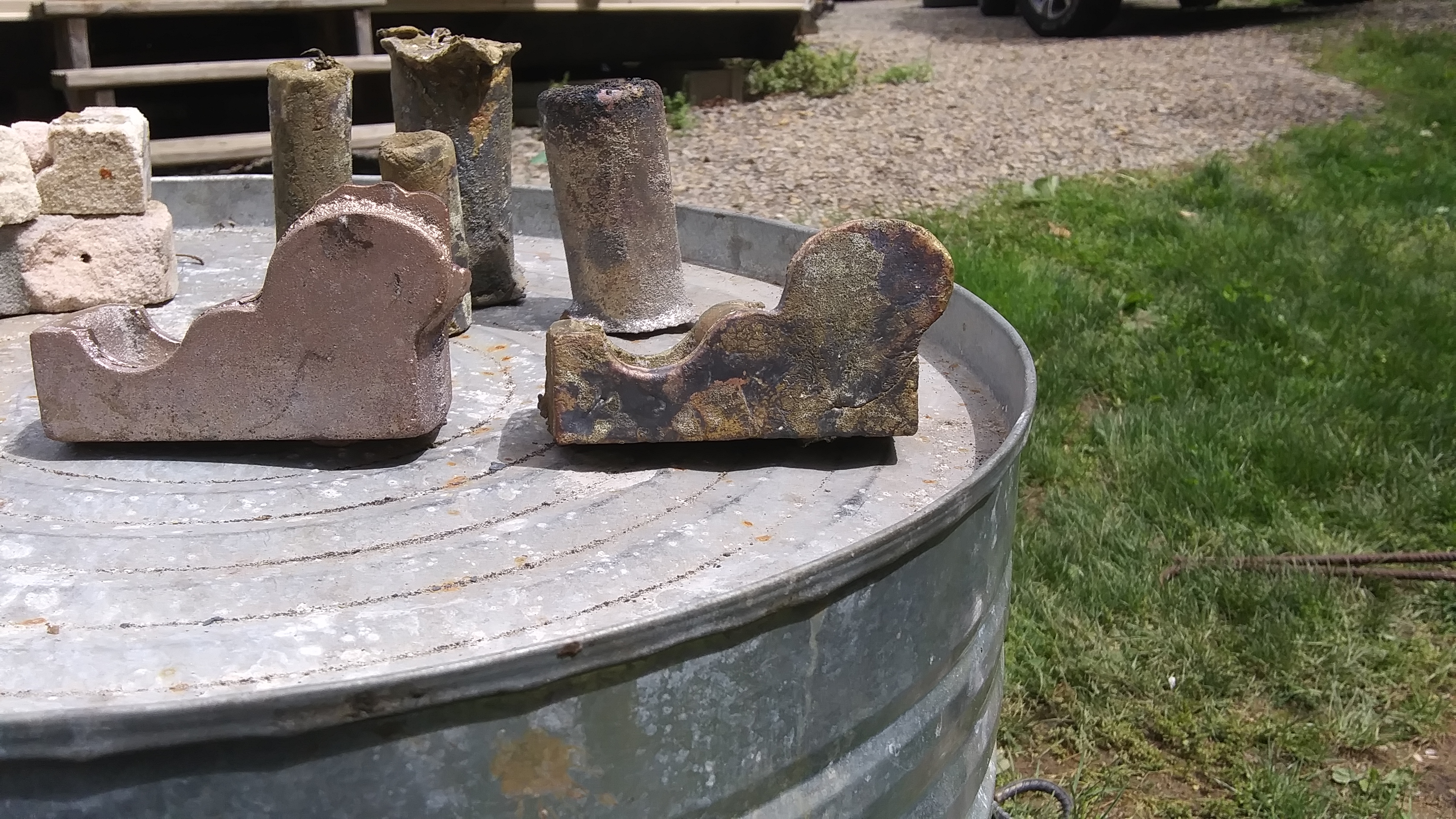

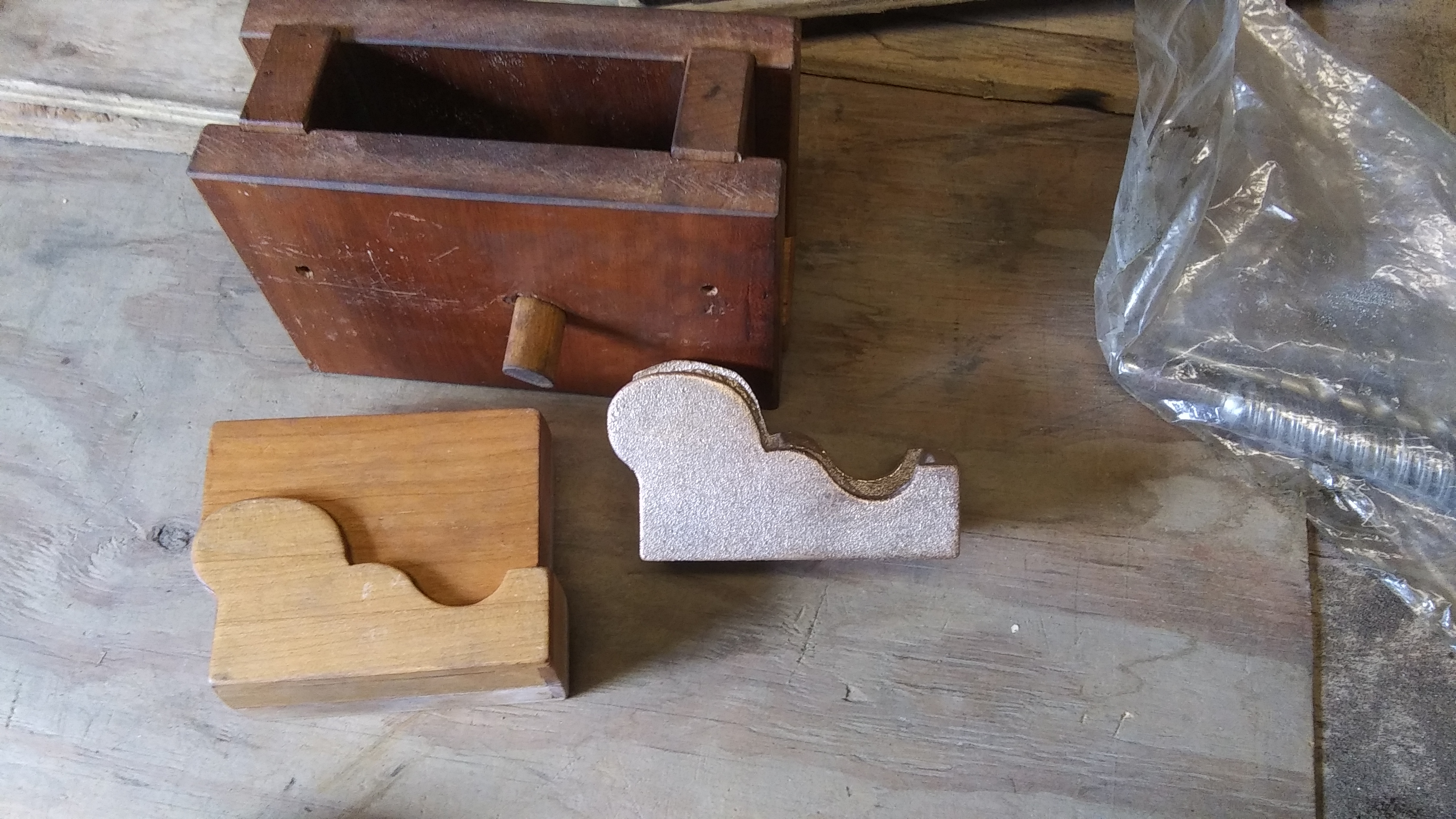

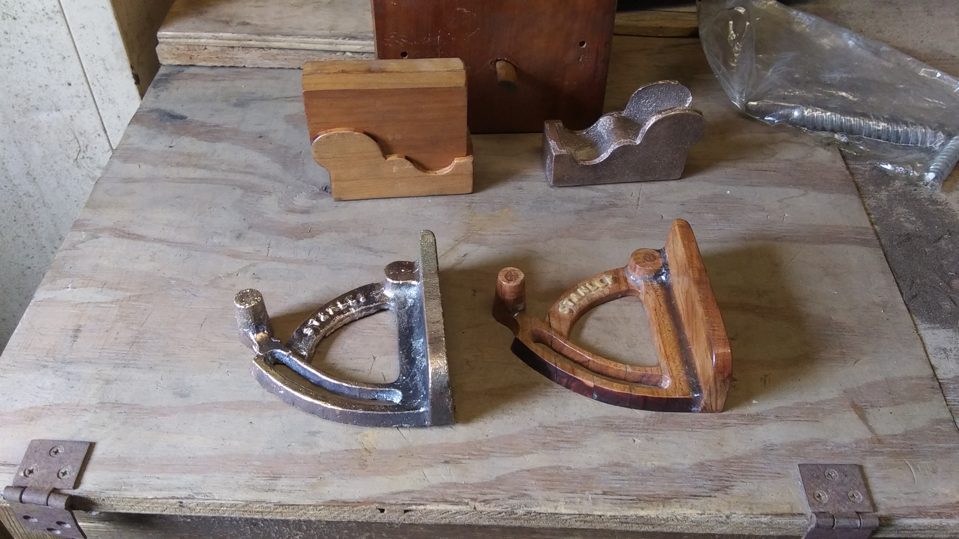

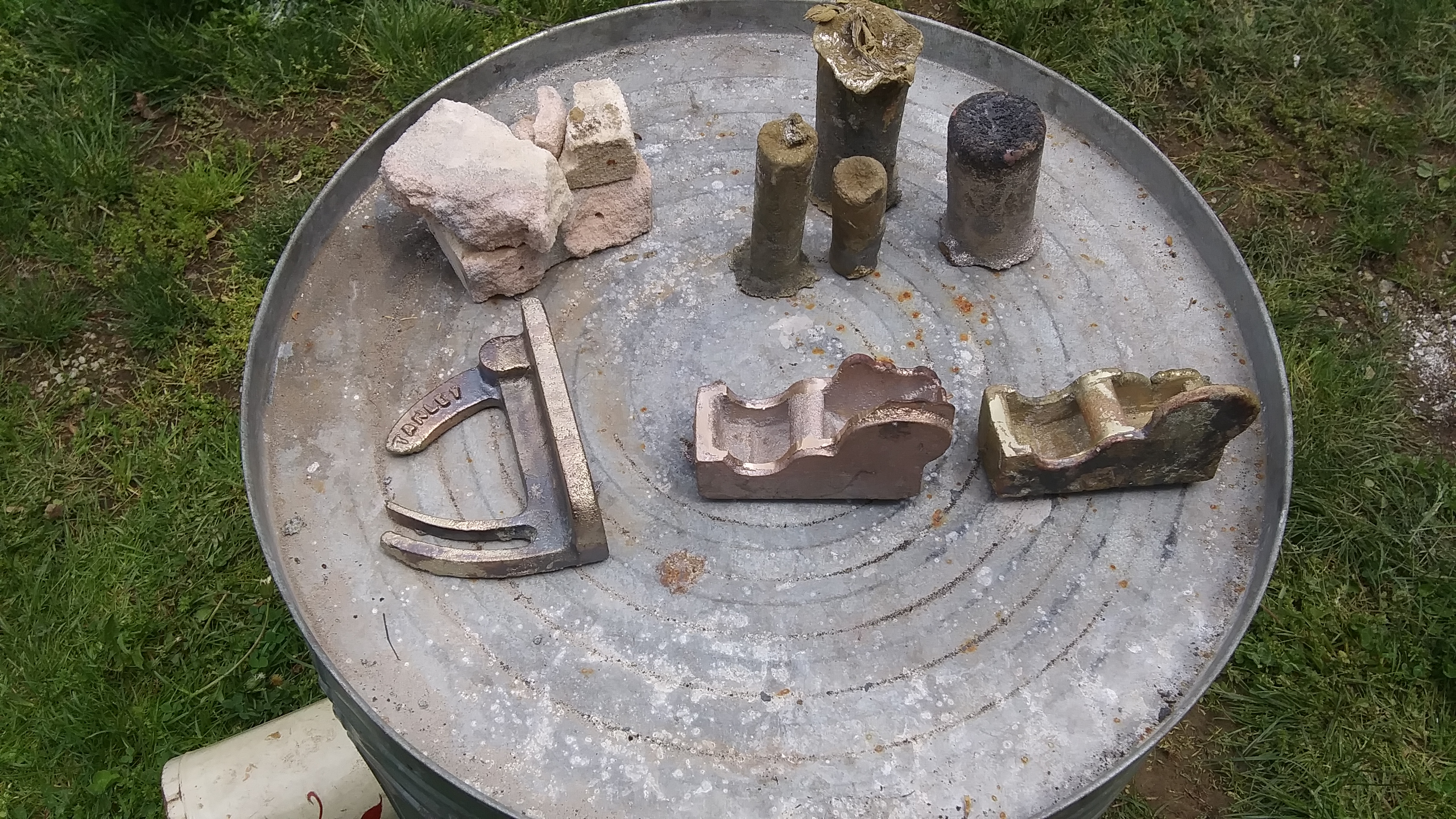

I did try to pour the chariot plane, which I was really surprised by because it was so tight of tollerances that everything lined up perfectly between the corebox/core and the pattern itself, lol. I say I did try to pour it because the brass was too cold and didnt want to flow into the details I tried pouring one in brass, and one in silicon bronze, and I think both were too cold tbh, but Ill just remelt them and try them again. I had far too large of risers on everything and it ate up more metal than I expected, so that didnt help either... I also tried pouring the fence for the shooting plane in brass from the same pour, and being too cold, it was a failure also.
All of the patterns pulled from the sand so easily that the pins come apart easily on the plane pattern, but the pattern kept falling out of the sand under it's own weight, which thankfully resulted in perfectly clean sand molds every time.

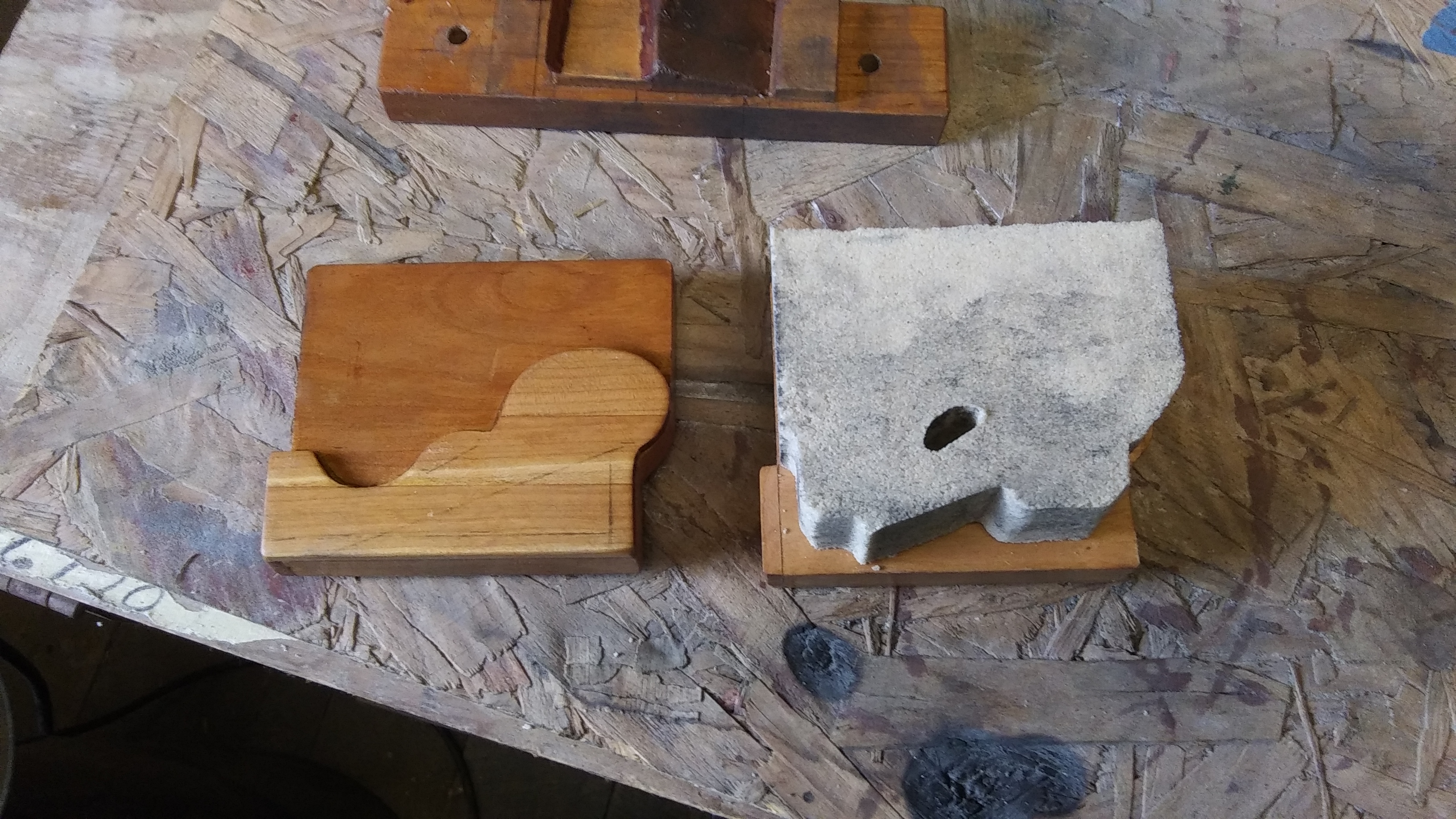

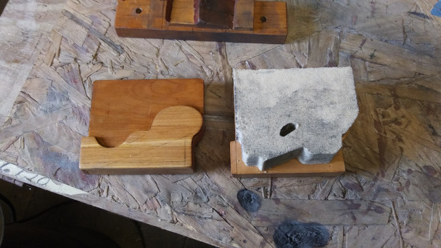

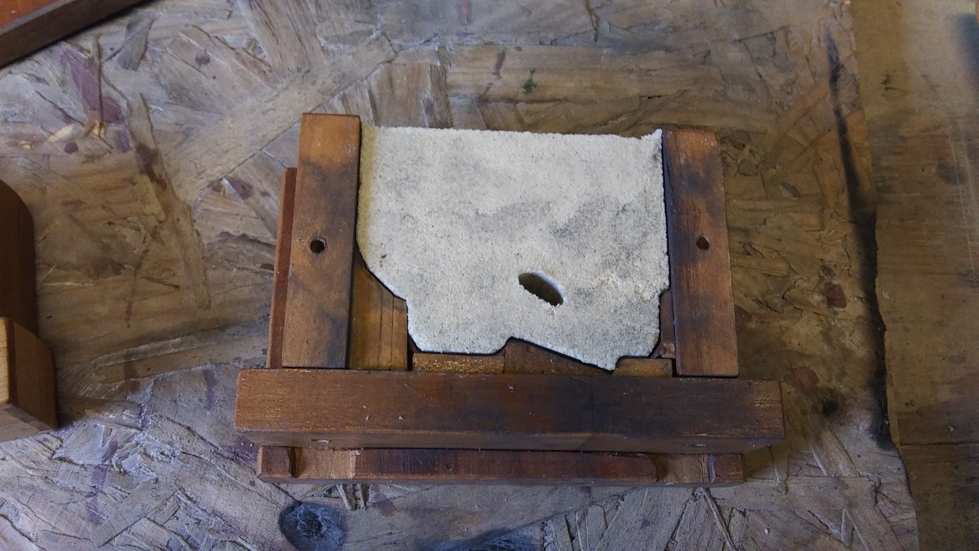

The corebox was interesting to ram up and gas, but after a few mins of redoing my co2 bottles and such, it made it far easier and those issues are solved. I also put a long cloth covered hose from an airbrush on it too, so I can pull the hose over and gas the cores without fighting with hoses and such anymore. Lots of little improvements, little by little, lol.
You can see across the plane that after cleaning up some of the flashing that flowed around the core, there was virtually no difference between the bridge pin, and the outside of the casting. The fence pattern had some alphabet pasta letters on it, just trying to see how they would pull from the sand, and they pulled perfectly fine.
I was hoping to redo those cores and pour them yesterday and today, but was out working in the shop on fixing something and my dad came over and said to lock everything up, there was an active shooter in the area and to just lock everything down. I locked the doors in the shop and kept hearing all of the helicopters flying over and such, which I dont think they found the guy still, but as soon as things clear up, Ill go back out and make up some more cores and such and get it all ready to try again.
Seeing how the areas on the castings had issues, I saw how I needed to gate it better and eliminate some of the issues, so hopefully I can get back out there and give it another try sometime soon. Even from the failed castings, I can tell that they're going to be very comfortable planes and will work perfectly for what I was needing.

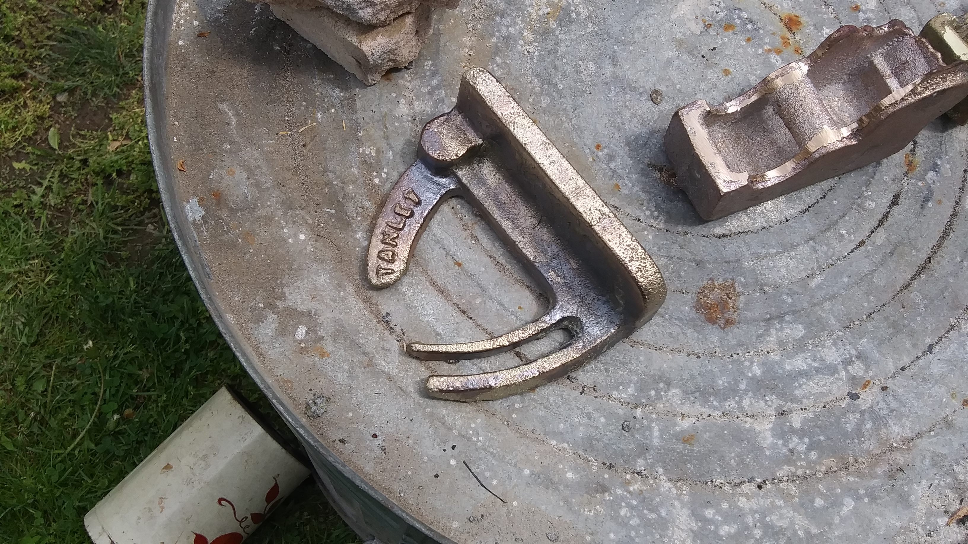

Well, I had another go at the planes and shooting fence, and finally got one, even tho the brass was being a bit more finicky this time I think. It was being poured after dark, so it was harder to judge the temps, even tho it seemed alot hotter, and actually did flow into the mold completely this time.
The bronze flowed in very nicely and resulted in a very nice casting, where as the brass was still fighting me and wanted to act like hot taffy again as usual. Ive always struggled with brass, and no matter what Ive tried, it just refuses to cooperate for me. I can do iron and pretty much any other alloy/metal out there, but brass just hates me I think, lol. Either way, the shooting plane fence will be machined up, then painted black with a few other castings recently, so any defects, I can just fill them in really before the paint tbh.
I wanted the chariot plane because it was such a challenge, and I needed a plane with smaller front toe on it, fits into your hand nicely, and had straight and parallel sides, without being too large. I was going to make a plane to do checkering, and this seemed like the plane that would fit all of the criteria that I was looking for. The challenge was that the plane cant pull from the sand normally because there's a pin that's cast into it and runs across the top of the plane, but because that is there, it wont pull from the sand normally, so it has to be done through a core. The pattern created the outside of the plane, and the corebox created all of the internals and inner workings, and everything had to match perfectly for it to work right.

You got it to fill out. that looks great.
Thanks. Ive been wanting this plane for a while and finally getting one is pretty cool, and really showed how far Ive come with the patternmaking stuff, lol.

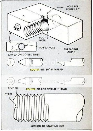

You could make some threading dies for wood dowels. They come in handy sometimes.
lol, funny you say that, I actually have one that I was working on yesterday, lol. I believe it says made in west germany, but is 3/4"-5 thread box and I have the tap to go with it. The problem is, I could never get the stupid thing to work right, lol. I tried sharpening it yesterday and it just refuses to work at all for me. The person who had it before me put a new cutter in it and it was sticking into the thread box so far that it was just tearing everything up, and it looked like they went at the bit with an angle grinder disk tbh. Ive thought about trying to make a new one, but not sure how much I would really use it tbh, lol. I thought about making an acme thread version of it, but for that much work, I thought about just making a router version tbh.
That one is for a drill press, but it would honestly be better for it to be for the router, the higher speeds would translate out to having smoother threads, and the bits would be pretty easy to make since they're really just D bits tbh. I was thinking of getting the 3/4"-5 acme done because thats what broom handle threads are, then when you break or wear out a broom handle and it will no longer stay in the hole, then I can just cut off the damaged part, thread a little more, and stick it back in the broom, lol.
