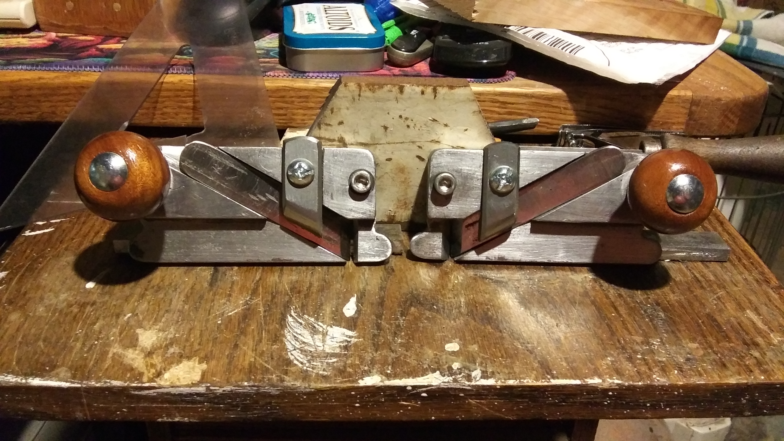

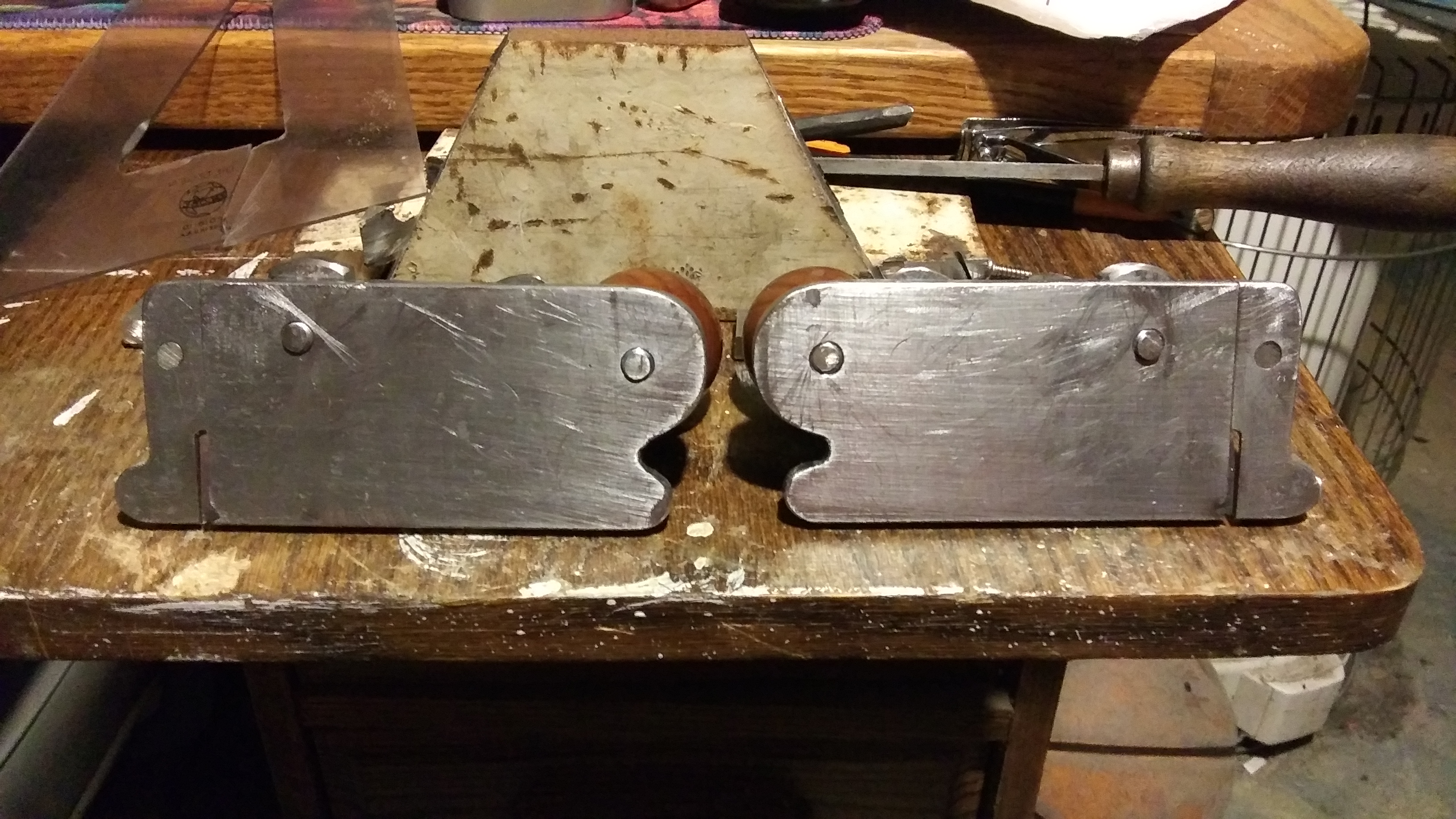

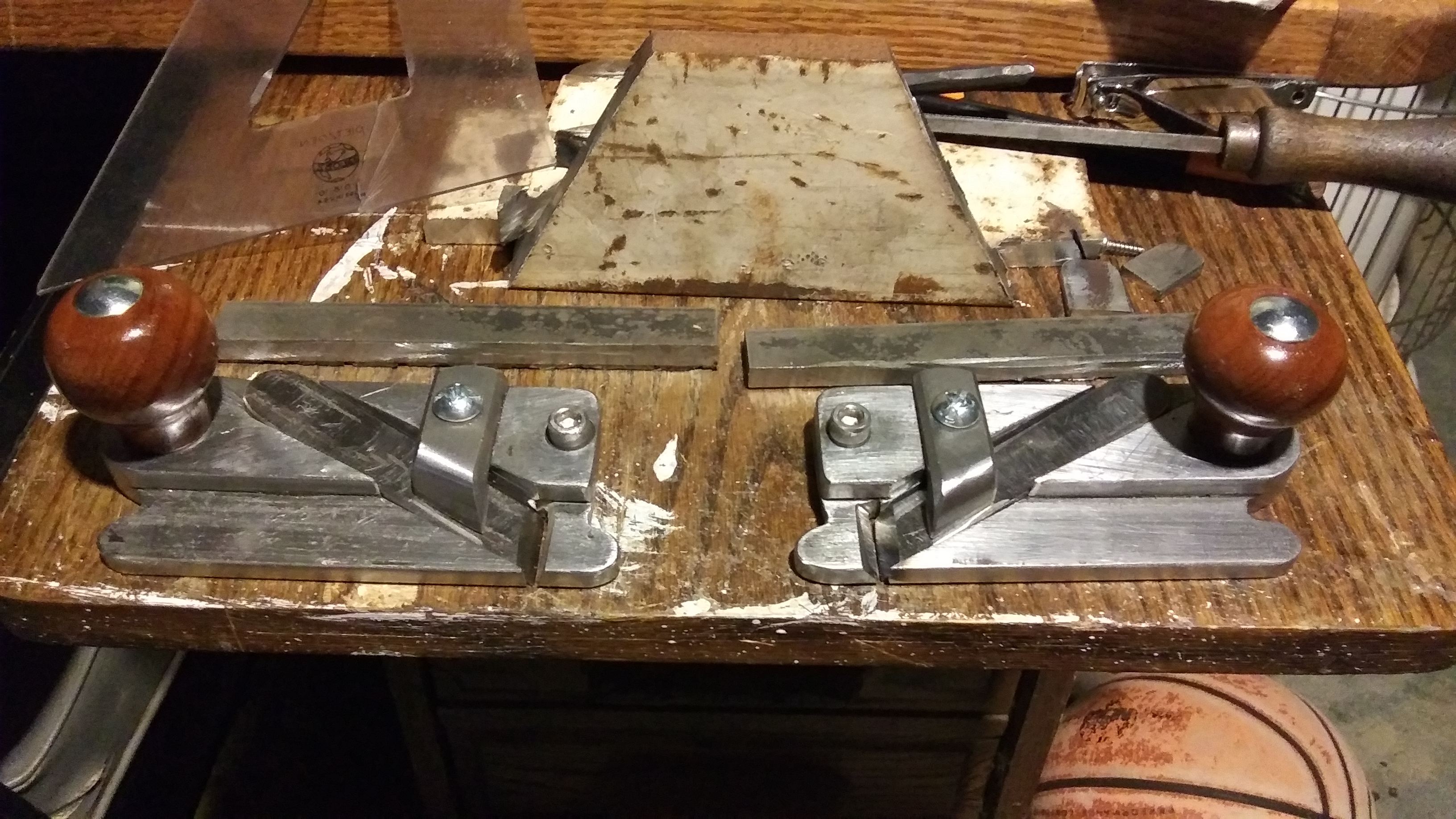

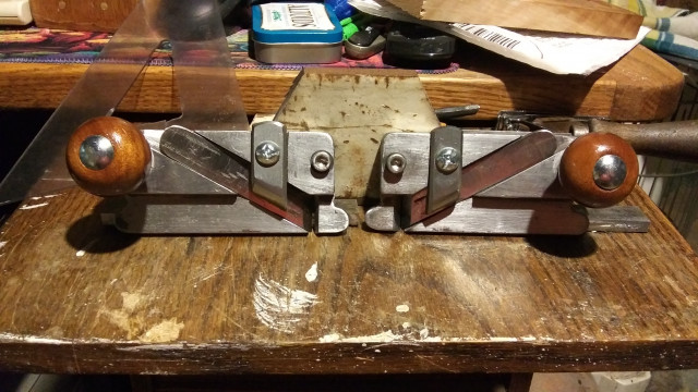

I did manage to get out to the shop today and finish grinding and machining the parts for the side planes done up using the shaper, all that's really left is to just do a little filing on the bed seats of the planes, but that wont take long, and need to heat treat the blades still.
So those are now in the toolbox and put away, only minor tune up stuff is left beyond heat treating the blades, but that's super easy to do really and Ill do it when I go out to forge a bunch of stuff out again. For now, those are all done.
Well, that's another one off the list and $200 saved, lol.

It's hard to say how long it really took to make the planes tbh.
I know the miter planes, it probably took 15 mins to bend them around the form and get them squared up and such since the forge was already hot, took maybe an hour at the mill to rough out the dovetails on both of them, 3-4 hours of filing to shape dovetails and such, 30 mins to peen the dovetails, then probably two or three of grinding and lapping. The wood probably took 5-6 hours to get everything just perfect with the planes, rasp and files (it was a snug press fit into the steel body, so they wont come back out), and a few days of adding shellac and sanding in between, then a coat of paste wax on everything. It took longer to pickle all of the steel in between the steps to give it an even texture, and also a few days of pickling just to remove the mill scale off of the steel and from the parts. So in all, it probably took a week to do up one of those planes even tho most of the time was from the pickling and finishing, and fine tuning the fit of everything just perfectly.
Without the finishing and pickling, I'd say probably in all with all of the metal work, cutting everything up, etc, it probably took 15-18 hours, but as I was just doing it as a winter project and only doing it for a few mins here and there when it got warm enough out to piddle with it, it took around a month to do.
The shoulder planes, they went pretty fast and most of it was grinding to shape and such, which I did in 3-4 hours, laying out and doodling up the plans took maybe an hour or two, probably 30 mins of cutting everything up on the power hacksaw, then probably 2-3 hours doing up the fixturing and such on the mill to cut the slots for everything, 2-3 hours of file work to get the blade pockets just right, then clamping finger probably took 3-4 hours between the grinding and work on the shaper to clean them up and get them to shape. It took maybe an hour at most to do the knobs, and that was about it really, the blades were already roughed out because of being extras I made for the plow plane I was working on, and needed maybe 15 mins of grinding to get them ready to the point they're ready for heat treat. Heat treatment will take maybe 5 mins to harden, then 30 mins in the toaster oven to temper, lol.
Over all, they probably took the same amount of time to do both of the planes as it did to do the one miter plane tbh. I think it took longer than it needed to because I kept getting side tracked and would piddle here and there and go look up those other carving planes/spoon planes, lol.
That little throw around plane, the trim plane, I'd say I did all of the grinding on that one in maybe an hour or two and infill took maybe 2 or 3 hours to do since it was alot of fiddly work to get everything just right and be a press fit together.
Chisels took maybe an hour to do up, they go pretty quickly, then the handles, since I was batching them out, I can usually knock one of those out in 10-15 mins, with a few days of shellac and sanding.
It really didnt take that long to do, and they're pretty easy to do once you get the idea in your head, but it just takes alot of grinding, filing, and alot of running back and forth between the garage, shed, shop, and workbench in the basement, lol. Imo, the most time was just with pickling, filing, and grinding on the stuff, and waiting on shellac to dry completely in between the layers, which happens pretty quickly, but first coat, I usually just leave drying overnight.
