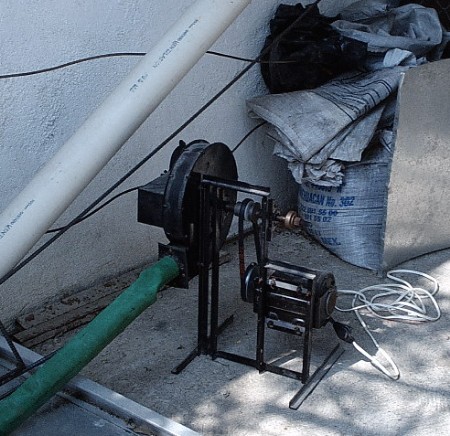

I am looking for a bigger blower for my large #30 furnace running a Lionel Brute. The 5 gallon shop vac I am using is not quite enough. I built a blower years ago from Gingery plans but it is not quite enough either.

you can speed up the gingery blower, but I'm not going to say how much as I don't know how it was put together and fans when they come apart are not fun to be around. you could make one with wider blades which would give you more air,
Chastain has the numbers if you want I can scan those pages out of his furnace build book and post them for you.
