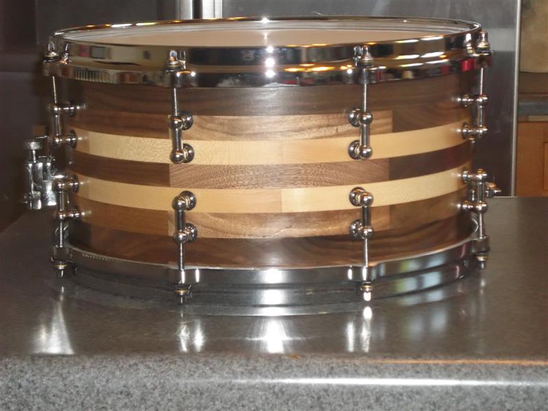

I've made a couple drums out of walnut....

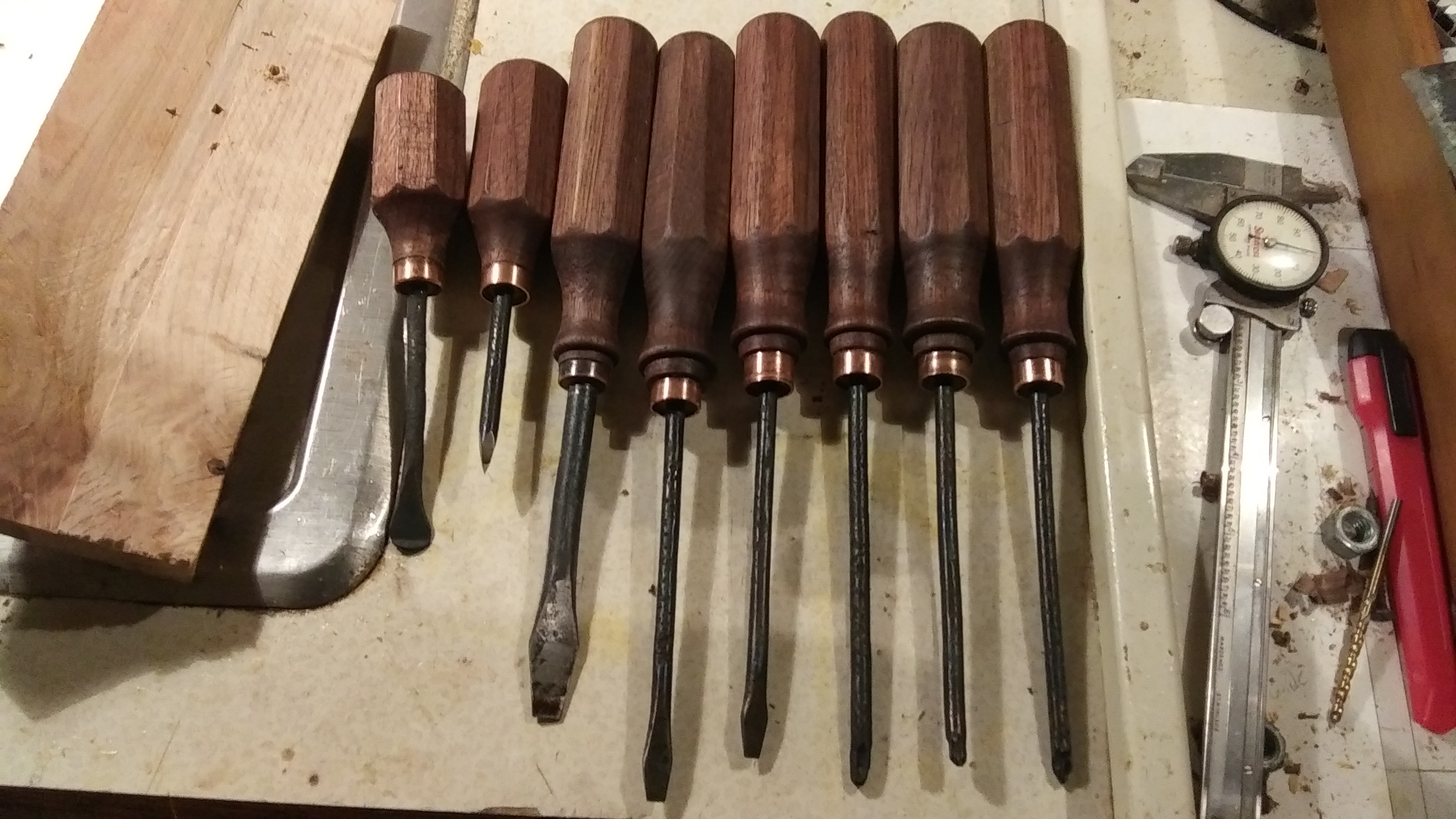

Only thing Ive used for walnut for that it worked good was just some handles for my screwdrivers that I forged out. I got tired of the cheap screwdrivers always twisting off/bending when I went to use them, so forged some out of some coil spring from a garge door spring, then heat treated them to a bronze color at the tips, and blue temper (spring temper) for the shanks.
The one on the far left is what the flat tips looked like before grinding to shape, made a bird cage awl that I use quite a bit for reaming out holes to 6mm for dowel pins for the patterns (I order cheap 6mm wood dowels from amazon usually), and rest are flat tipped, a square bit blank, and some rough forged phillips head bits.
Ive had trouble with carpel tunnel for years, and have been trying to work my way around them, and since most of the screwdrivers have a rounded back that presses right on that area in the hand, I got tired of them hurting my hand, and the fact that the ones I had kept twisting off trying to get screws out of stuff, so I just went out one day and forged those out. They're octagon shape, a little larger than normal ones since I have big hands and I can get a better grip on them, flat in the backs like the really old ones are and dont really press in that area on your hand, and just all around alot more comfortable to use for me. They're cross drilled through the shank and handle under the ferrule, then after they're epoxied in and pinned in place, the copper ferrules were pressed on over top to lock everything solidly in place so it'll never come back out, and hides the pin and everything.
Other than that, I really havnt found too much that the stuff is really all that useful for, it just moves too much, or is too soft for most of what I do, and I rarely care if something looks pretty or not, lol. The handles for the screwdrivers were just a random block of firewood that I pulled from the burning barrel and had left to sit over winter to dry out.
