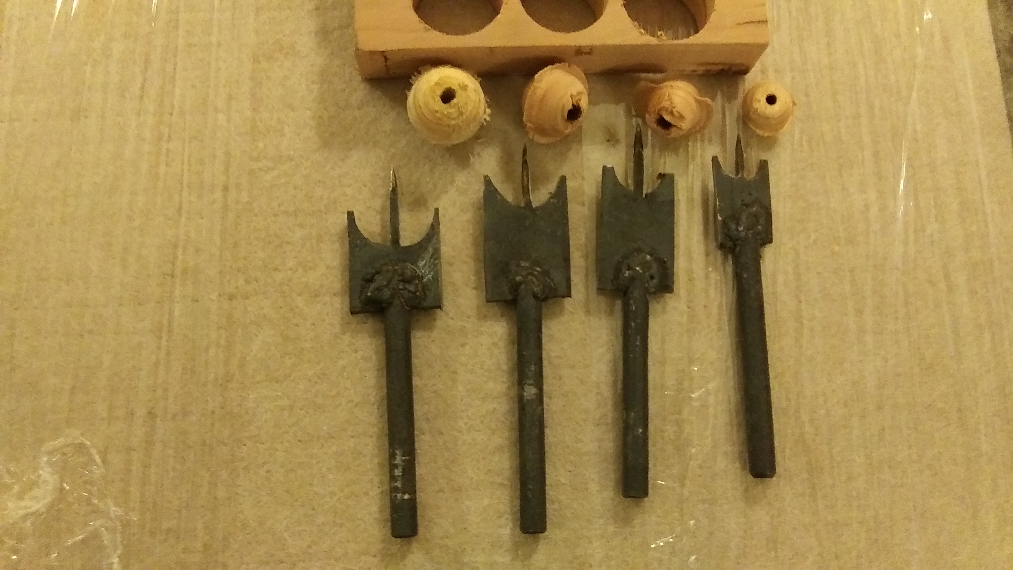

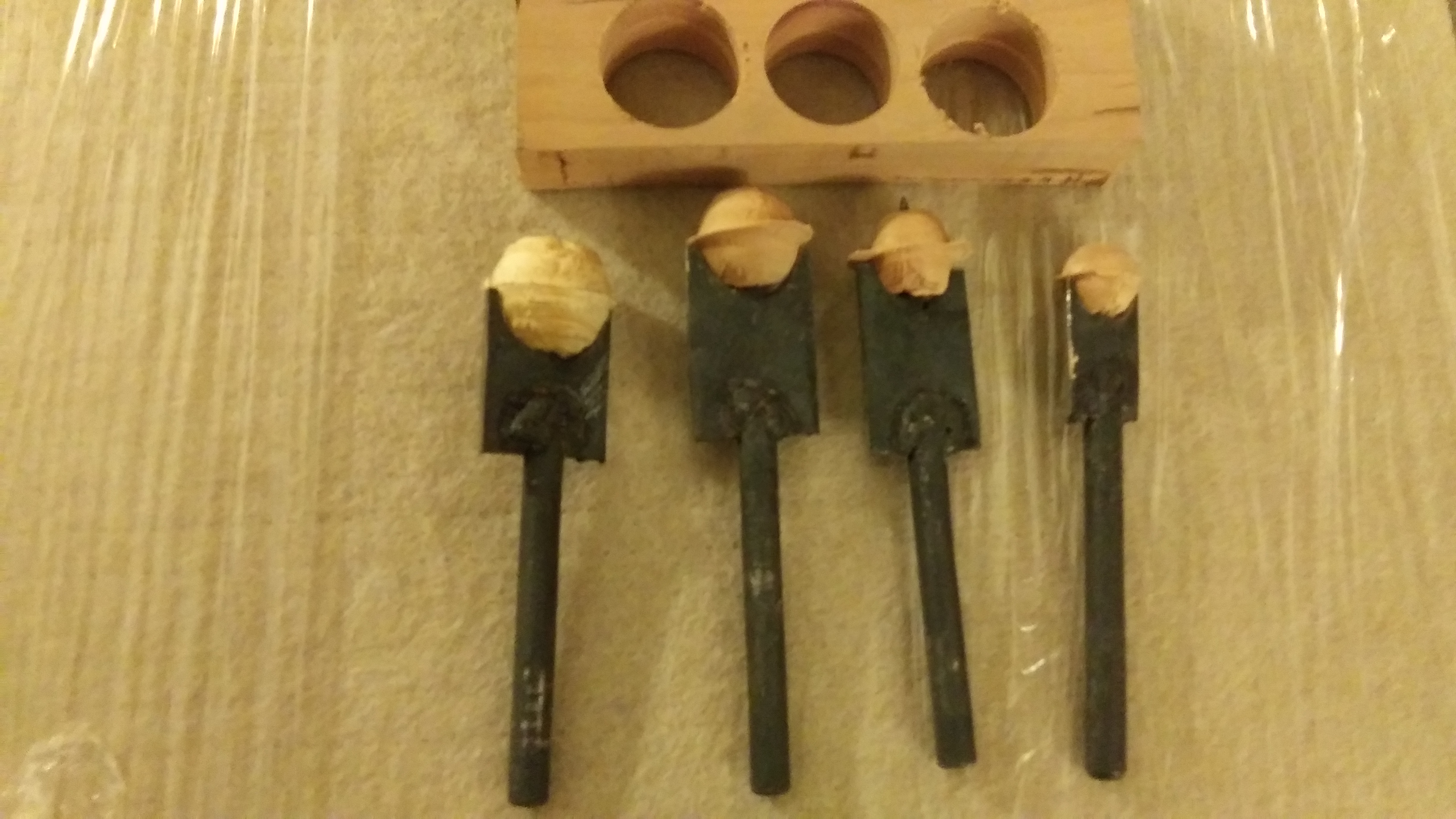

Here's the ball/bead cutters, just finished everything up and they just need the very points adjusted still, but they're pretty much ready to go, just need to take them out and heat treat them and sharpen them now. As I said above, they make a 1", 3/4", 5/8", and 1/2" balls/beads, which are the sizes you need for ball handles on lathes and other pieces of machinery.
I do want to do some fine details on them before heat treating, but thats easy enough to do. (breaking sharp back corners and such)
I figured these bits would give someone an idea that's looking at idea on how to do holes with draft much easier or do various profiles of spade bits.

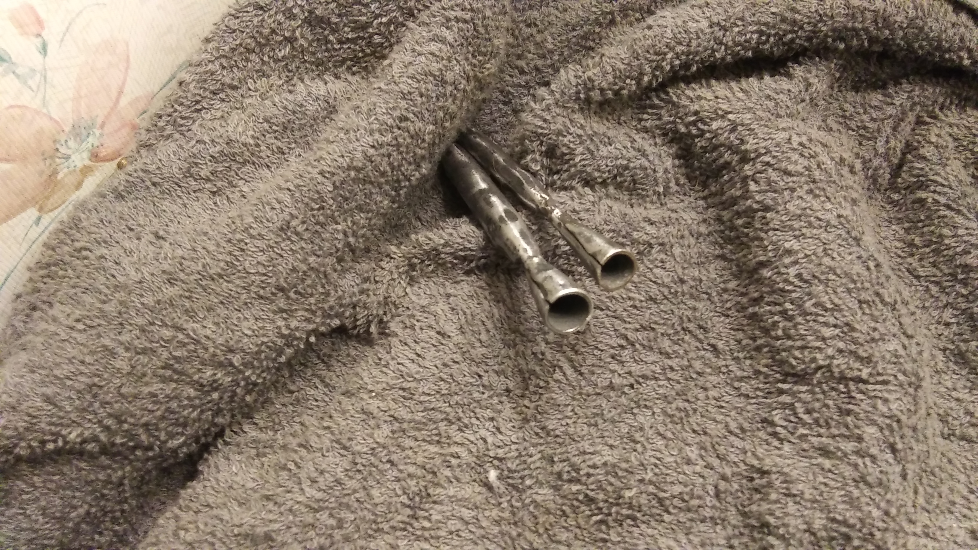

Here's the alignment pin/dowel trimmer bits that I had forged out before, but Im making virtually the same thing again to see if I can get it right this time, lol. The neck on the one was way too thin and ended up snapping off when I tried truing it up, and the other, I had messed up when grinding the cutting edge in, but they were a good learning experience anyways, lol.
I know they're not spade/paddle bits, but they're for patternmaking and should make things alot faster and easier than sitting there with a whittling knife trying to shape them by hand after they're in the pattern.

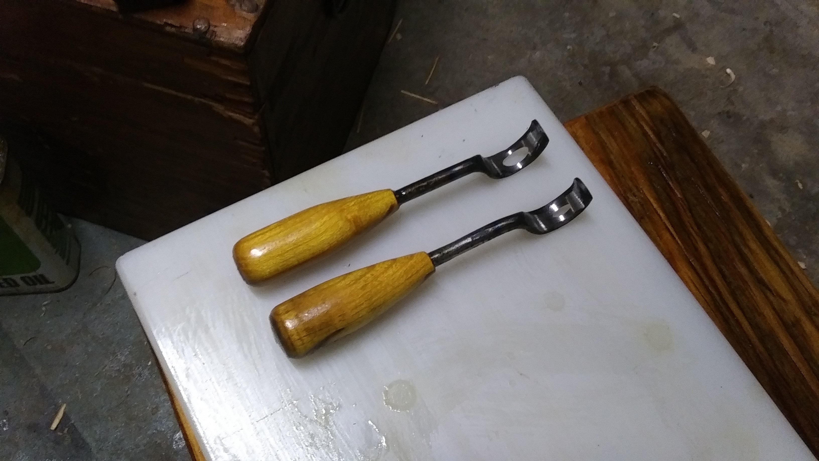

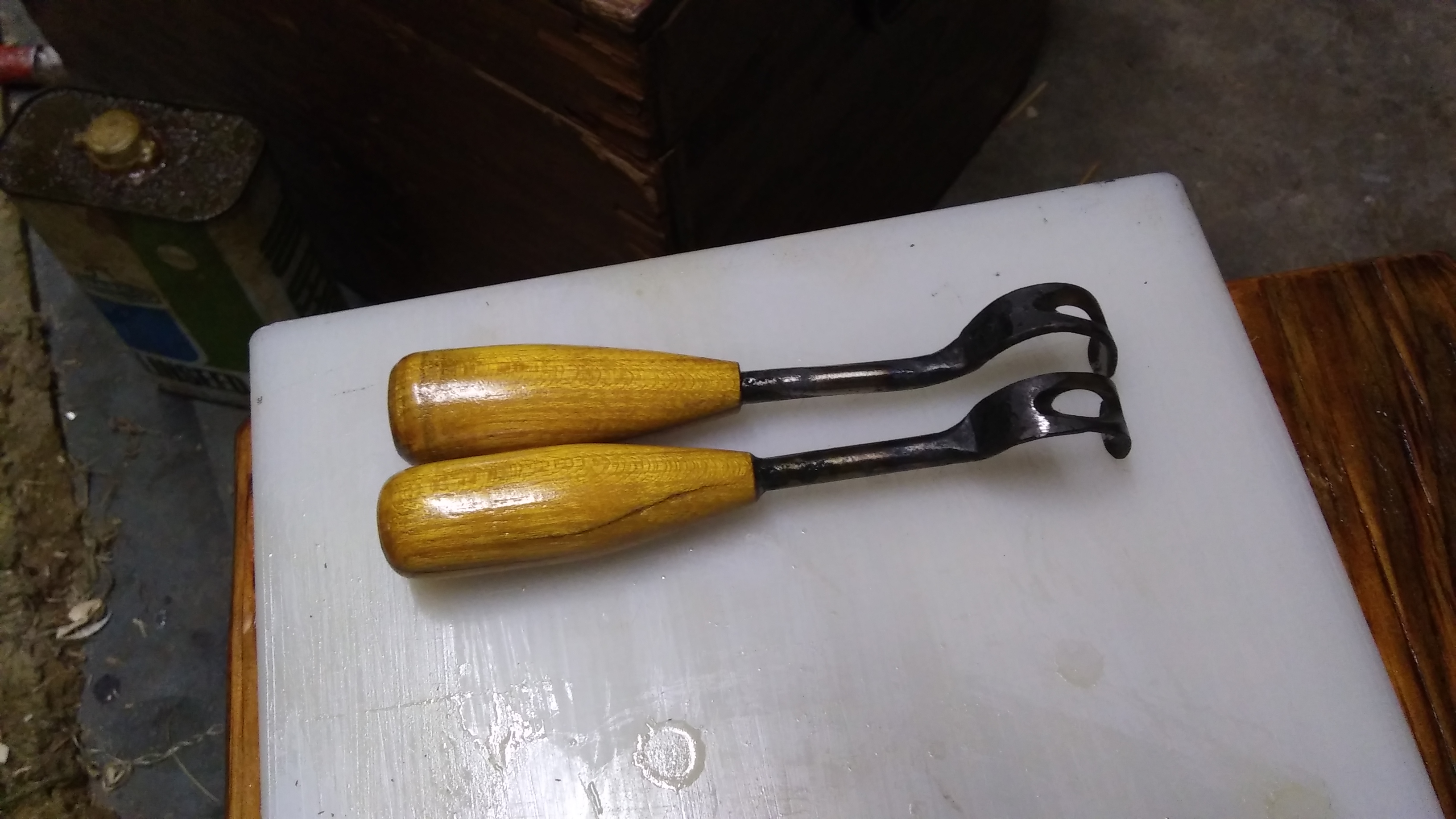

I believe I had made those bits, and these at the same time, which these are little roundover cutters, but they act like a little round bottom plane, so they can do flat or curved corners. You just run them along the corner of a pattern and it leaves a nice smooth round over that reduces the chances of chilled corners happening in iron castings, and it just feels good in the hands also. I use them all the time on my planes and other tools because it's a very quick and easy way to do roundovers on the edges of stuff. If you look at the little hand plane for cutting the groove at the bottom of vise jaws and on the molding planes/round bottom planes, you'll see that the edges were all rounded over using the smaller one.
The sizes are 1/8" roundover, and other is 3/16" radius for really large castings. They were made from the same garage door coil spring that alot of my other stuff is made from, and the handles were just turned from hedge apple/osage orange.
