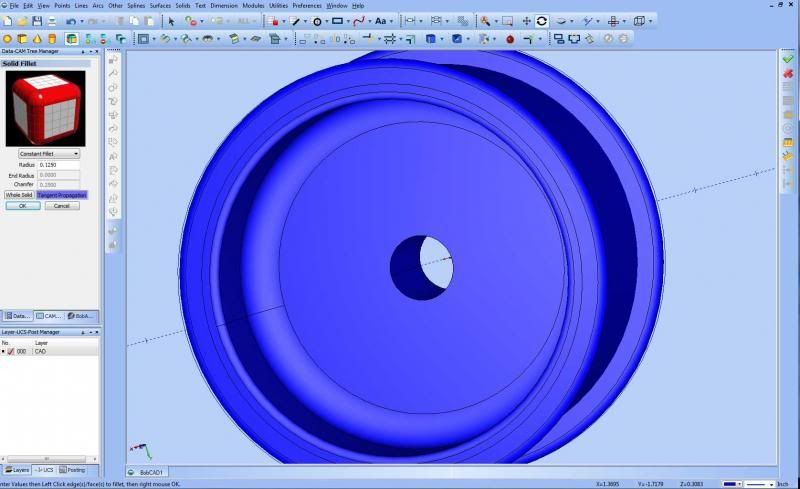

this is hopefully what I want for putting on the tranny, by making it about half an inch wider then the original one I can make up for the offset in the alignment. and with flanges on it I shouldn't need to put any crown on it.

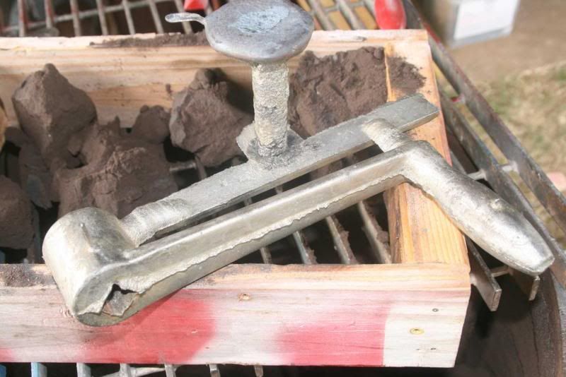

well the old guy left me alone today and I finally beat the ghost of handcranks past butt and got one casted in Cast Iron today, its not perfect, a little bit of eroding of the sand where the metal flowed in to the cavity at, and the core slagged some but it can out just left a skin in the hole that will wear out over time, it fits the shafts which is what matters.
here's a shot right out of the sand

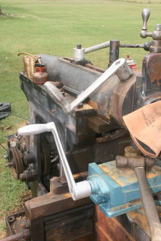

and one with it cleaned up a bit hanging on the shaper. the one on the vise is the aluminum one I did here a couple of days ago.

dallen wrote:this is hopefully what I want for putting on the tranny, by making it about half an inch wider then the original one I can make up for the offset in the alignment. and with flanges on it I shouldn't need to put any crown on it.
How are you going to make the pattern? Are you going to cut out the flanges on the lathe or cast it close to correct size?
