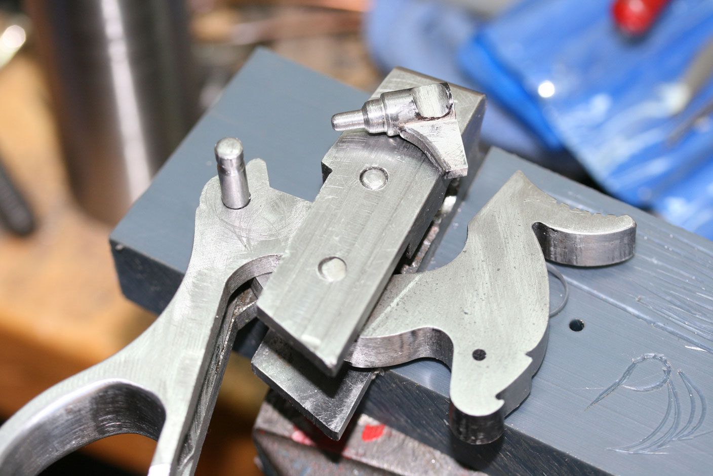

still plugging away on the 1885 little parts but takes a while to get them to fit together right

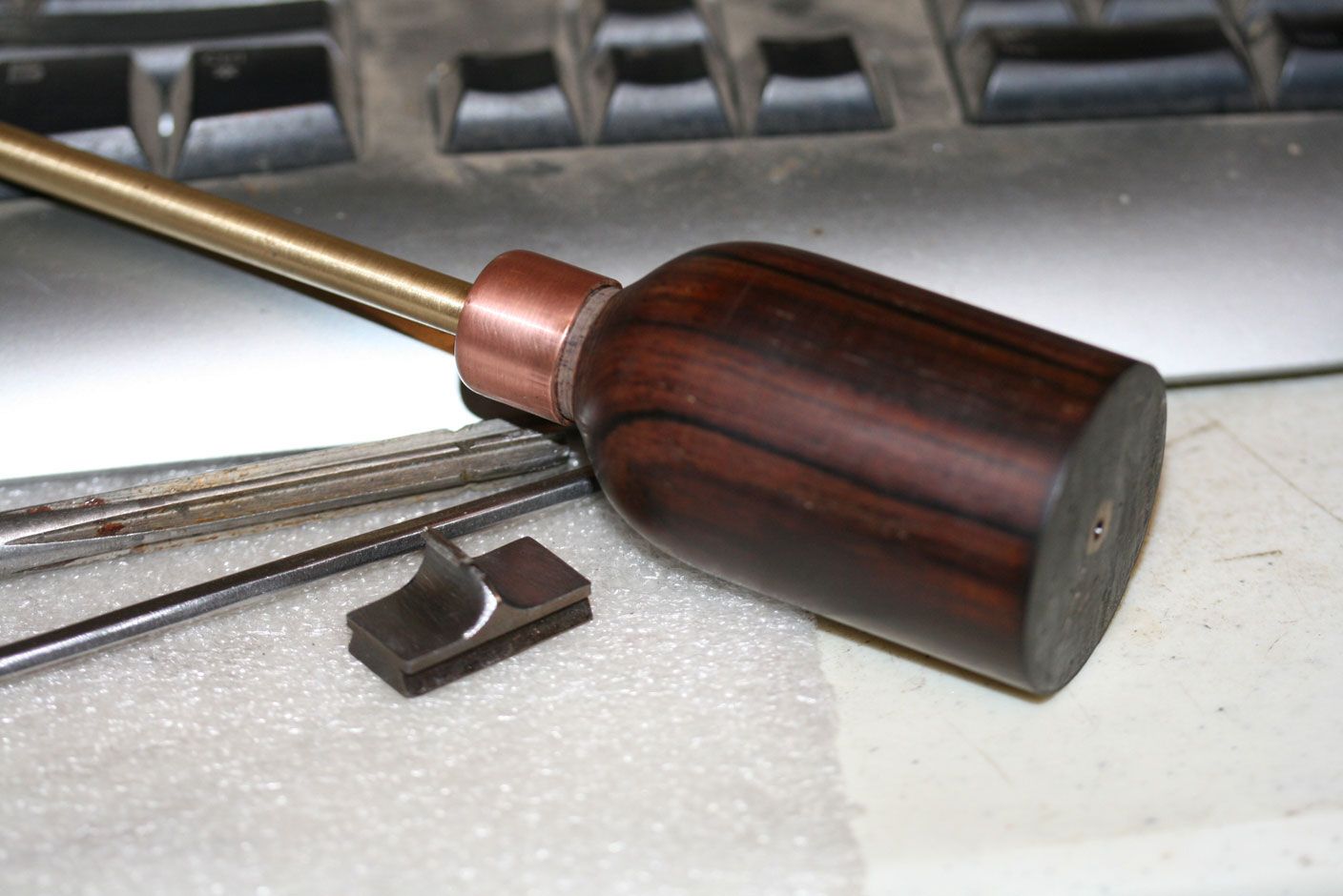

P.S. made this today (it's not finished) its for another project that I have going on.
Luckily we don't have gophers here, the only real animal that I have real issues with is cats, and dogs owners that let their dogs bark day and night....Nice looking project Dave ;)

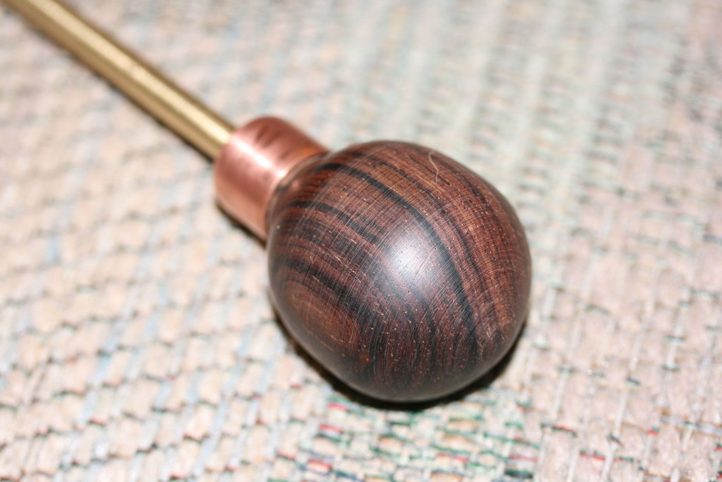

needs some more sanding but its pretty much finished

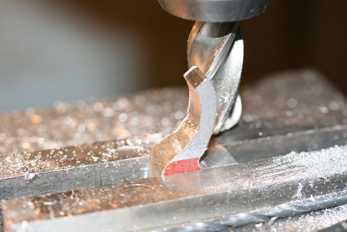

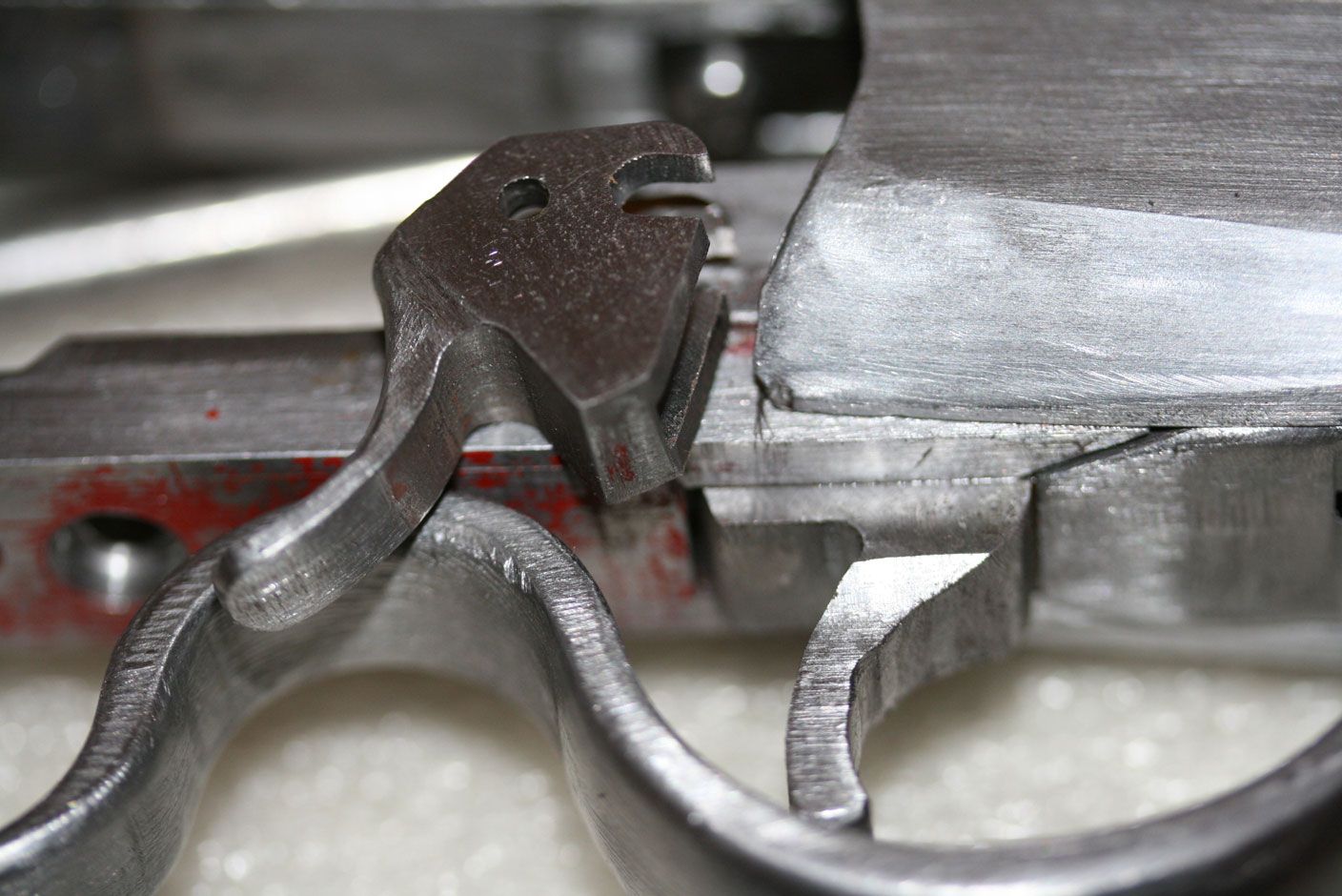

worked on the trigger group off and on most of the day, decided that I didn't like the amount of creep in the trigger so I had to make a new one.
first shot is of it in the mill with me trimming the sides of the trigger down some.
Second shot shows the new trigger in the receiver along with the one I messed up by making the slot too wide which caused a lot of unnecessary movement in the trigger, you can see the trigger with the too wide slot laying on top of the receiver, the new one still needs a bunch of work with a file.
